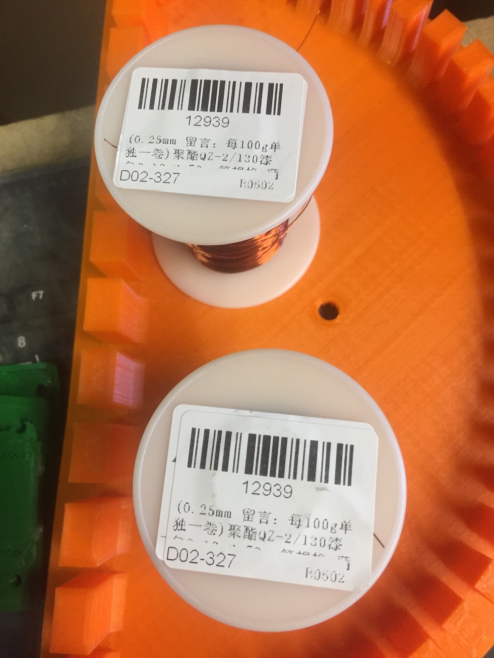

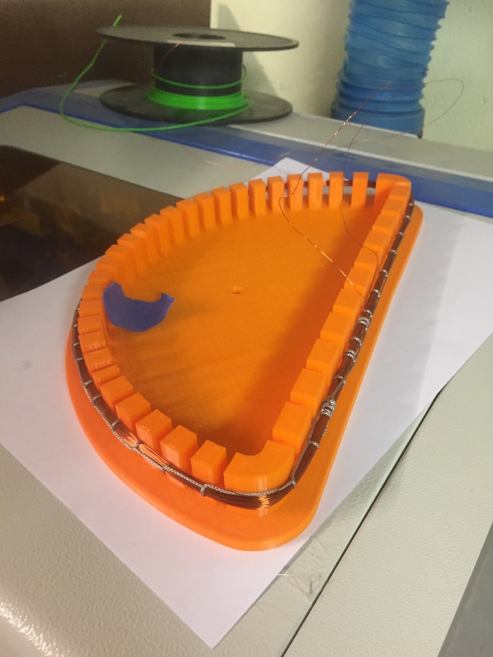

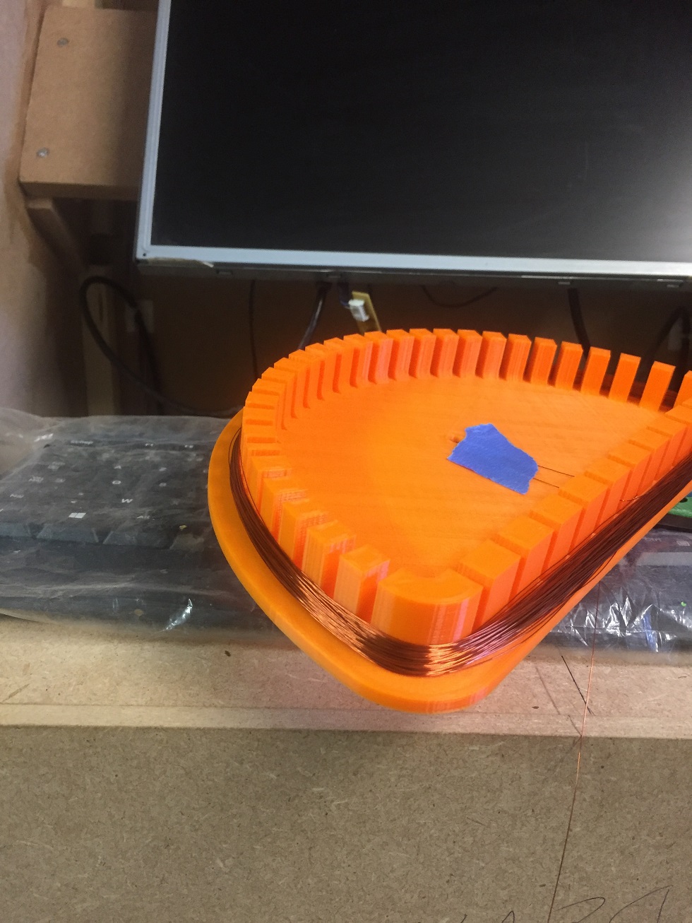

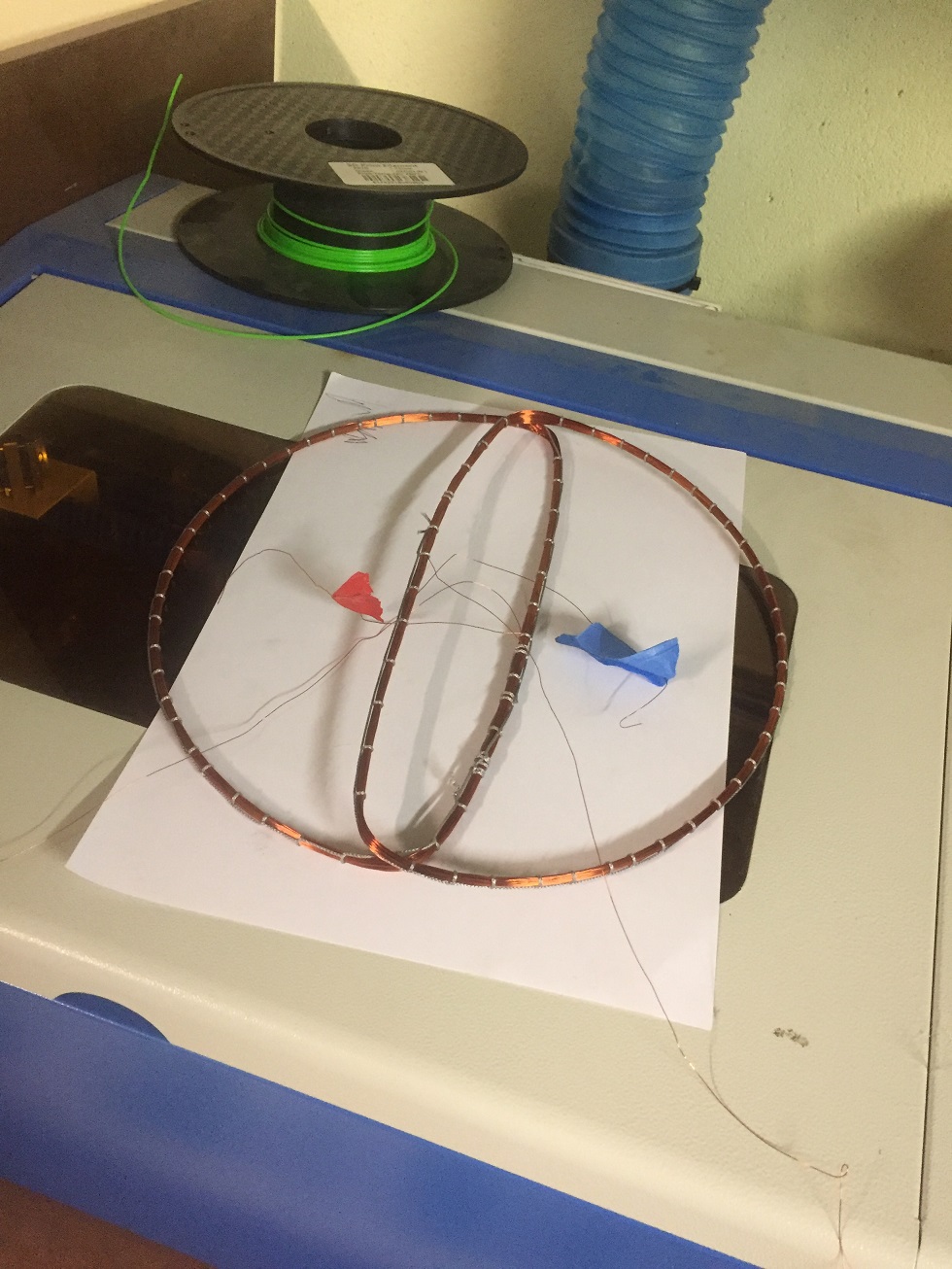

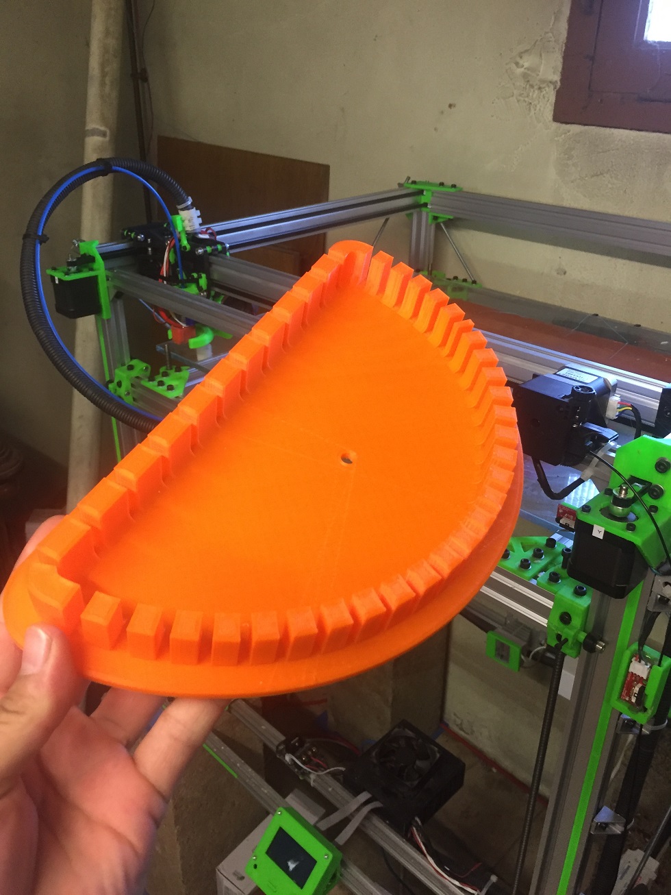

    I started to build my tgsl, and I wanted to detail the stages of construction with you
    for the first step, I start with the coils
    I make a template with a 3d printer
    tx coil 98 turns, 0.25mm cooper
    rx coil 107 turns, 0.25mm cooper
    Very nice coil former (template).

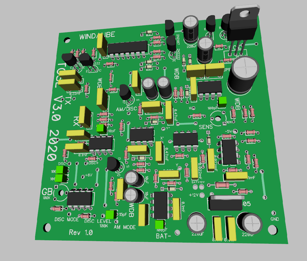

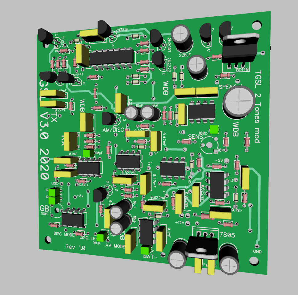

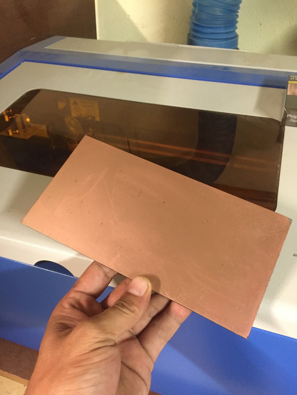

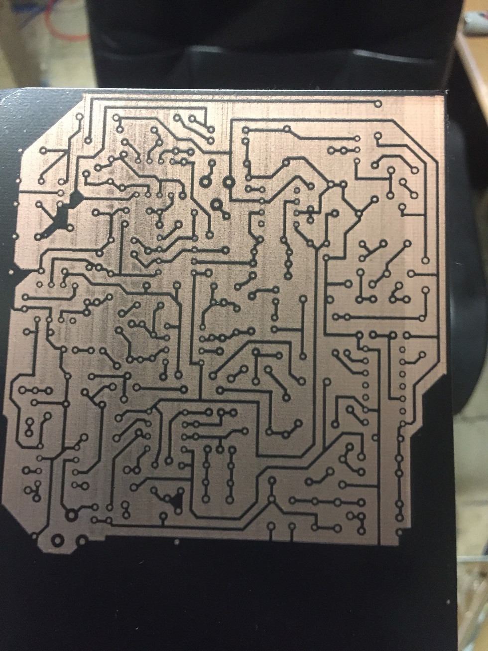

                        i was trying to make pcb but i ran out of iron perchloride
                        so I recreated the pcb with "dip trace", an official pcb and a pcb with the 2 ton mod (experimental)
                        I ordered 5 pcb of each model
                        I'm ready 100% soon

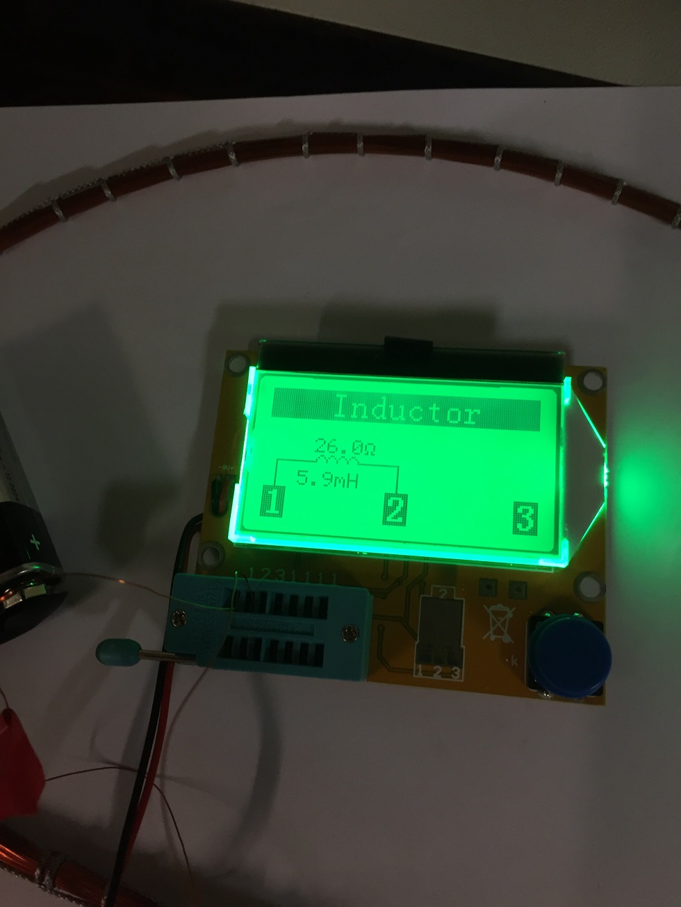

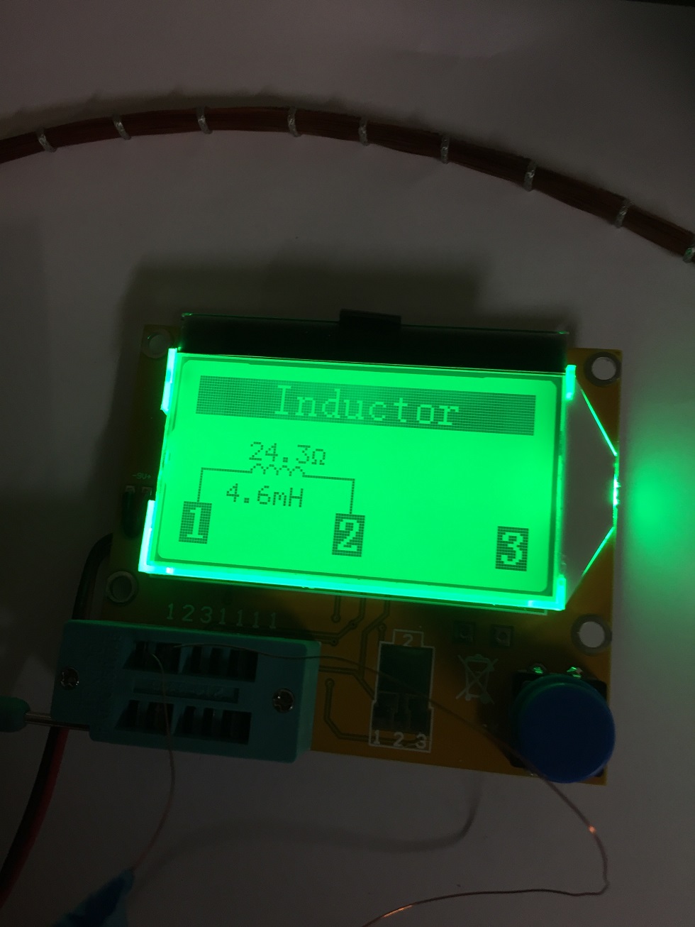

                              I received the measuring device and .... nothing is going well
                              for RX coil 107 turns = 26ohms - 5.9mh ( normally 6.5 so 0.6mh less)
                              for TX coil 98 turns = 24.3 ohms 4.6mh ( normally 6.0 so 1.4mh less)
                              There is a solution ? I have to start over but with a lot more turn ?
