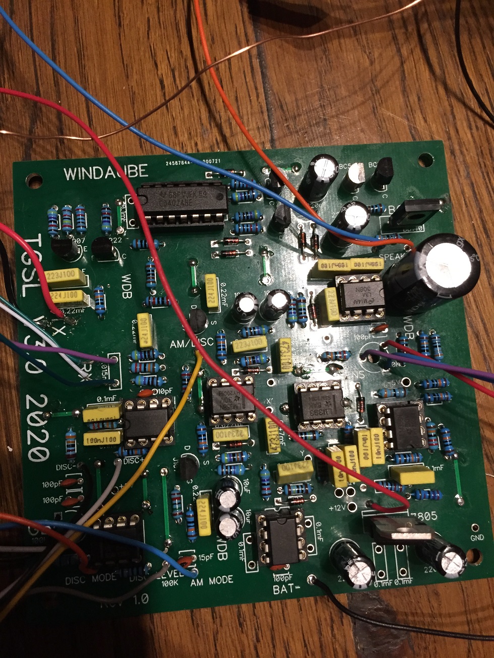

step by step building

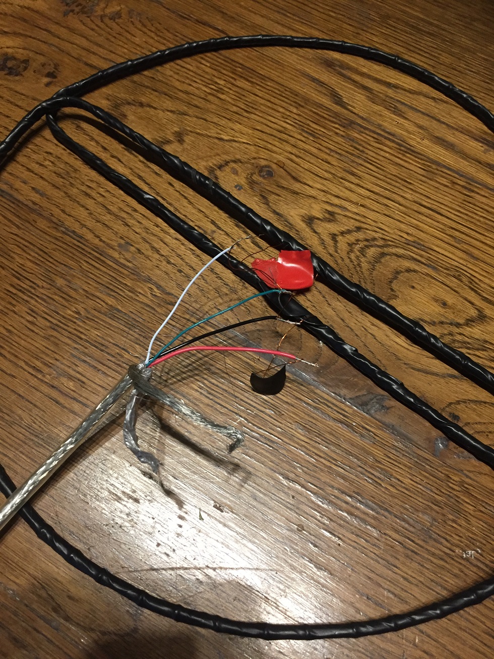

    I tried cable cat5 but the frequency decreased
    I tried the capacitor in parallel with c6, at 19nf it seems to work better than with 15nf, it is the best result with 19nf
    I also have better results with the GB Pot at MIN
    despite the low sensitivity, the discrimination works well
    I removed the shielding from the coils but no improvement
    I don't know where to look for the fault

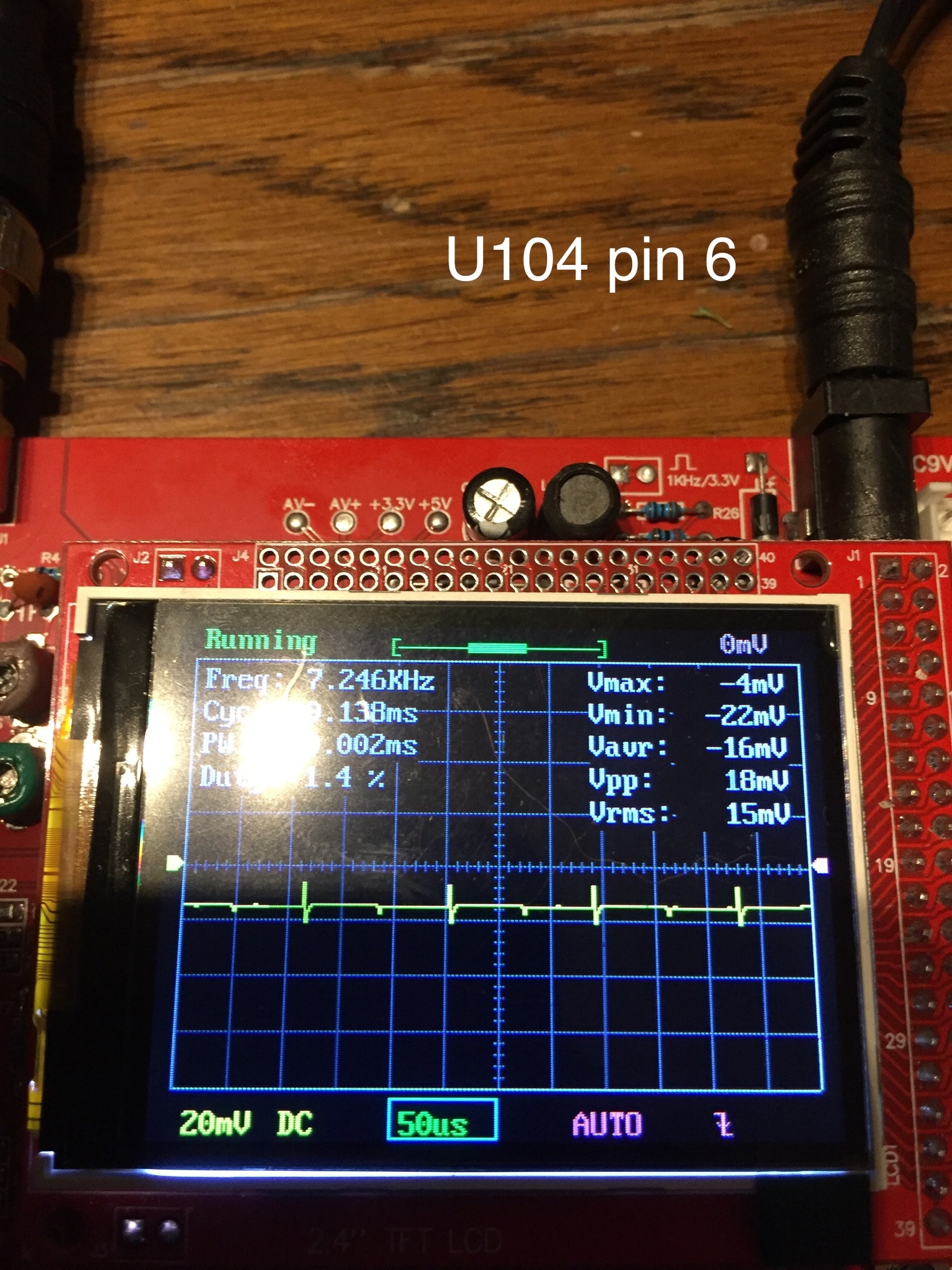

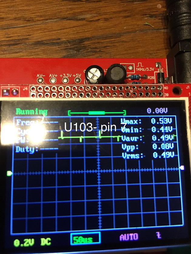

      Measure the DC Voltage on output of U103 & U104. These should be very near zero Volts.
      Which op-amps did you use here?
      Did you adjust the Sens. control (R36) all the way up and did the audio 'chatter' then.
      If no chatter with Sens all the up then the outputs of U103,104 have too much offset.
      You could try the Sens adjust mode.. Take bottom of R36 off ground and connect to -5V.

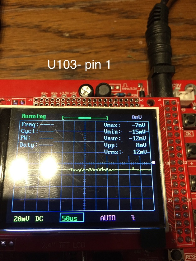

        U103 - pin 7 = +0.5v
        U103 - pin 1 = -10mV
        U104 - pin 1 = -15mV
        I use those of the documentation, U103 LM358N and U104 LM308N

            U104 Pin 6 -0.10 -0.15mV
            U105 Pin 6 -0.10 -0.15mV
            the sens pot work, 8.2V at MAX and -6.06V at MIN, the mod with the -5v does not change anything
            i buy the lm308 in china, i think i lost my money
            i will look to buy tl081...
              I do not know if this is important but I replaced C24 and c25 by two 0.01 capacitors in parallel (I had more than 0.022)
                -0.15mV is ok on U104,105 outputs. So the LM308's should be fine but if you can get TL081's these are worth trying.

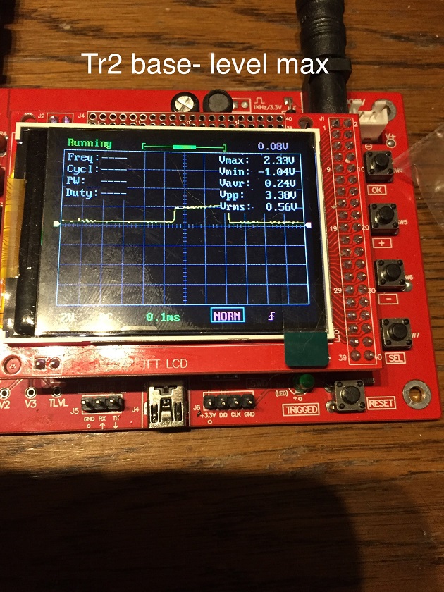

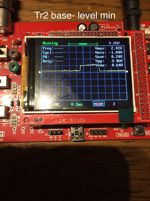

                Check at TR2's base with your scope. With Sens pot down it should be DC and then have audio low duty square wave with sens pot up.
                  Odd that with -5V on sens pot and adjusted all the way up the audio doesn't chatter.
                  unfortunately the audio doesn't chat
                  Possibly issue in the Audio circuit. I have read some having issues with the type of speaker used.

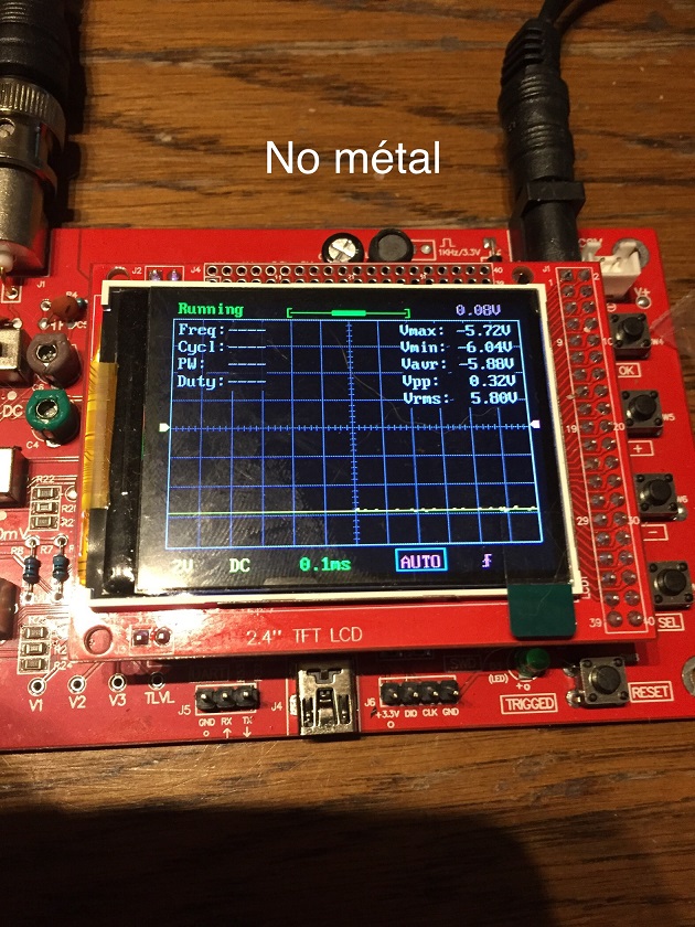

                  I look at tr2, the pin is still at -5.80V, when there is metal the wave goes back to 0v and peaks at 2v,
                  if I move the pot sensitivity tr2 remains stable at -5.80v

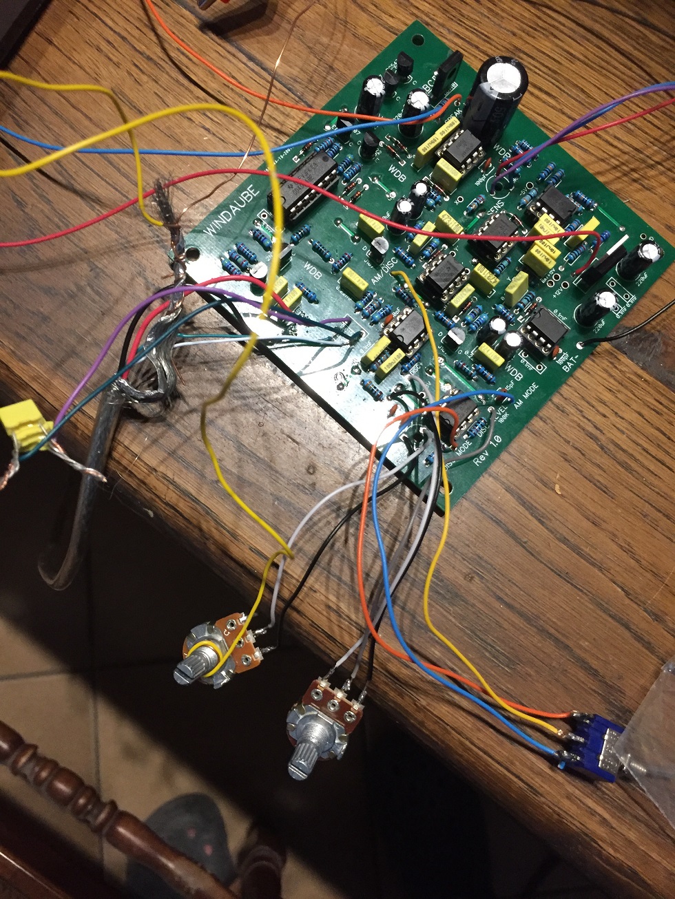

                  I have a doubt about the assembly of the j107 (TR4 TR5), how to check that it works?
                    the u107 (lm35 was out of order !, I replaced the u107 now the pin 7 is at -5v and switches to + 11v when the metal rings.
                    I look at pin 5 of the u107, the pin is at -5v and goes up to 0V when there is metal.
                    when I put the sensitivity to MIN, I have -5v (stable)
                    when I put the sensitivity to MAX, I have -2 -3V and the wave oscillates
                    the sensitivity seems to work but not enough to trigger the threshold
                    maybe the u106 is the problem ?

                      Since you did use sockets for the ICs do try swapping in new ones.
                      Check pins 2,6 of U106. When lower then both U104 & U105 outputs Audio should sound.
                      What are you using for a speaker?
                      Maybe try something else or disconnect speaker and connect to O'scope.
