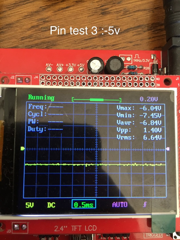

    I tried the tgsl mod with -5v on the sensi pot, but the tgsl refuses to speak when I turn the sensi fully up

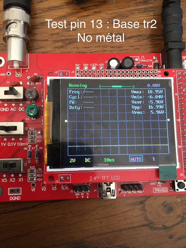

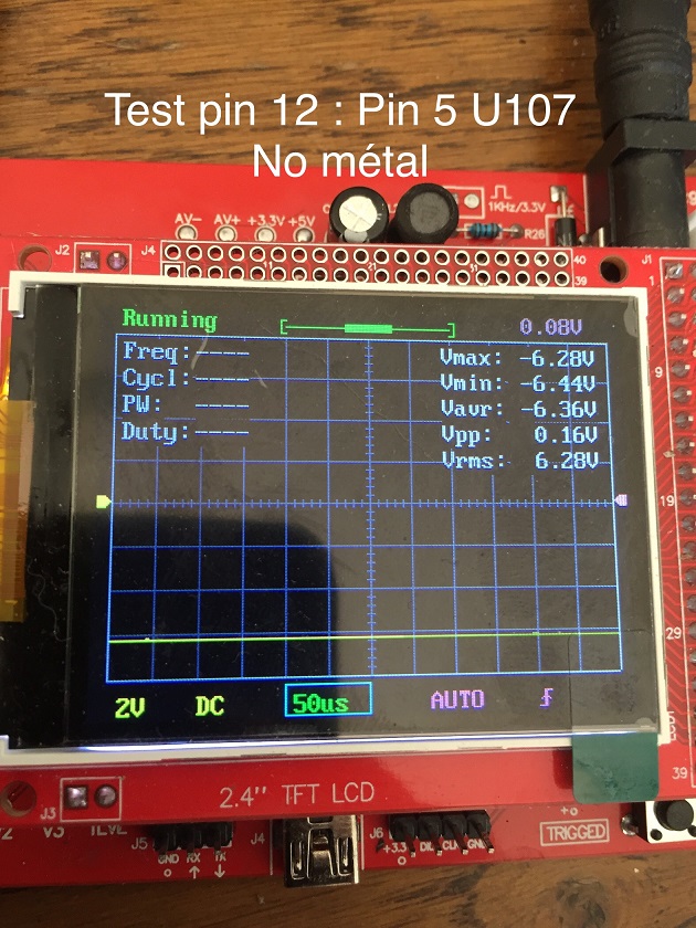

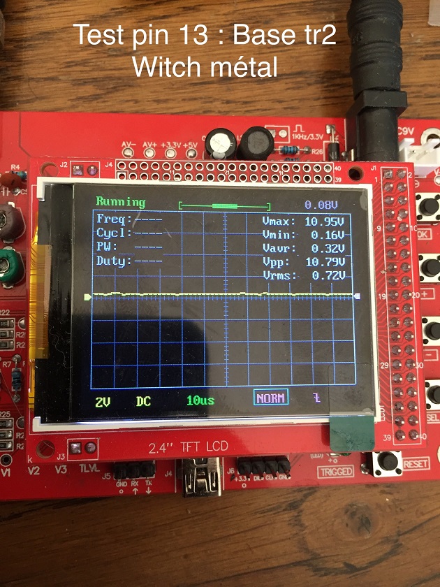

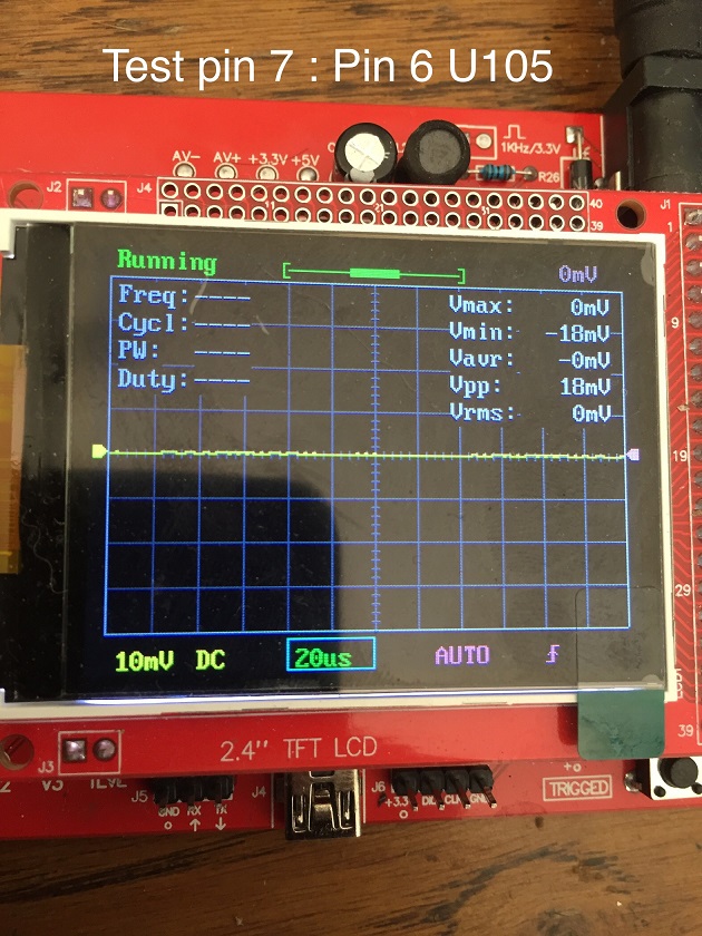

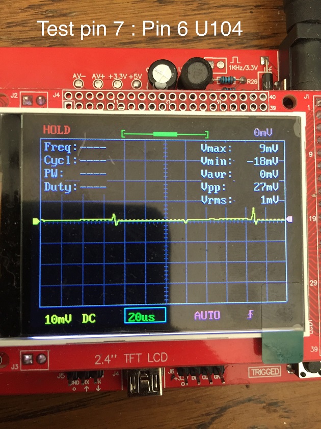

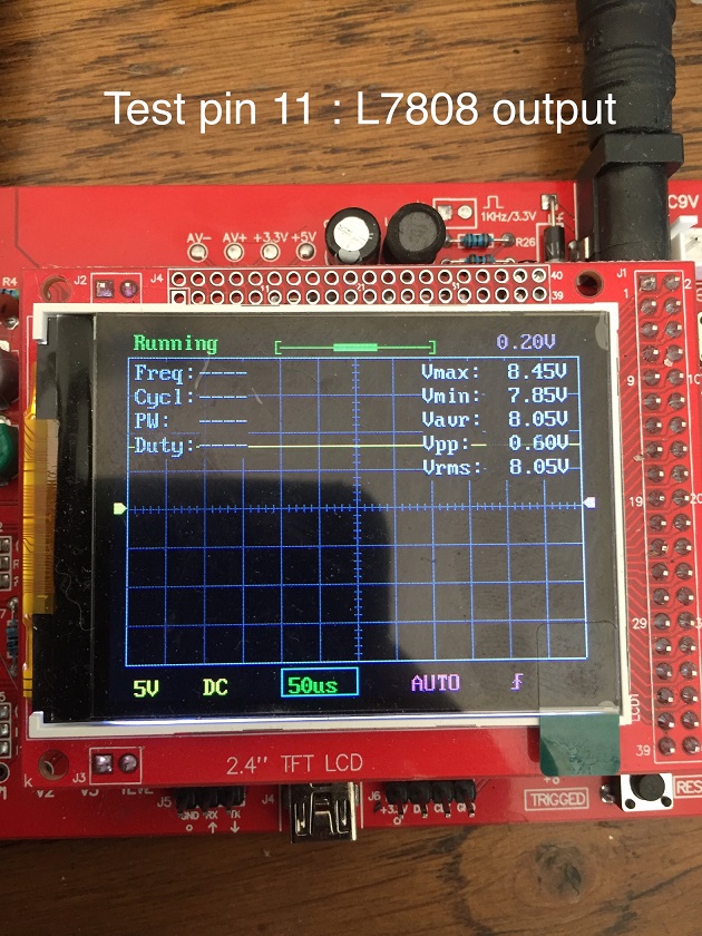

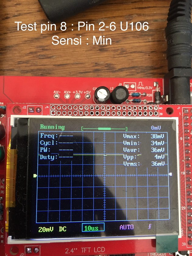

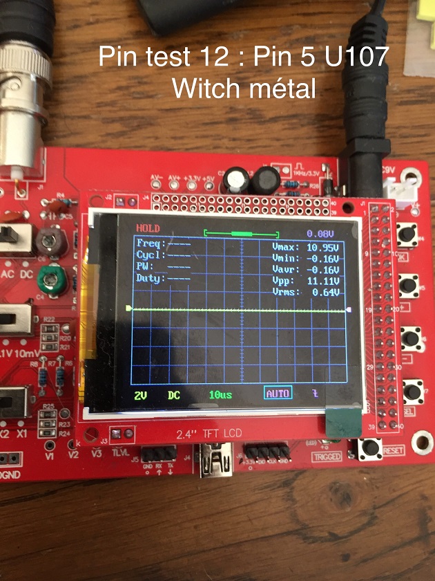

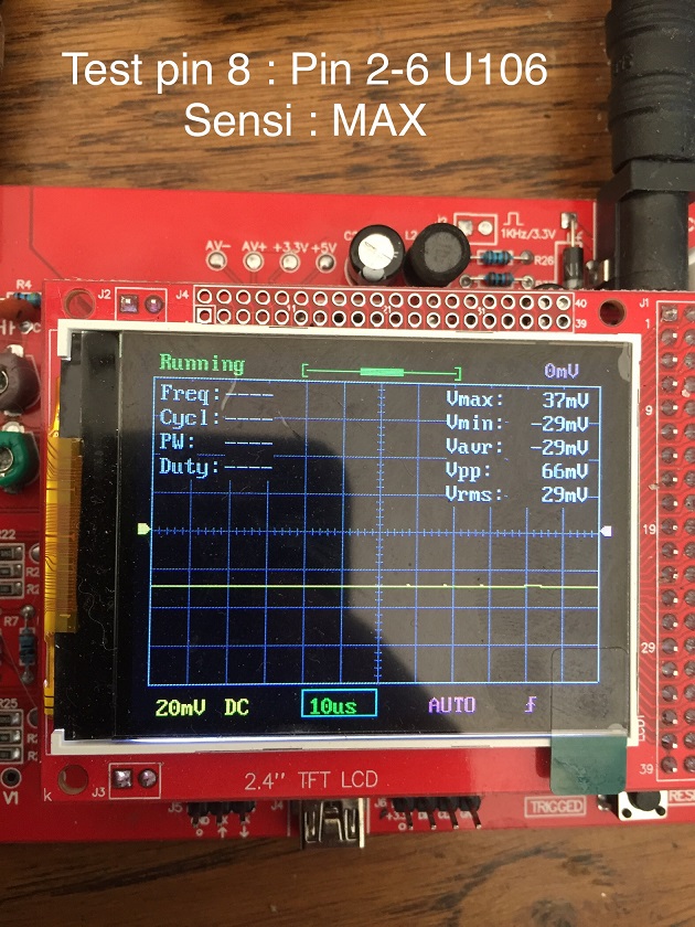

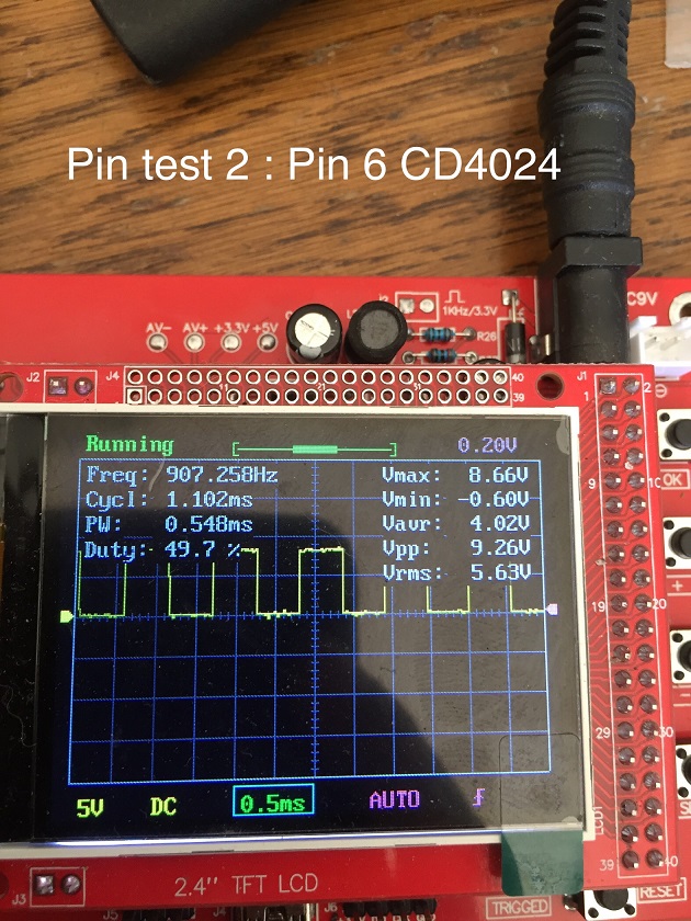

    I think my problem is towards U106, when I pass a 1euro coin at 20cm I have a response on pin6 U105 and Pin6 U104 but the output of the u107 does not switch.
    if I spend the 1euro coins at 5 cm, I have a "longer" reponce and the output of U107 switches
    I took care to test all the points of the tgsl101 manual

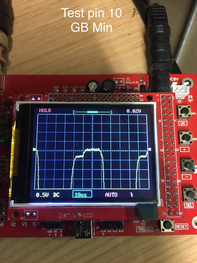

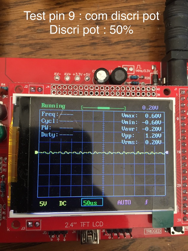

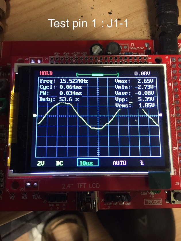

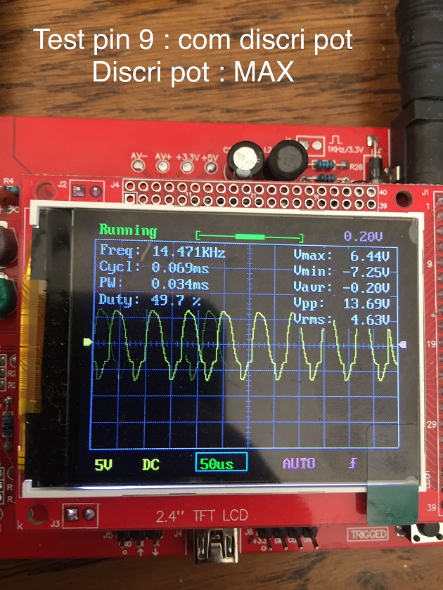

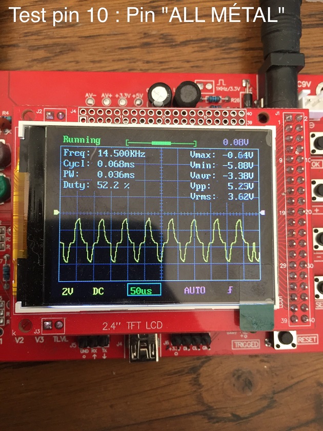

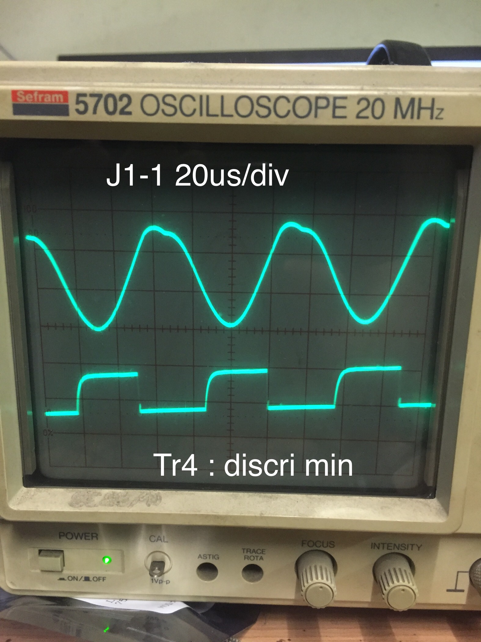

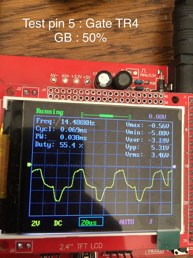

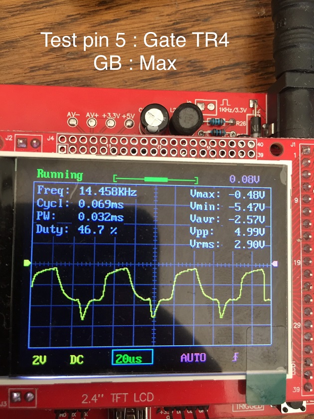

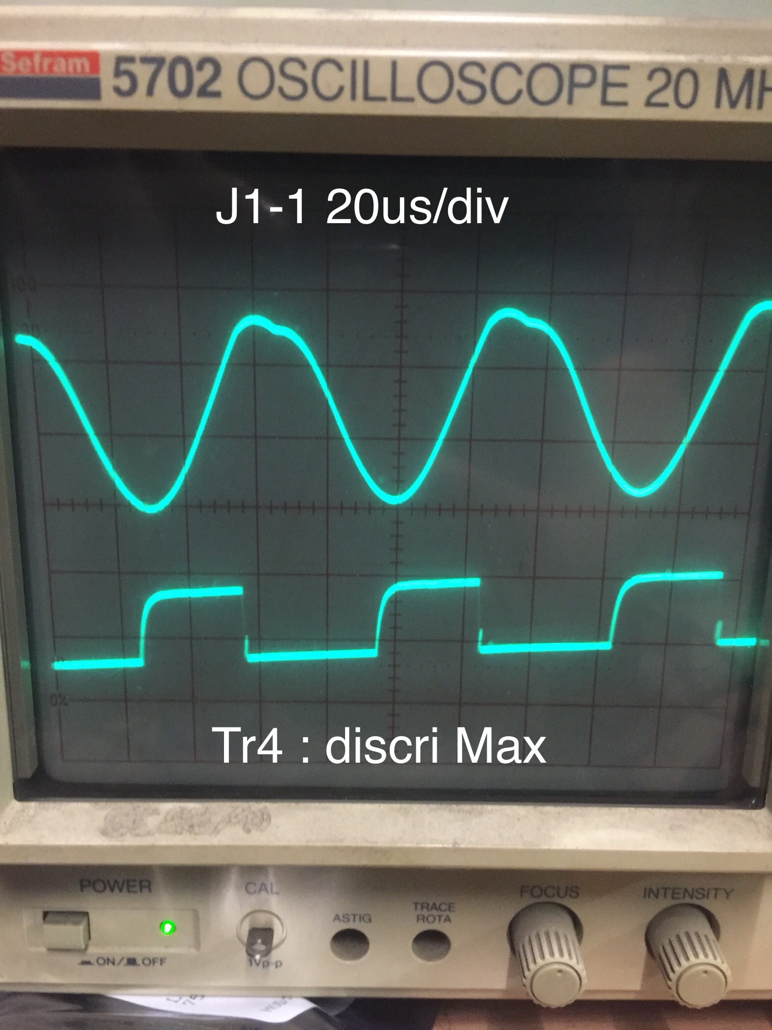

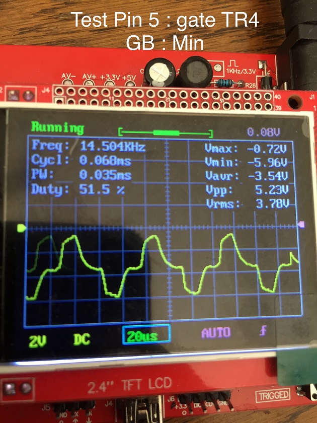

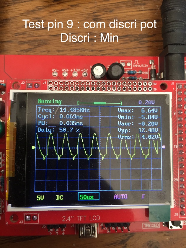

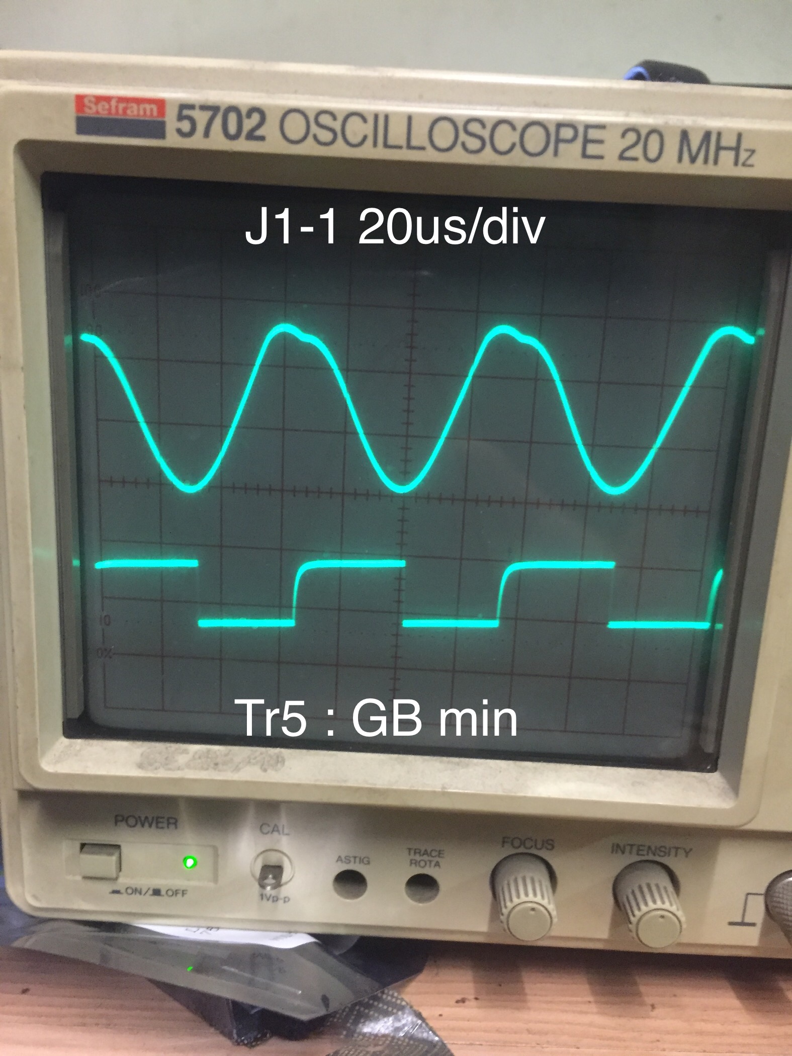

    A few of the scope traces do not look right.
    Biggest is TR4 gate. This should be more of a square like in the TGSL 101 doc.
    The other traces in the
    GB and DISC also have bad shapes.

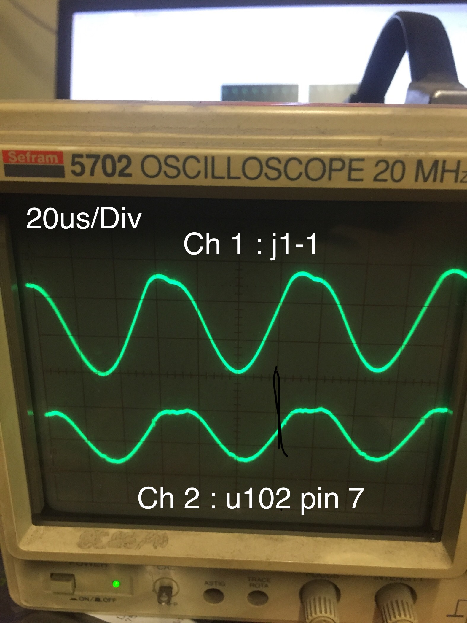

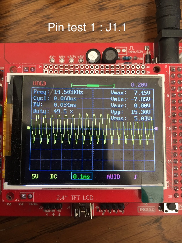

    Going back over your scope pictures I see the TX output is not a clean Sinusoidal but has a strange 'tail' on the lower part of the wave. So something does not seem right in the TX oscillator.
    Are you sure the PCB is correct and matches the EDU schematic?
    Sure you have all the correct part values?
    No Solder shorts between pads?
    All soldering good with no cold joints?

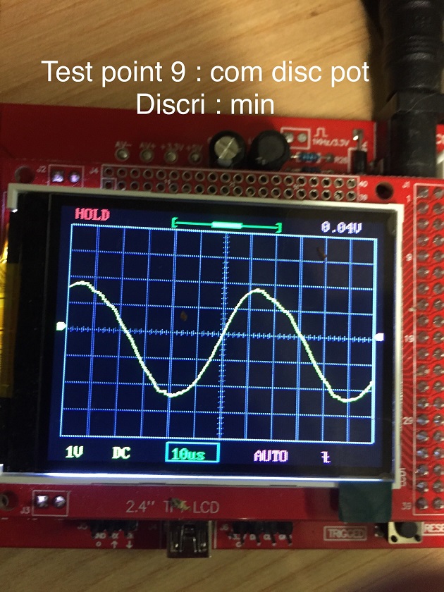

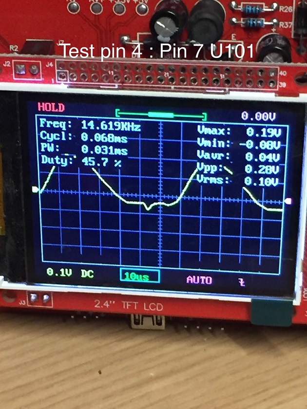

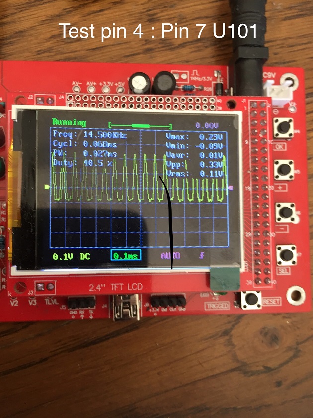

      I think my oscilloscope is joking ..... I added a resistance at the input of my osciloscope because at 1V div it bugs
      the test points seem much better, I have a doubt about the output of the U101, I don't know if it is a measurement problem but when I nulling the coils the wave is not beautiful

      I replaced the LM308 with 2 TP072 (adaptation of wiring) the sound seems better, it "cuts" less
        Those new scope pictures do look much better.
        The TL072 op-amps are very nearly as good as the TL082 and are 'drop in' replacement for the LM308.

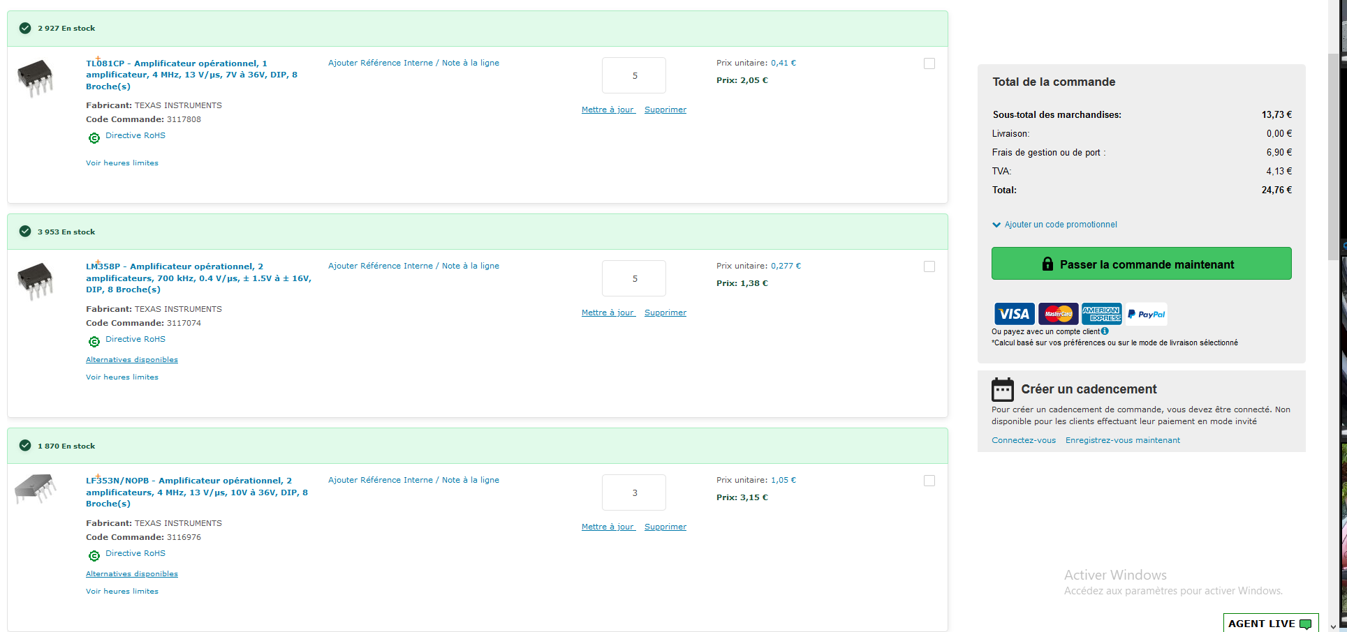

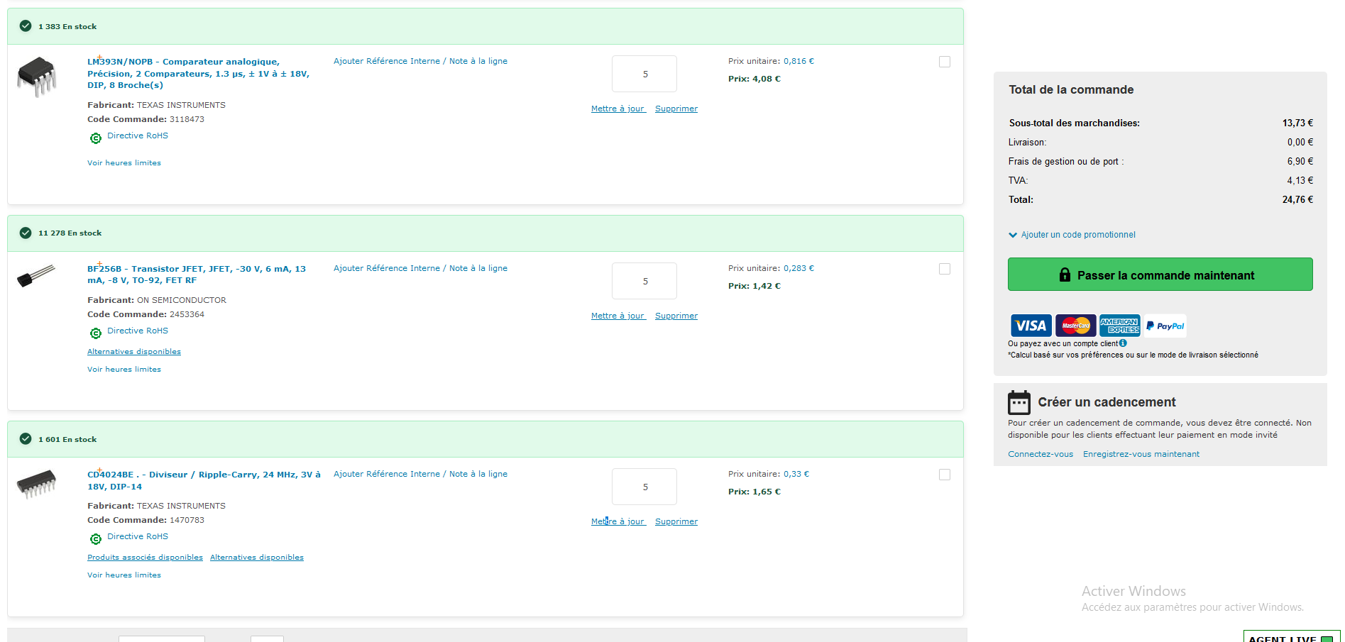

          I would like to replace all the IC with a "serious" supplier (farnell)
          for TL081 I find several version : TL081BCP, TL081CP, TL081IP which one to take?
          For the lm358 I can't find an LM358N but an LM358P, it works the same?
          I found some LF353N and LM393N
          does that sound correct?
          I am also looking for an equivalent to j107 and bf245c, an idea?
            I use the TL081CP in my TGSL.
            https://www.ti.com/lit/ds/symlink/tl...=1596331629893
            P = plastic package
            C = 0 to 70C Commercial Temperature range
            I = -40 to 85C Industrial Temperature range
            B has 2mV instead of 3mV Input Voltage offset.
            CP ACP & IP have same specs as far as I see in the DS.
            I used BF256B for the FET switches (TR4, TR5).
            Either LM358N or P work.
            I also used the LF353N and LM393N.
            I buy from either DigiKey or Mouser so I am ensured of getting 'real' parts.
            Mouser does ship to Europe so if Farnel doesn't have what you need check them.
              thank you for this information
              the problem with Mouser, shipping costs, 20 ? minimum for europe...
              I took everything in texas instrument (farnell)
              the lm353n and the lm393n have "nopb" in the reference I don't know if it matters ?
              if my oscilloscope is correct, it proves that I have a problem directly at the output of pre amp (pin 7 U101)
              I hope the change of IC will solve my problem
                Yes, shipping from US would cost.
                No Pb (lead) is not a problem. Almost all parts now are no Pb to meet RoHS standards.
                The U101 output does look wrong.

                      now i have another problem,now the discri does not work anymore
                      same metal the discri "cut" always at the same point

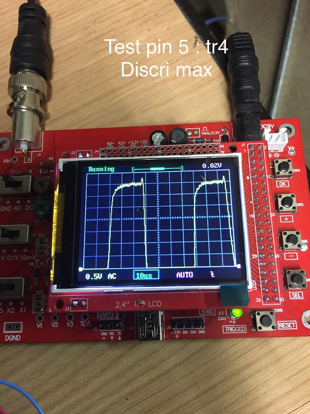

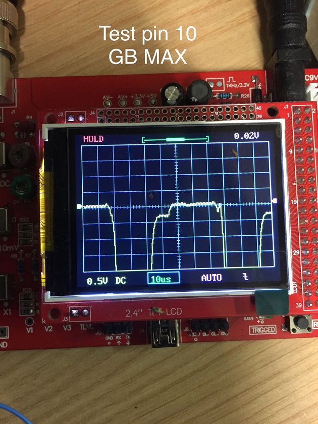

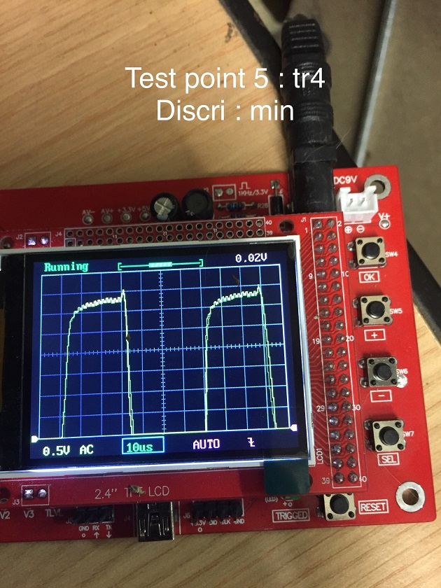

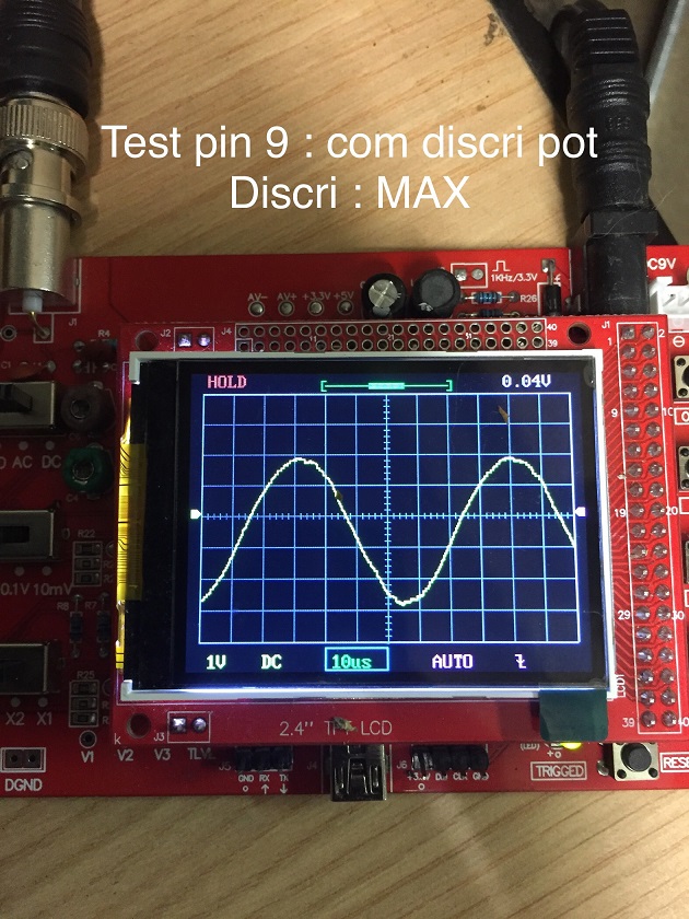

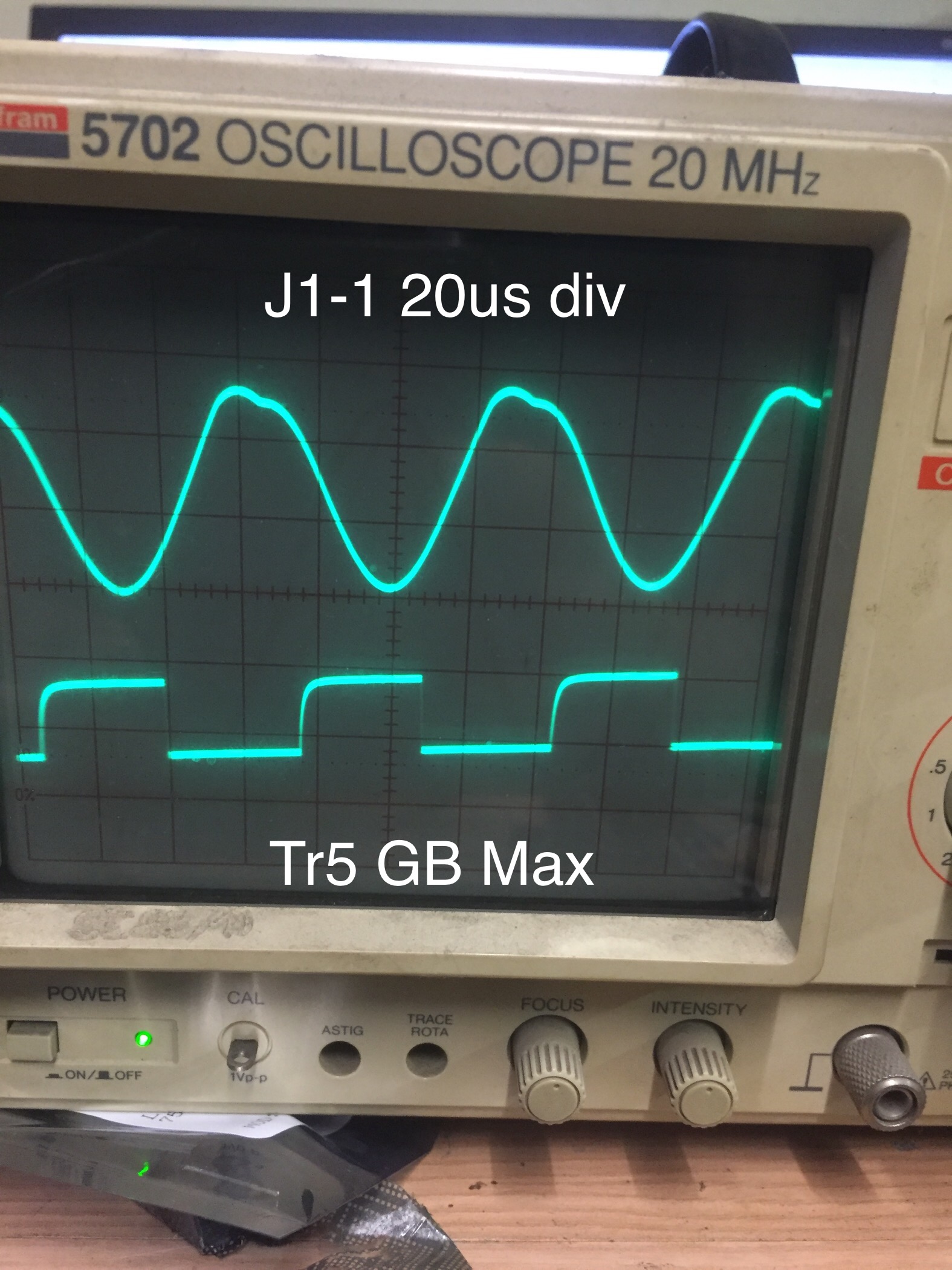

                      I looked at tr4 and tr5, now the discri pot and the GB pot cause a phase shift, the "pulse time" does not change, just signal shift

                        Well the scope traces of signals look much better with your new scope.
                        Yes, 50-60% sensitivity is max with the -5V mod. I typically run about 40% in the field else it continuously chatters.

                        There is timing changes with GB & Disc at min & max. Compare with scope pics in the TGSL 101.
                        The phase shift of the TR4 &TR5 pulses is what is important not the width.
                        For Disc make sure the switch is in Disc mode not All Metal mode.
