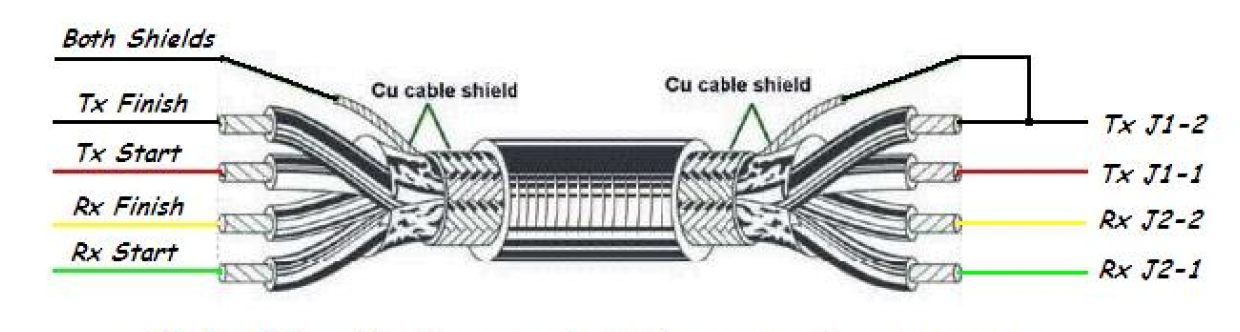

        Maybe recheck the cable and coil shield connections.
        for the wiring I use the attached picture

        I did like you, electric tape> graphite> earth wire> graphite> electric tape
