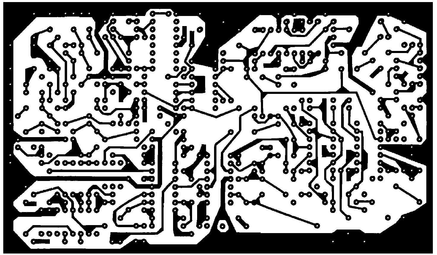

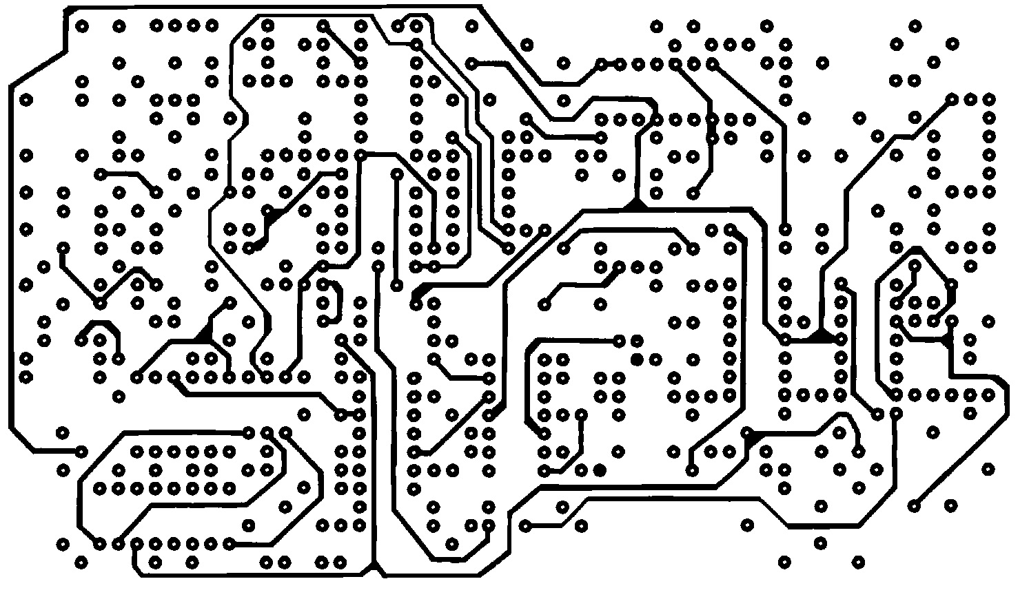

      The schematics are only partly completed electronically. My Partner has them hand drawn right now. I guess I can just scan them and post the scans.
      Let me see what I can do today.
      -C
        Here are the hand drawn schematics for the Half-Dime.
          Half-Dime PCB component placement.
            Thank you,
            Indeed, it is interesting.
            A quartz controlled transmitter (like Fisher), LF444 and LM324, a lot of voltage reference, i like it ...
            Bests regards.
              VERY interesting, low noise design. I VERY much like the receive amplifier. Good impedence match to the coil and following stages I think.
                The transmit oscillator can be changed to operate at any desired frequency. Initially it ran at 15Khz, but was then changed to run at 8.192kHz with a custom 8" or 6" concentric coil. The first build used a Garrett Ground Hog II concentric coil and could get a dime at about 16".
                The LM394 is critical to a low noise preamp and is used in many of our designs.
                -C
                  PCB scans of the top and bottom. The Arrows indicate alignment marks.
                  -Chris
