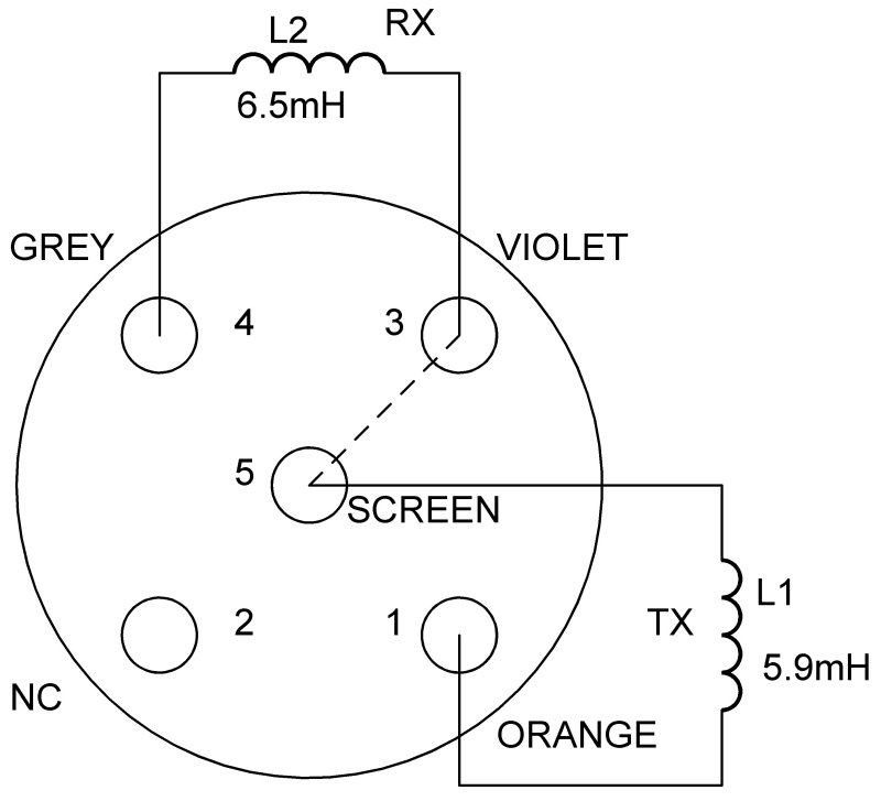

        could you tell me if this is right four wiring up a coil.coil side connector first then coil connector pcb
        pin 1 Violet
        pin 2 nc
        pin 3 Orange
        pin 4 Grey
        pin 5 GND (shield, no colour)
        Following R26 -> RX is Pin3 (purple)
        Following R27 --> RX ist Pin4 (gray)
        Following C2 --> TX ist Pin1 (orange)
        Following C1 --> TX ist Pin5 (Sheild)
          See diagram below.

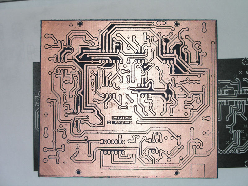

            PCB is made. Not my best looking board but I believe it will be ok. Just got drill a lot of holes and start soldering.
              Very nice, Merc, despite some shortings.

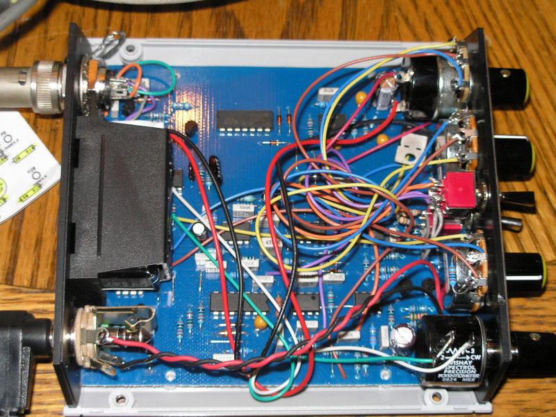

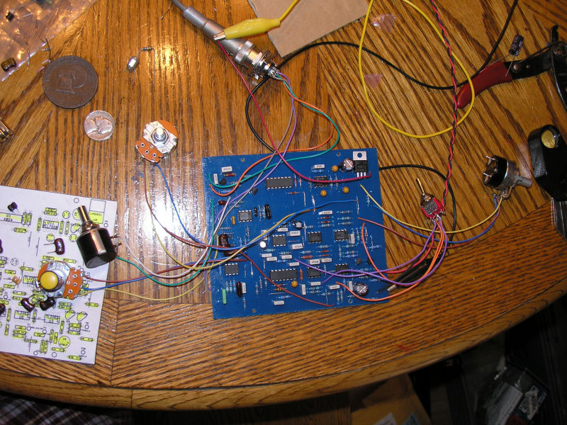

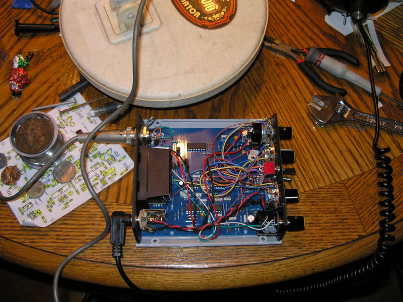

                          Here is a picture of my completed PCB. I'm still not sure that my ground balance contol is proper. It can ignore a small piece of ferrite but only with the ground balance control all the way at one end(pot measures 48K). So I chaned the 180pF going into gb control with a 300pf. This makes the ferrite null point closer to the center of the pot. I'm not really sure if this correct but it seemed better to have some range to either side.
                          The discrimination is good but I would still like the point of discrimination of US nickels and gold rings to be at about 4 on the dial instead of 6 or 7 which is what I had to start with. I've started to wonder if maybe Tesoro uses logarithmic or audio taper pots in there units. That could explain the difference. Studying the Tesoro Silver Sabre II schematic, I see that it uses a 100K fixed resistor across the low end of the 100K disc pot. I've tried this and it does help shift the discrimination in the right direction and my unit no longer rejects a US quarter at max discrimination.
                          I'm still needing help with the battery check on this unit. I can't see no way for the battery test length to vary since the timing components are charging with fixed supply voltages. The intensity of the test tone varies with supply voltage on my unit, but not the length. The manual says both change with battery strength.

                            More pics of pcb in case.

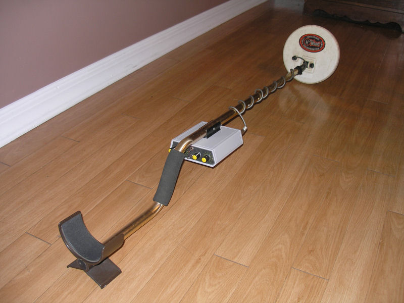

                                I have only tried my detector in my back yard but I was able to find a cheap child's ring and a small heart from a child's pendant. The discrimination is very good. The sensitivity is just average. It will detect a gold wedding band at about 7-8 inches. Most coins around 6-7 inches. These are air tests only. The all metal mode is working pretty well after adding 20Meg of resistance across the Auto/Normal switch. This gave some input to IC6a with the switch in the Normal position. Without the 20Meg, the input to IC6a is floating while the output is still connected to IC6b and it seemed to be adding sporadic noise to my all metal mode. Other Tesoro designs have something between 12Meg and 100Meg in that part of the circuit. 20Meg gave me a slow re-tune while pin-pointing that works for me. I wished I had used a larger box. The pots I chose were full sized approx. 1" diameter types and the front panel was really crowded. Here is a pic of the unit which uses the rod from my old Silver Sabre 2.
