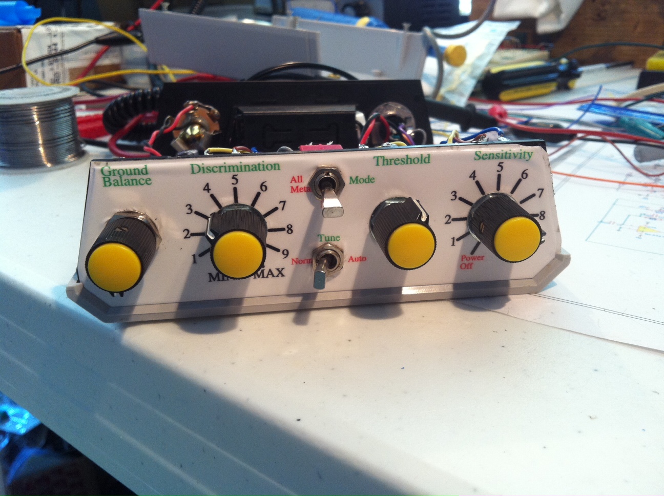

  • Merc
    replied
    Well, I couldn't wait. It's too hot to do anything outside so I cannibalized my original Bandido clone for parts to finish this one. With a few minor issues such as pots wired backwards it works. It seems to be a bit quieter than the first one. Just need to mount a speaker. I have never bothered because I use headphones anyway. I want the speaker to make it "complete". Here are some pics including the front panel label I had made. It cost $20 for the sticker with lamination.
    Merc
