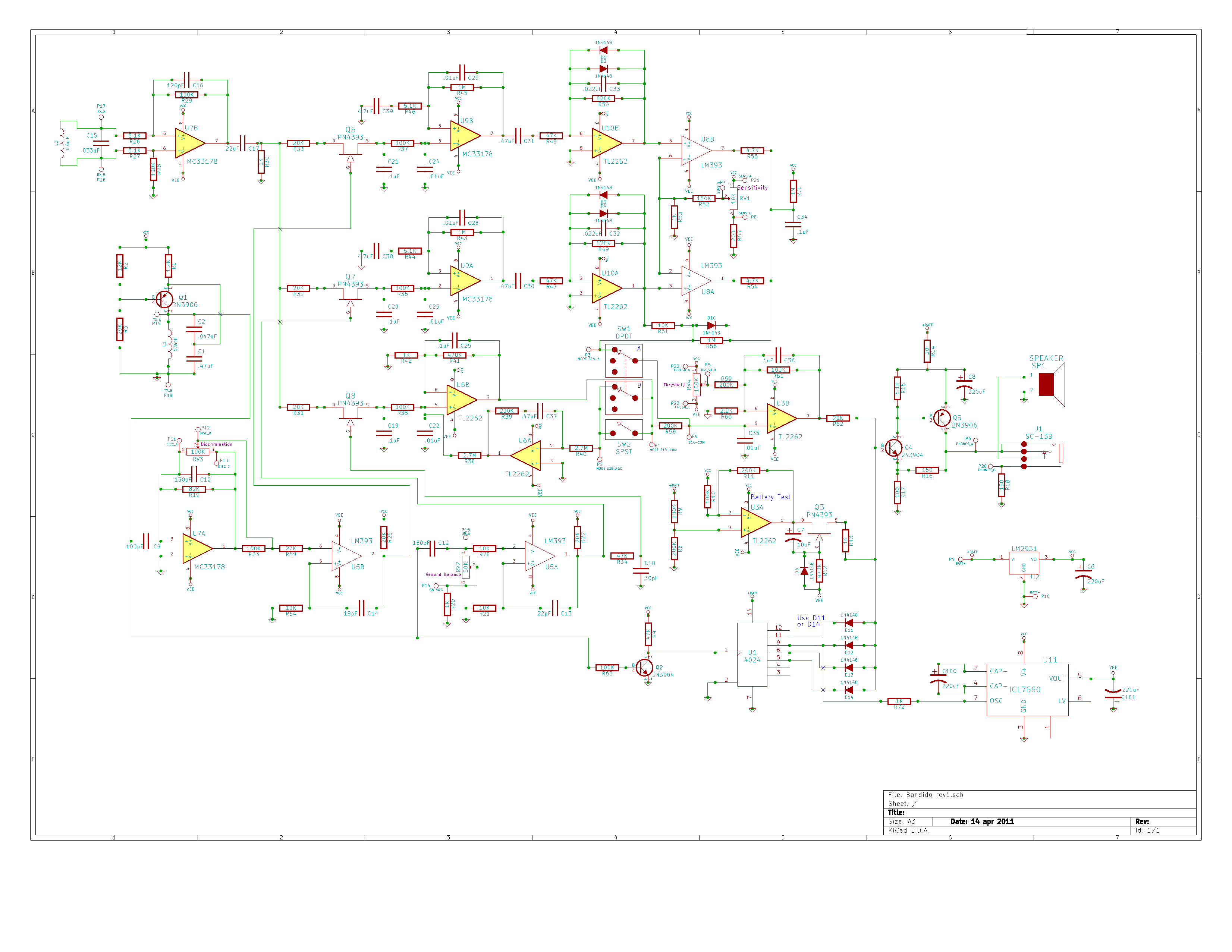

              • #52
                Rev 1
                I'm going to try again on my Bandido II. I have a nice case with a nicely printed label for the controls and the parts, I'm just not happy with the stability of the detector in the motion discriminate mode. During air tests, it gives a good clear sound on close objects...say 4-5 inches, however, as the object gets further out, there is break-up in the signal. The sound gets erratic and broken. The same if you place a coin 3-4 inches away from the coil and move it very slowly. Even my old Golden Sabre (factory original) gives a very clean and smooth signal on objects 7-8 inches out, it just gets weaker, fainter but not broken. After lots of measurement with a scope, the noise I'm seeing at the comparator stage looks like 60 cycle. Well, I am in-doors. That must be it. It seems to do the same standing in a field far away from electrical noise. Also, when I switch to all-metal mode, the detector is quiet. The all-metal mode uses the same receive front end and samples as the motion mode, at different phases of course, but the same ones so I should here it there. I'm suspecting that this is some type of phase jitter going on. I'm a little suspicious of my TC4066 switch I'm using. So I've decided to try using JFETs as in the earlier machines. I think it is easier to layout the pcb when you have separate JFETS instead of all the sampling done in one IC.
                I've also made changes to the battery test circuit. I've decided that C7 (10uF tantalum) belongs where I show it on this new diagram. This is the only way to have a varying length tone based on battery voltage. This is also where it is on previous Tesoro designs. I decided to use a JFET here as well because they have an active region to give you an output that varies more in level. The 4066 is just going to switch on and off without varying. This is exactly what the Silver Sabre II uses.
                Another change I have made is at the CD4024 divider. I have added an optional diode to give me a lower tone. I'm not really fond of the high tone that some of the new Tesoros used. By using D11 or D14, I can use a high or low tone.
                I have also decided to sync the 7660 voltage mirror to the transmit oscillator. This should eliminate any problems with a "beat" interference happening.
                • #53
                  Hello, Merc.
                  I think you're right on with the battery test but I see a couple of other possible problems.
                  1) You should move the DISC pot connection to the other side of C9!
                  2) Remember that JFETS should only be pulled up to ground, not +5V as with the CD4066.
                  3) For the oscillator transistor, it won't make a ton of difference... but you should probably use 2N2907A instead of 2N3906. That might push a couple more mA through the coil.
                  Also, beware that the phase "sense" of your demodulators may be considerably different depending on whether JFET or CD4066 is used.
                  If you compare JFET an CD4066 demodulators side by side and rotate the phase of the input signals, you might find that the two outputs change from positive to negative at substantially different input phase angles. Unless I have it backwards (which is possible) the JFET side would be lagging the CD4066 side.
                  For example, I had a plan to use JFETS for GEB and DISC channels and use CD4007 as a full wave demodulator in an all-metal channel. Wierd though that may sound, that was my plan until I ran a side-by-side simulation and discovered that for a given receiver input to the demodulators, to "zero" the outputs the reference phase clock to the JFET needed to be almost +30 degrees relative to the clock on the CD4007. That ruined my day but at least I had not fully completed a PCB layout.
                  This was at 15kHz frequency but I think that (understanding that I was comparing apples and oranges for that test) that principle would probably still apply for your 10kHz Bandito II. It's no big deal so long as you don't want to use different styles of demodulators in the same detector but I thought I would mention it anyway.
                  • #54
                    You are very correct about those JFETs and the Disc pot. I see a few other problems at some of the op-amps. They are flipped making signals go in the wrong inputs. I sure hope I didn't do that on my first attempt at the Bandido.
                    Merc

                            I have fixed the mistakes that have been pointed out. Here is the updated schematic. I think I need to test before building a board for it. I should be able to breadboard the JFET sampling circuit and run signals between my current Bandido PCB board and the breadboard. I'll keep the leads as short as I can to keep the 60Hz noise down, but since I'm dealing with basically audio frequencies, I think it will work. I'm hoping I can at least figure out if it will definitely not work (using JFETs) or if I just need to change a capacitor here and there to shift phases a little.
                            Merc
