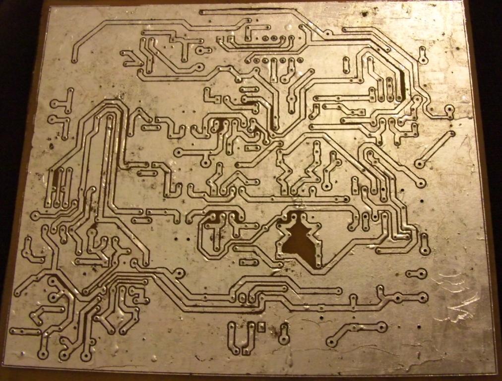

        hello merc
        etched my pcb last weekend (the one from above post b/w picture)
        looks good
        did yours run good? have you made a video?

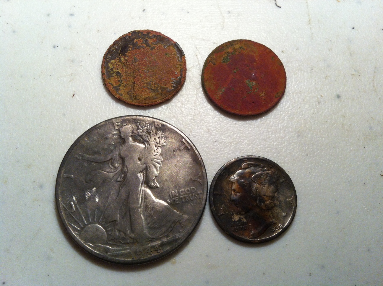

                    • A few recent finds.
                      I've been using the Bandido clone quite a bit lately. Here are a few of the recent finds with it.

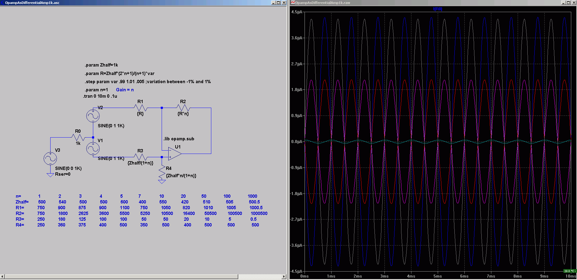

                            • There might be a minor refinement on the front end that might aid a little bit to stability, and it is a mere resistor value change. Point is that using a common sense R26=R27 and R28=R29 yields in a mismatch of impedance at inverting and non-inverting paths against the ground. Point is that non-inverting path has impedance ~R27+R28, while inverting path has impedance of less than R26. Both referenced against ground.
                              Now, while there is no ground to be seen in the schematic, there certainly are some capacitive paths to it, and unless shielded, it will present itself to a frontend.
                              In case impedances are balanced you get behaviour very much like that of instrumentation amplifiers, but at less cost, and a finite (and not too high) input impedance. Maybe a bit tricky R values.
                              Here are my observations in LTspice, observe the I(R0) as an indication of balance. There are some ready made values for various gains, and normalised for input impedance ~1kohm (twice Zhalf)

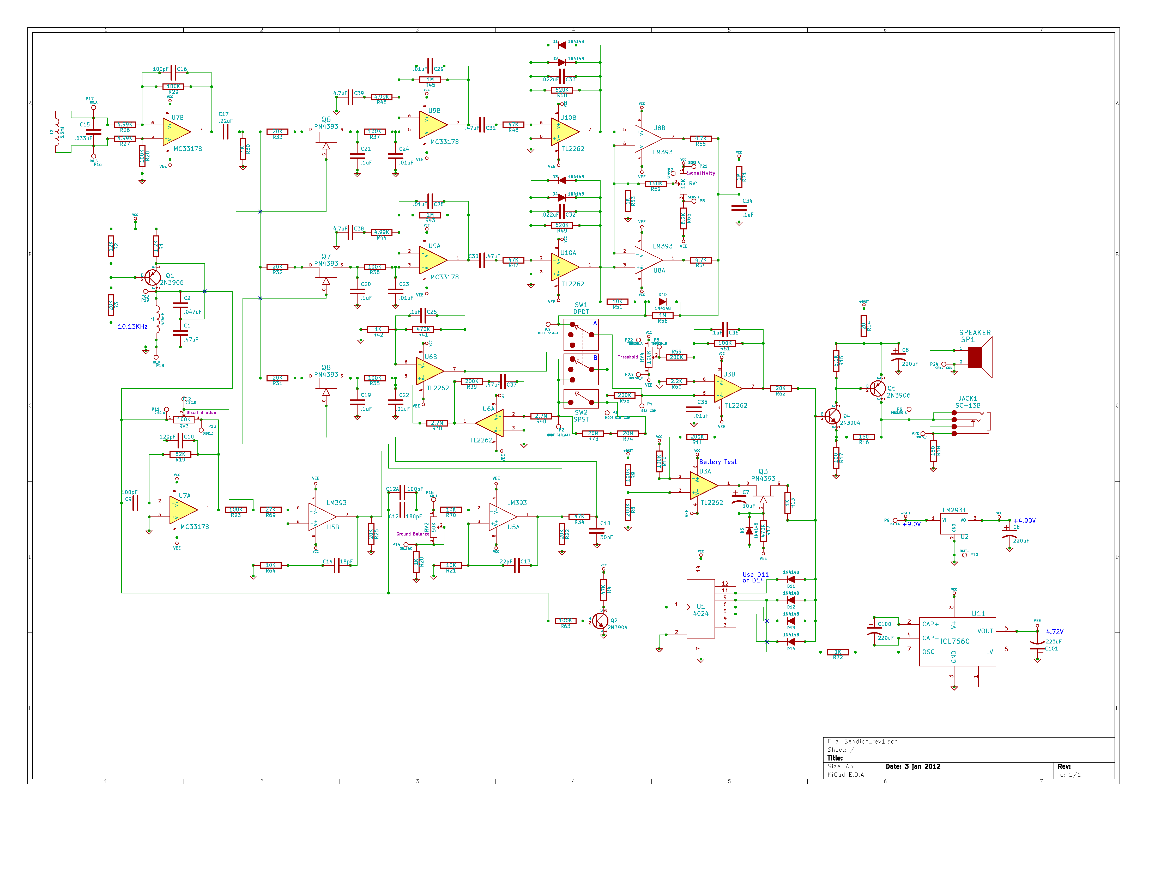

                              • i want to make that ,plz upload pcb schematic
