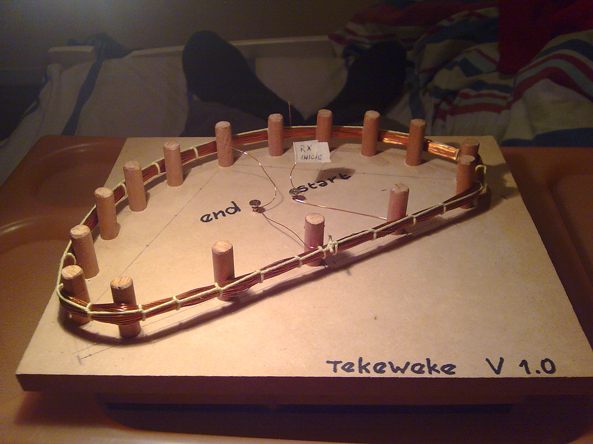

Hi all I'm putting together the TGSL that I began to arm QIAOZHI posting coils and finish as the post says the coil RX and TX 107 laps 98 laps right now as I do not have a measuring inductometro gives me strength and nearly equal RX = 9.7 TX = 9.8 ohm ohm this is good or has to be greater resistance diferncias between coils
coil TGSL help me pleace
inductance
if I understand the difference between inductance and resistance, the question is.
with a coil resistance well calculated that would have to be when measured with a tester
so I could more or less know or come close to this ideal inductance
PS: the wire is 0.25mm might not be appreciated by the photo too close
If you have followed the instructions provided by Ivconic, even without an inductance meter, you should not have a problem. You're main difficulty will be balancing the coils correctly, but Ivconic has even provided a simple method for doing that.Originally posted by Tekeweke View Postif I understand the difference between inductance and resistance, the question is.
Everything you need is here -> http://www.geotech1.com/forums/showthread.php?t=15710Originally posted by Tekeweke View PostThanks for replying do you know the link of this post I have enabled status seeking but can not find greetings
