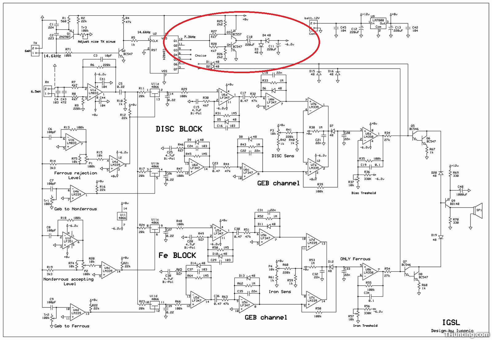

                        Hi, today i have tested all ground points, and all are good.
                        I also tested the feed point, the only thing wrong is on pin 4 of the LM393, LF353, LM358 and LM308, where should have -5V, I have -6v.
                        Someone with EDU TGSL could measure to verify that voltage is in this pin???
                        Thank you
                          As per this schemic your six volts is good!
                          I thought you found the problem and had this one up and running?
                            Hi homefire, in my schematic this point is -5V, i attachment this.
                            unfortunately I have not found the problem, I checked everything and the problem persists
                              hi knutdi,
                              I've got the TGSL-EDU and the negative voltage is -6V too.
                              There is nothing wrong about it.
                              If you really want to have -5V, just add a 79L05 regulator ... but it's useless.
                              About the touchy cable, I've got the same problem with the USB2 cable.
                              Try another kind of cable, fix it along the lower stem and check if the connector is well grounded.
