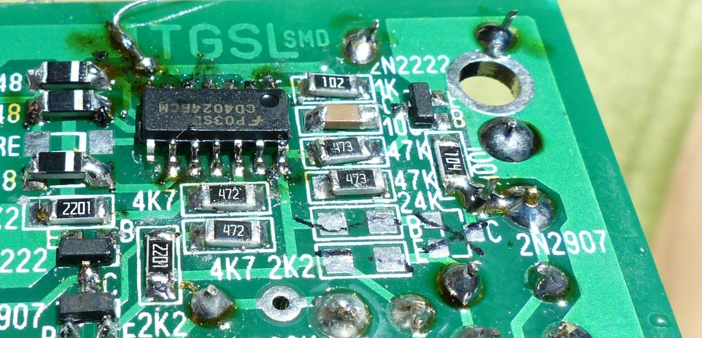

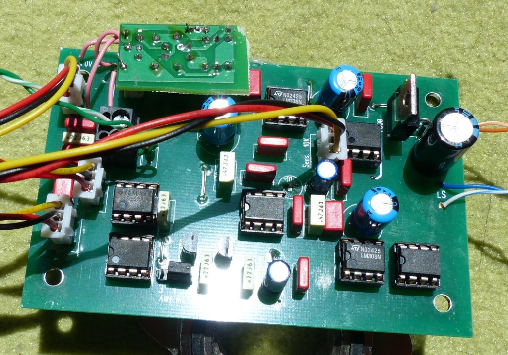

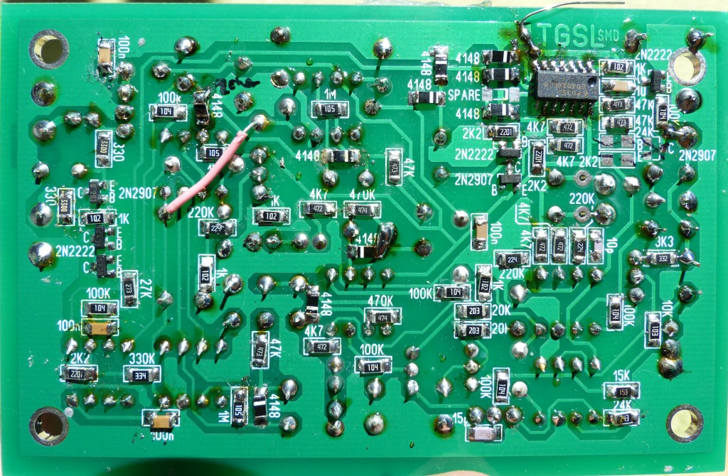

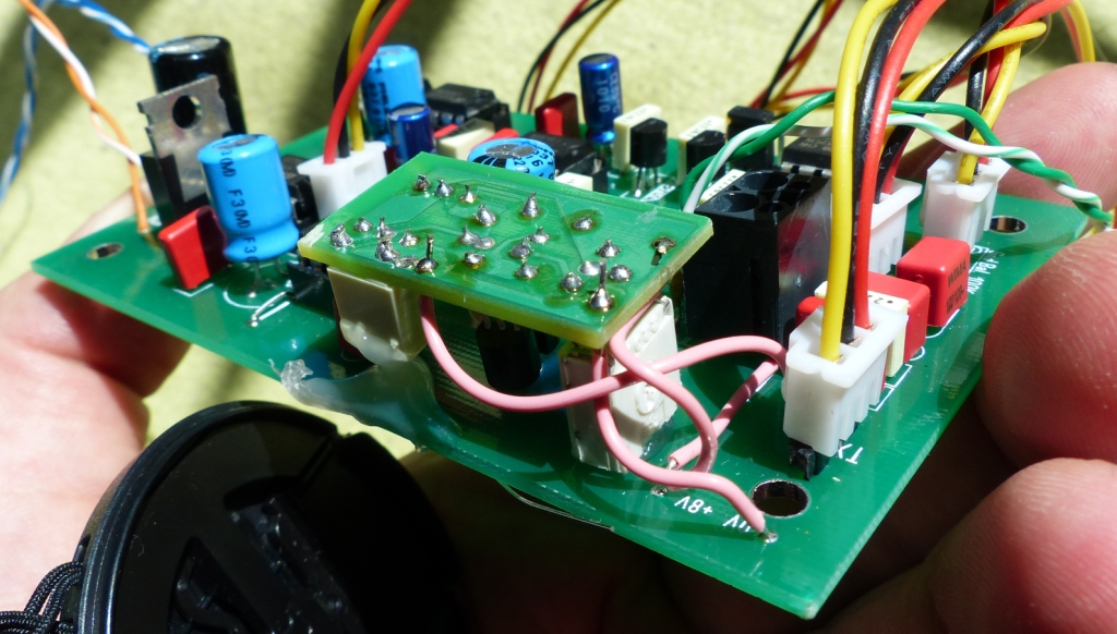

  • ok here some picturesClick image for larger version
ID:	337094Click image for larger version
ID:	337095Click image for larger version
ID:	337096Click image for larger version

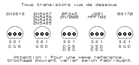

                    • HI firebox , here is the pinout of the different transistors used. Click image for larger version
ID:	338189Click image for larger version
                      • attention to those who have problem like me and Hugo, watch this link you will find that BF245C is available in several pinouts depending on the manufacturer. So it can cause a very bad operation of the detector such as a very poor sensitivity reduced to 20 cm see less depth of detection. So check out the pinout of your transistor. http://www.sonelec-musique.com/elect..._brochage.html
