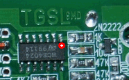

                • hello
                  yesterday i finished my tgsl smd
                  but guess what - nothing
                  no negative voltage on all ic where i should get -5v
                  i watched for good ic 4024 but i think i was a wrong type which was delivered
                  on all outputs of 4024 i have 12,6V (my supply voltage)
                  it makes no fun to look for erros
                  ohhhhhhhhh
                    Hi Bernte_one,
                    What is the ref. of your IC ?
                    Look for MC14024, CD4024 or HEF4024 (power supply up to 15V).
                    Hugo
                    • hello hugo
                      yes thanks i know that i have to look
                      but i dont read the data sheet shame on me
                      was a hc4024
                      i ordere now hef4024 15V
                      hope it will solve my problems

                      • hello
                        i have changed my 4024 ic to a type wchich can handele up to 18V supply voltage
                        the hc4024 i used before was only for 6V
                        but i have same problems like before at point where i should have -5v i get +0,7V
                        the points where i should have 8V i get 8V
                        i suppose i have to go some more steps back think i have collect the wrong type of transsistors
                        or something else (the problem must be at the smd components) wrong substitutes or wrong orientation
                        • What about the orientation of the 4024 ? Red dot is pin 1.

                          PNP and NPN smd transistors have the same orientation. You can't be wrong.
                          The 3904 should have a 1A mark on it and the 3906 : 2A
                          See : http://www.electronica-pt.com/images...rkingcodes.pdf
                          Hugo
                          • hello hugo
                            4024 is ok
                            but i use this parts
                            SMBTA 56, PNP Transistor, SMD SOT23, 80V / 500mA,
                            BC 807-40, PNP Transistor, SMD SOT23, 45V / 500mA,
                            BC 817-40, NPN Transistor, SMD SOT23, 45V / 500mA,
                            and i dont have installed a part for the 2n2907 (right a little bit under the 4024) because i have the minelab board connected
                            p.s. i got some of the new boards from andy - very good design
                            • Are you working with the new boards ? Or with the one you've etched ?
                              Is there a swinging signal at the input (Pin 1) of the 4024 coming from the TX stage ?
                              And at the output (Pin 12) ?
                              Hugo
                              • hello hugo
                                at the moment i work on the first version of your design from silverdog
                                not on mine own etched boards
                                i also close the gap in the ground over the 4024
                                but i will do some fotos tomorrow (with sunlight)
                                maybe i hook up my poscope usbd oszi and make some signal pictures
                                many thanks for your attention
