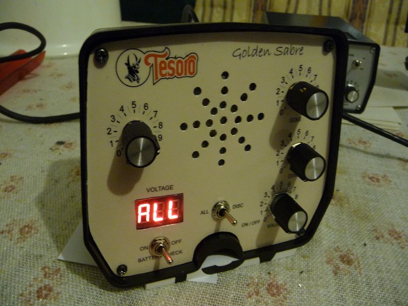

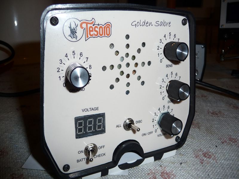

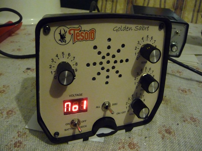

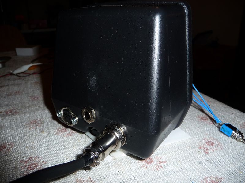

  • Hi all,

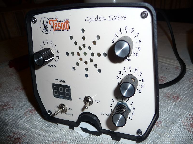

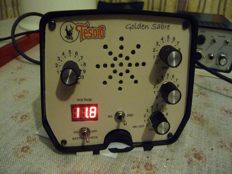

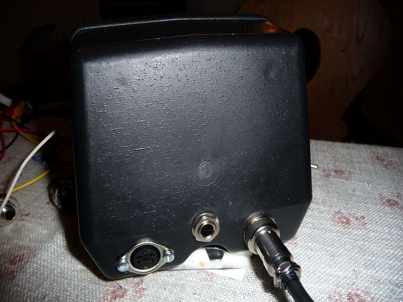

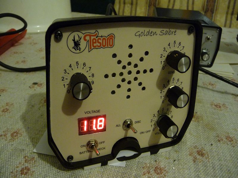

    here are some pictures from my TGSL with integrated Lipo Check System. Next time i will make a video on youtube ......
    Firebox
    • hi, really great job, congratulations. or did you get the box?
      • is very good. boxing has been superb in
        • Hi, I bought the case from Bernte_one (Member here on Geotech)
          The Kit was a test sample from silverdog.uk !!! Thanks Silverdog for this !

            How did you make such a nice control panel?
              I took a self-adhesive inkjet glossy paper and then I have printed the scale and logos on it. Background color is also like Tesoro
              • That looks very professional!
                What program do you use to create the art work?
                Thanks for posting the pics.
                Jerry
                • Originally posted by Jerry View Post
                  Jerry
                  Thanks Jerry,
                  the scales and fonts are made by @Bernte_one (member here on Geotech) I don´t know the name of the program. The Logos and Background are created by Adobe Photoshop .....

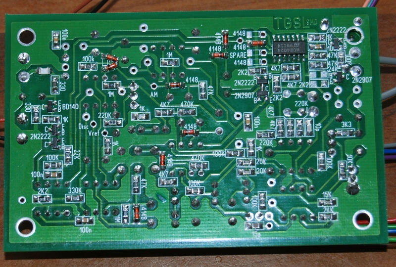

                        • Hi folks,
                          Please find below two pictures of the last release of the TGSL smd. Fully tested.
                          Some corrections and improvements have been done (no more links needed, 2 tones ready by adding several new pads).
                          Few PCBs are available, send a PM to Silverdog.
                          Enjoy it !
                          • Looks pretty cool that. Good effort.
                            Like the copper around the edge, would have been more effective if continuous - logo has opened the flood to a C shape.
                            Steve
                            If at all possible on one of the projects can the pots make it to the PCB edge - in order the user does not have to ad flying leads to pots.
                            • Hi golfnut,
                              I'm not sure about that.
                              In audio PCB, this gap is used to avoid what we call mass loop. Giving a background rumble.
                              That's why I leave this gap.
                              But, maybe I'm wrong with it !?

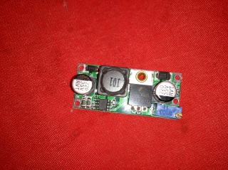

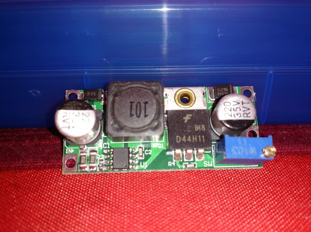

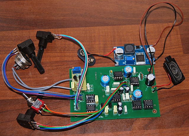

                              • Hi Hugo, you know how your installation uses with your little step-up card and how many batteries you use? 'cause I have a slightly different version of yours I put a photo. my editing step-up amounts to a little more than 130 mA with 3 V input and therefore 12 volts output, and about 100 mA with 4 cell 1.5.Click image for larger version
