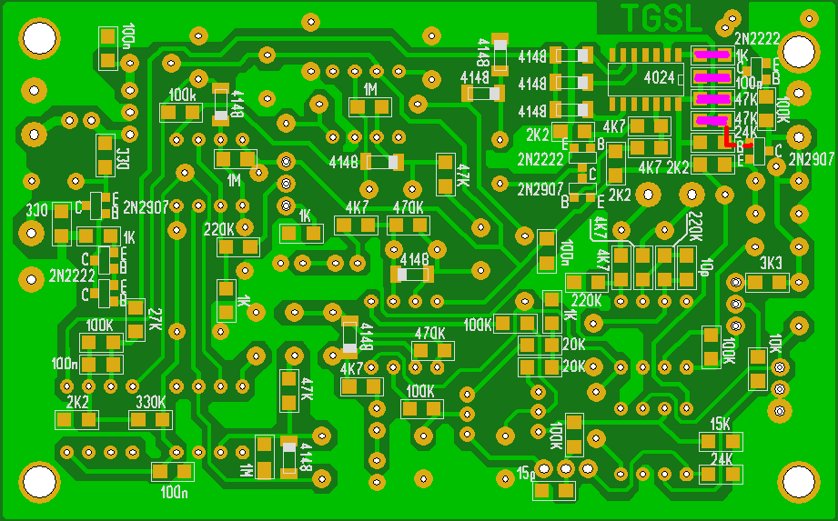

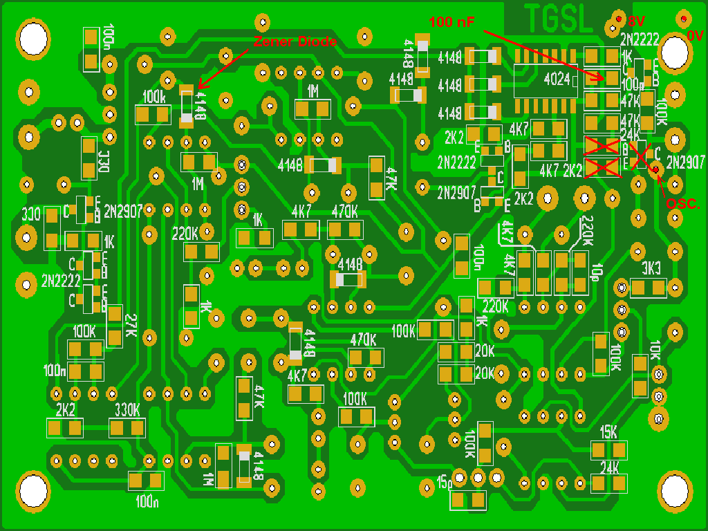

      • #93
        Hi Hugo,
        i have removed all IC`s from socket, but the oscillator doesen´t work. Can i have a closer Picture from your TGSL on SMD side? Which Capacitor do you have on RX and TX Side for your Minelab Coil??? I have the TS1000 Coil too.....
        The first picture shows the zener Diode!
        The last picture shows the 4 mounted components, but the last 47k is ending on Basis Pin from 2N2907 (see the red line) . Is this right ???? so if yes, the last 47k haven´t any function, because it have no electrical contact to the other components ....
        thanks

          Hi firebox,
          I'll send you a closer view in a PM.
          My TX capacitor is 300nF and RX is 10nF.
          Your right, the 47K resistor is useless.
          The minelab oscillator can works alone. It just needs to be powered. Connect your TX coil to it and you should see a sine wave signal at the TX pad.
          If it's ok, re-install the addon board on the main board and check if you can see this signal at the base of TR6.
          Now, check you see a square wave at the pin 1 of the 4024.
          Good luck,
          Hugo

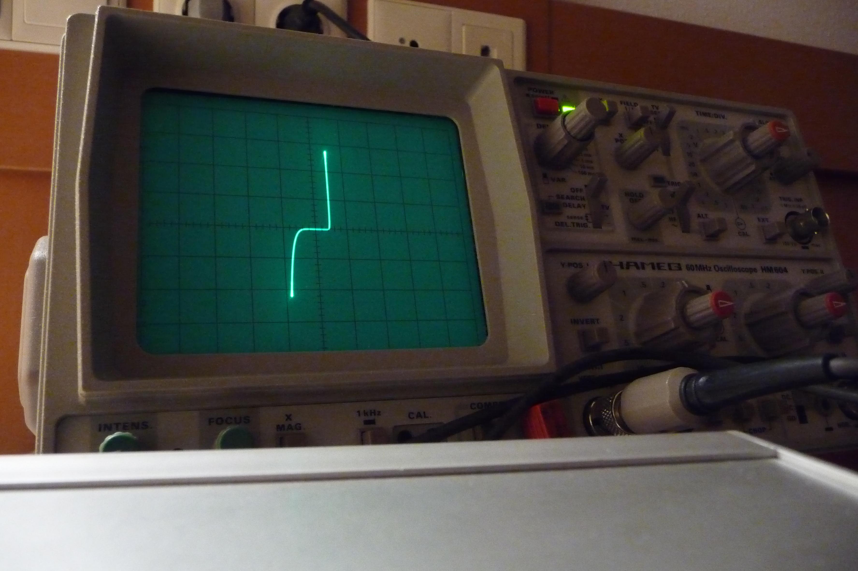

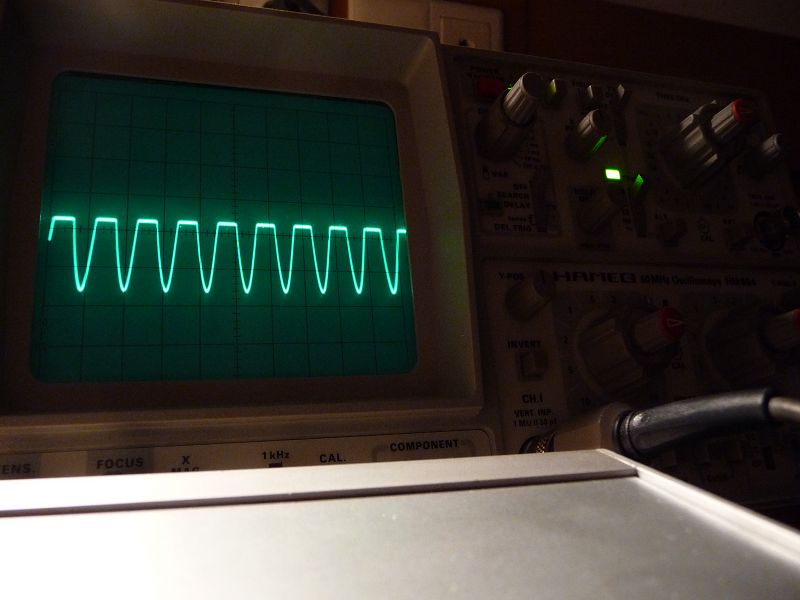

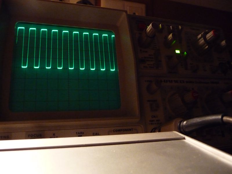

          • #95
            Hi Hugo,
            on OSC. PIN i have the 9Khz wave signal. After the 100k resitor i have the wave shown on the first picture and on picture 2 you see the wave from Pin 1 of the 4024
            • #96
              Originally posted by Firebox View Post
              Hi Hugo,
              The signals are correct. Now check if you have got square waves on the outputs of the 4024.
              If so, it should drive the negative voltage converter.
              Hugo
