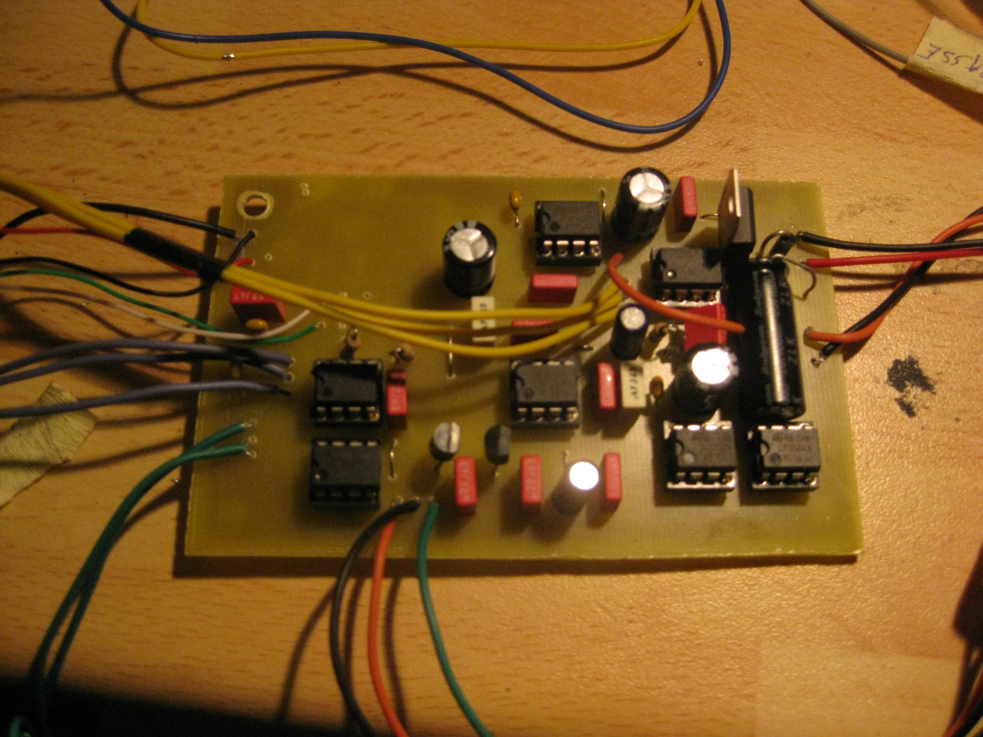

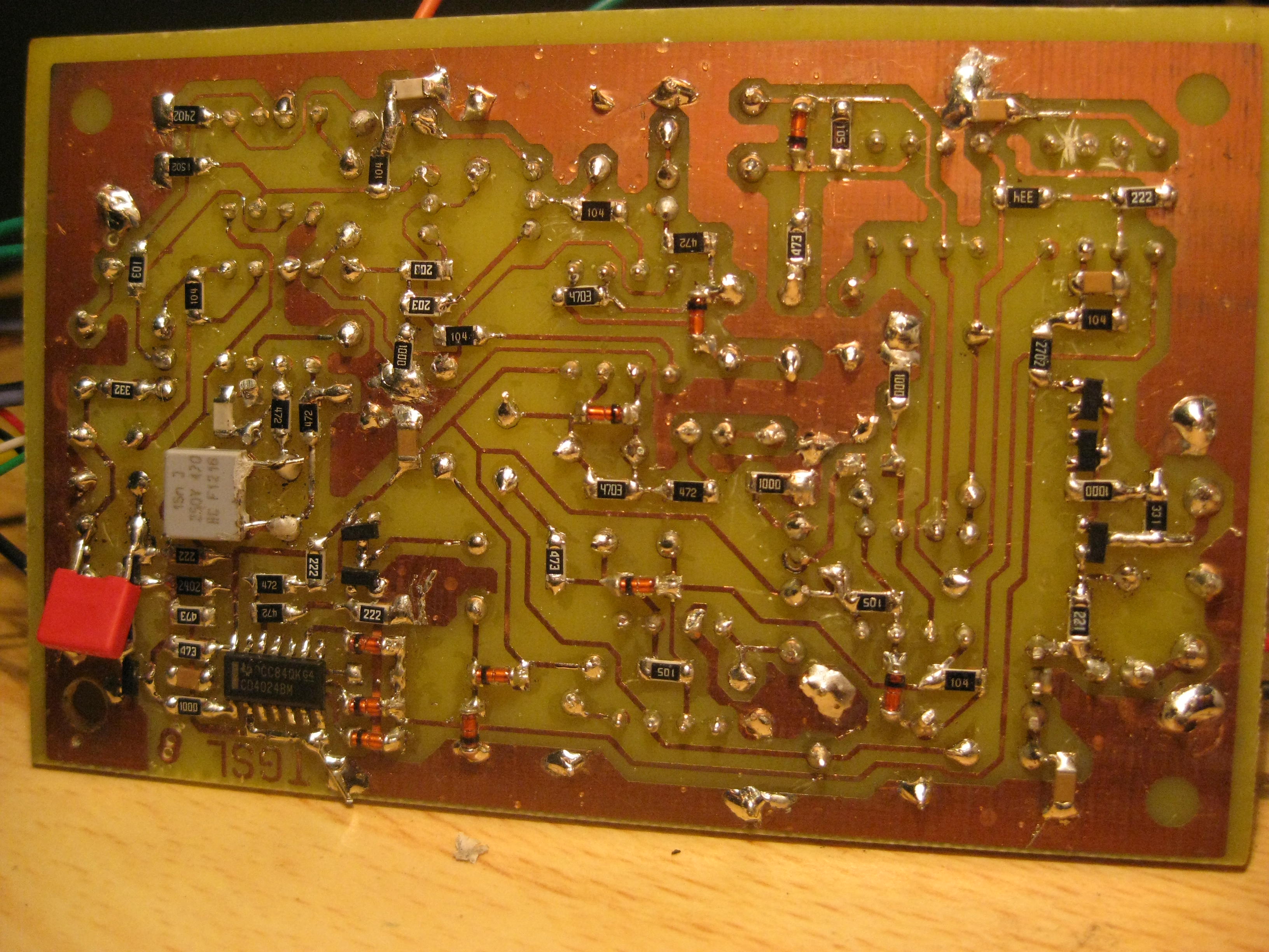

Hi all,

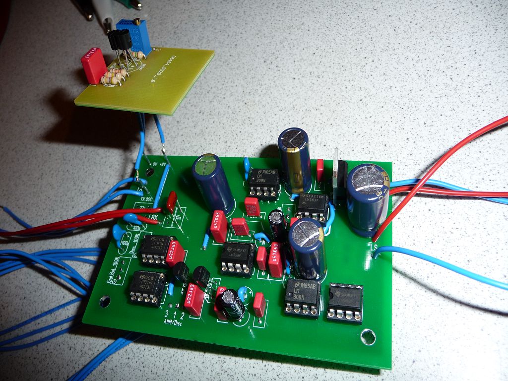

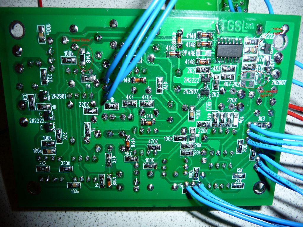

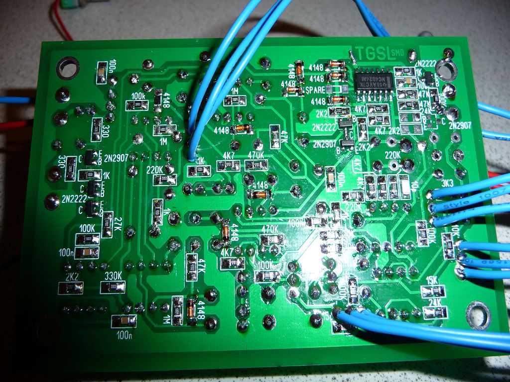

The smd TGSL is ok for me, I just solder the track that connects pin 2 and 7 of 4024.
Discrimination works flawlessly
I 14.4khz and I tested different capacitor value to check if there was not a more powerful alternative frequency as I reach for the moment +-25cm with a piece of 2 euro.

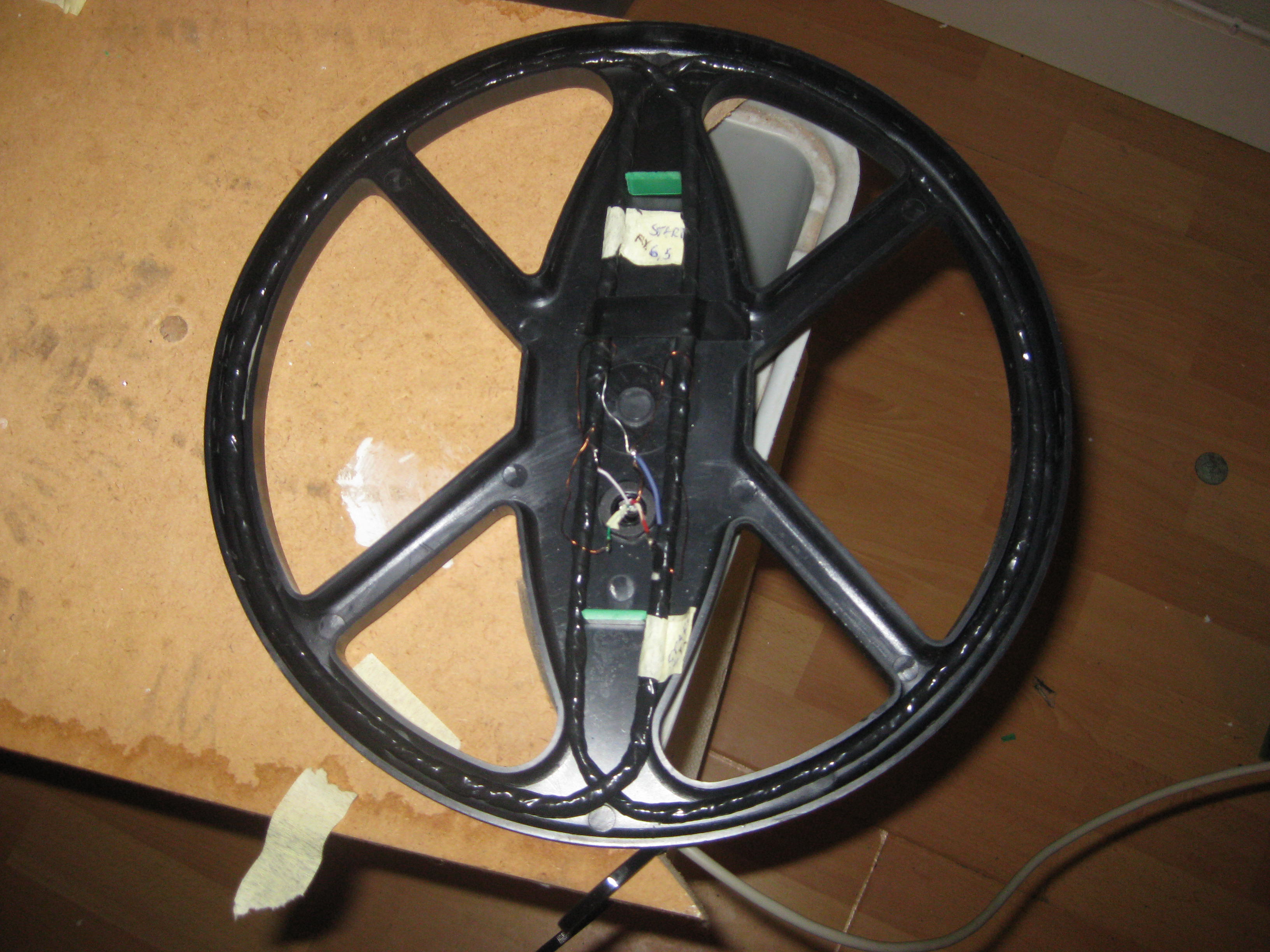

The coils are set at 20 ° with a phase meter.
My coils are a precise 6mh for Tx and RX for 6.5mh
In this regard, I post the RAR file in the phasemeter DVM rubique "IGSL TGSL" on page 67
Very practical, it's my new year gift for geotech
If someone can give me some advice to improve the power of detection ca me interested.
thank you
