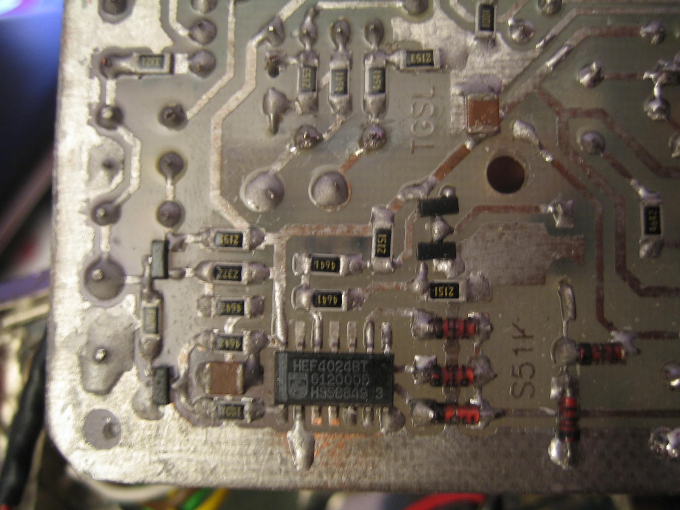

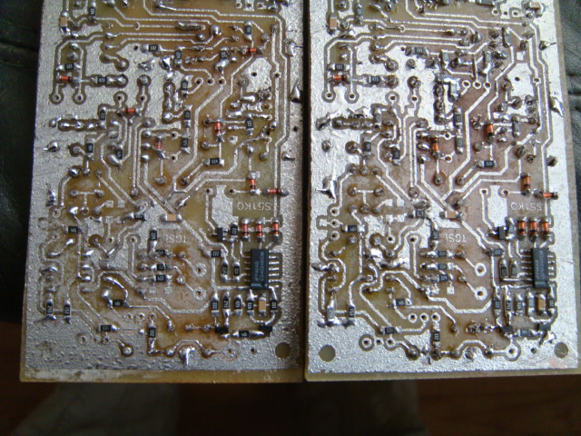

    Here are 2 photos of my card tgsl smd.Click image for larger version
ID:	333876Click image for larger version

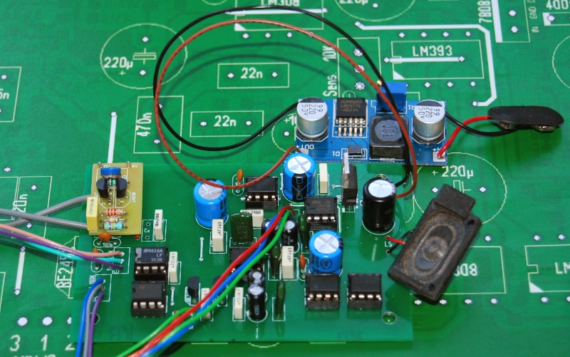

      • #63

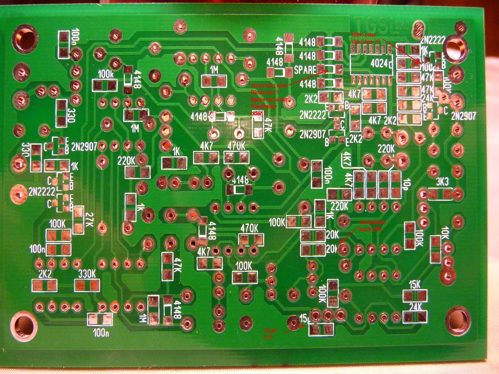

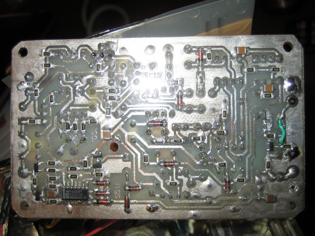

        hi, looks really good, especially the stylish housing, on board I do not see any big differences to mine, except the resistors, small tolerance values ​​and a few other.well I still got two boards, one of four is supposed to work wellClick image for larger version

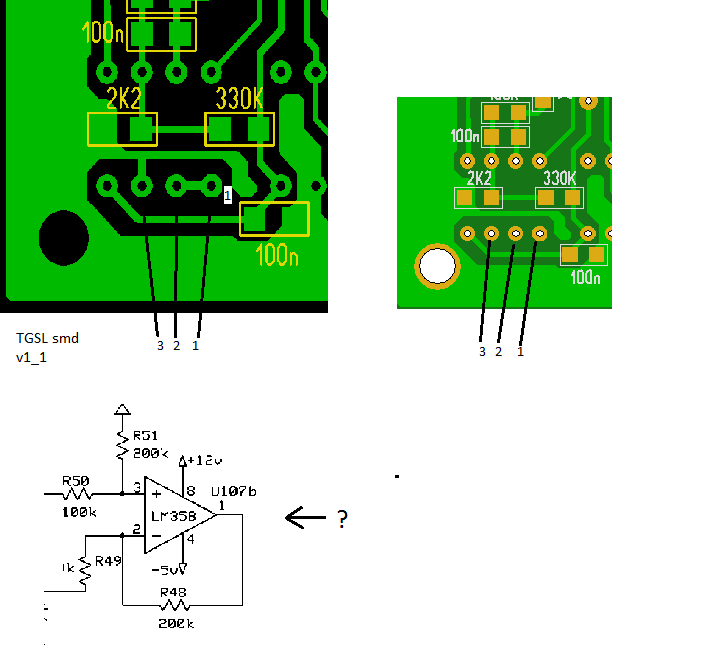

            Hello,
            can you tell me the connection of LM358 audio is good because I see differences connection to pins 1, 2, 3
            thank youClick image for larger version
Name:	QUESTION pcb TGSL smd.png
            • #66
              Originally posted by zoomix View Post
              Hello,
              thank you
              Hi Zoomix,
              Yes, it's correct.
              The part of the schematic you're talking about is the original battery tester. Not in use anymore.
              Anyway, a new release of the PCB very soon.

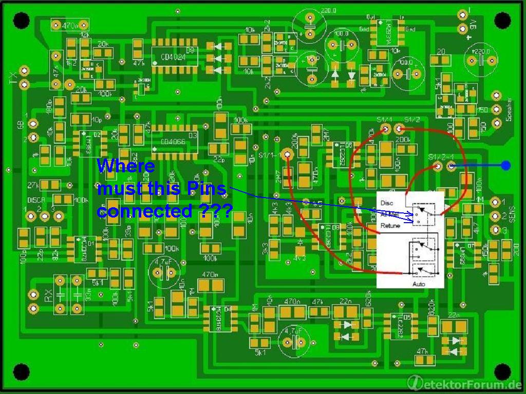

                  • #69
                    Originally posted by hugo View Post
                    If it can help someone.
                    NB : I don"t understand the reason of the hole by S1/2-1. The 100n cap must be ground ...
                    Hugo
                    Hello Hugo,

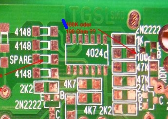

                    i don´t understand the Switch Connection on the Bandido SMD PCB. On your Schematic 2 Pins for Allmetal and Retune are not conneted to Board !? Which switch do you used ? maybe you can make a picture from the switch on your Bandido??
                    And other question is, what are the right parts on the TGSL PCB in the attachment ???
                    • #70
                      Originally posted by Firebox View Post
                      Hello Hugo,
                      Helo Firebox,
                      As I can see, Silverdog sent you a pcb of the smd version of the TGSL (This is a prototype board, not the final version).
                      By the 4024, the value is 100K (R8 ).
                      Yes, the value of the second resistor is 20K too (R25-R26).
                      The capacitor is 15p.
                      The diode noted spare can be used to change the audio tone.
                      NOTE : a link is missing in BLUE, please see the picture below.
                      It may be useful for you to have the TGSL schematic V3.
                      About the Bandido, there are 2 switches. One for AM/Disc selection (DPDT). Another one for Retune (SPDT).
                      If you look at my drawing, you can see a dashed line meaning that this is a dpdt switch.
                      Good luck,
                      Hugo

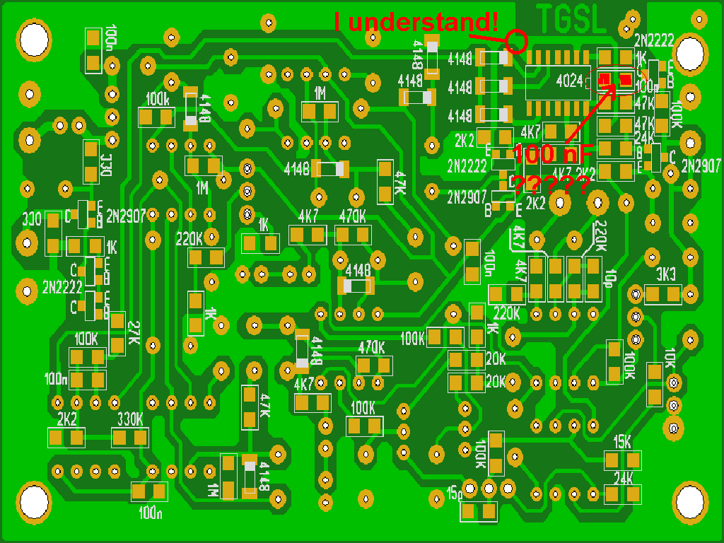

                      • #71
                        Hallo Hugo! Thanks for Info! Yes it is a prototype board (i know) i see what you mean with the blue link. Should i know something else about the prototype PCB ? other Mods or something? When i look on Post #56 I belive the part must be a 100 nF not a 100 K right??? look a the attachment. And can I use one 4,7uF "bipolar" capacitor instead of 2 x 10uF Elkos ??
                        And on the other picture, you see what i mean about the Switch connection to Bandido SMD.
                        Many thanks!!
                        • #72
                          Many thanks!!
                          Hallo Firebox,
                          Ya, Sie haben Recht !
                          This is not a 100K resistor but a 100n capacitor. Well done !
                          Of course, you can use a 4,7µF bipolar capacitor.
                          One more thing you have to know, you may have to change the 1N4148 diode (D12) with a 2V7 zener or two 1N4148 in serie (Red Arrow).
                          There is also three pads if you want to use the minelab coil addon card (Red spots).
                          About the Bandido switch, NO, theses pins don't have to be wired. See the bandido schematic in the attachment.
                          Grüß gott,
                          Hugo

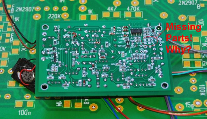

                          • #73

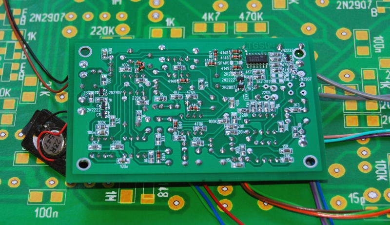

                            Hello Hugo,
                            thanks für the info!!
                            So i belive i have note all Mods
                            Last question, why you have omitted some components on your PCB shown like on the picture below? Maybe these parts can be omitted if i use the IGSL Musketeer Coil ???
                            au revoir
                            • #74
                              Hello Hugo,
                              au revoir
                              Hallo Firebox,
                              That's right. As the Minelab card is mounted, some components have to be removed.
                              Auf wiedersehen ,
                              Hugo
