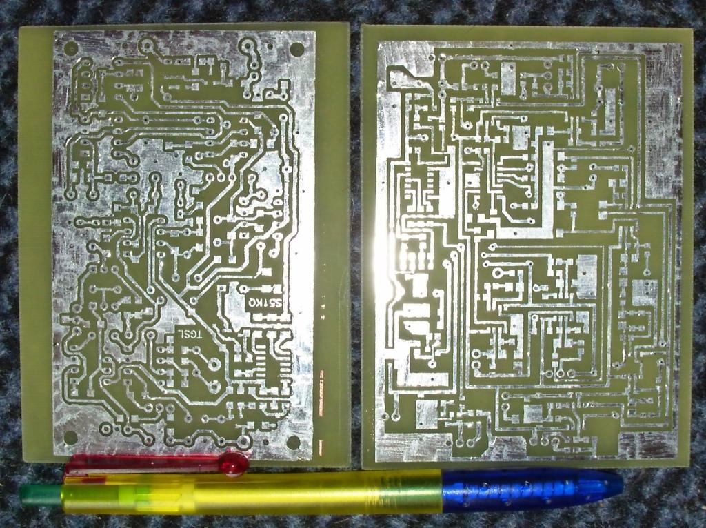

              hello
              i have this but not sure in the right type of smd transistors
              think they work but until i have not finished or see any video from somebody its not prooven
                hello
                [ATTACH]20567[/ATTACH]

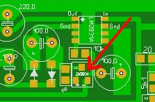

                                @bernte_one :
                                There is a mistake on the Bandido pcb.
                                The negative converter transistor is labeled 2N3904 instead of 2N3906 (Should be a PNP transistor, 2N2907 works too).
                                Hugo
