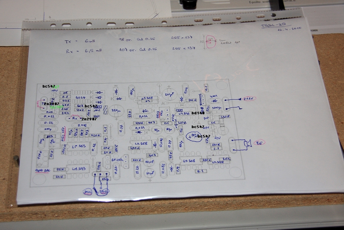

      the transistor assignment would look like?

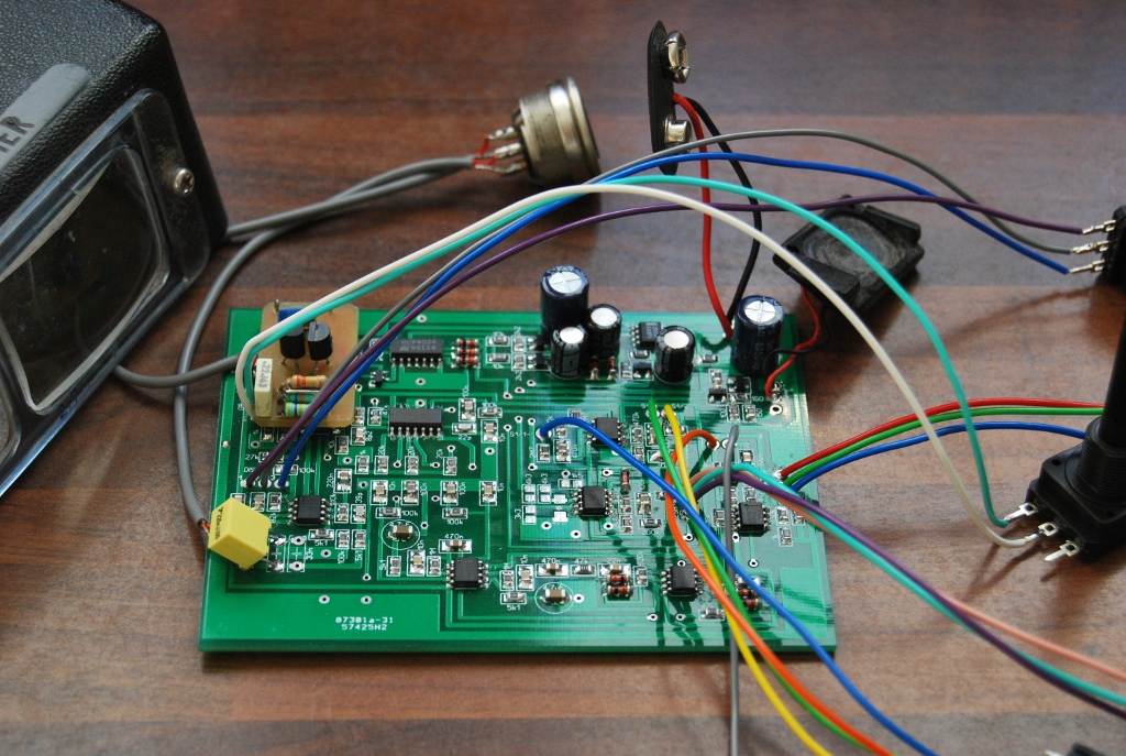

        My Bandido pcb is almost finished.
        It works quite fine with a FBS1050 Minelab Coil.
        But I just to adjust the RX capacitor tank. I'm a little out of phase.
        The only error I've found is about a transistor label. See previous post to Bernte_one .

          hi Hugo, great job I see that you added a little card with two transistors, it used for? I had this detector, the discrimination is really not bad, I thought it lacked a bit of power but like many Tesoro.

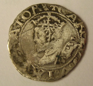

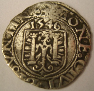

            hi all the world, I want to show you a nice little find with TGSL SMD VERSION. Here is a beautiful ridge carolus dating from 1546.

              nice find , well done, finds like that make it all worth while.

                  Thanks. A magnifier is really needed to do the job.
                  Very nice find. Keep going.
                  This is the TGSL add-on card.It's to make it works with my Minelab coil. (Ivconic's mod).

                    May try one of those, im ok changing smd when required in my work place, but actually making a project out of them would be my first, matter of interest how much did it cost you to build?
                      Not much. About 50 € (Board only !)
                      Silverdog asks for volunteers to test the board, so he sends me a free board.
                      The SMD passive components were bought from China on ebay (7 Euros).
                      Most expensive parts were the Op Amp. 2262 and 33178 (1€50/ea and 2€30/ea) from http://www.electronique-diffusion.fr
                      Hugo

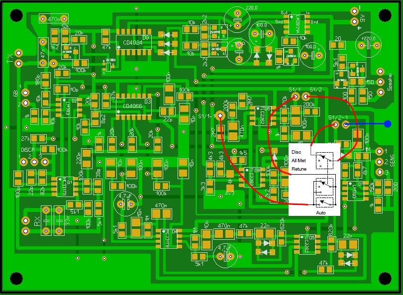

                            If it can help someone.
                            NB : I don"t understand the reason of the hole by S1/2-1. The 100n cap must be ground ...
                            Hugo
