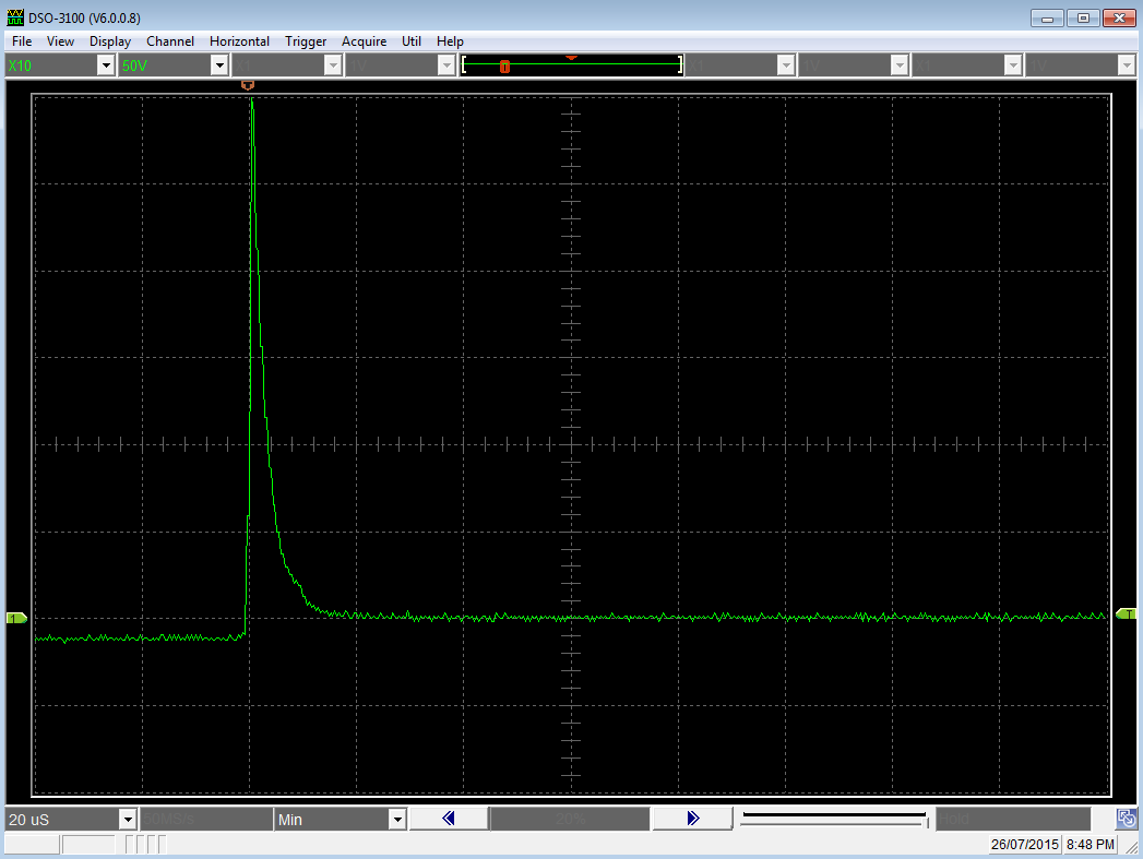

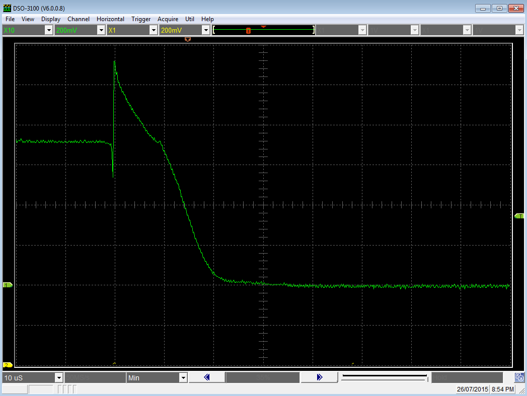

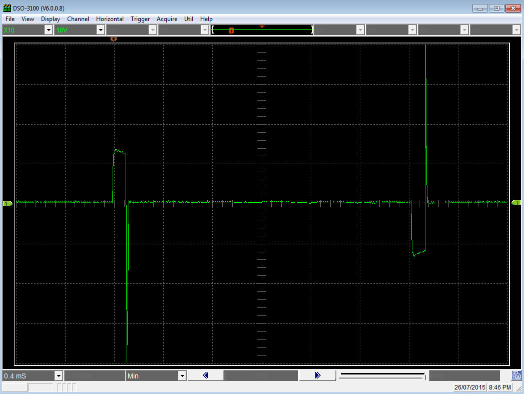

    Bipolar pulse, interesting ! Do you have any scope shots showing tx in action ?
      Scope shots
      Attached is scope traces:
      1. Pulses train across the coil
      2. Close up of single pulse at coil.
      3. Pulse at Test Point 5, before the amplifier.
