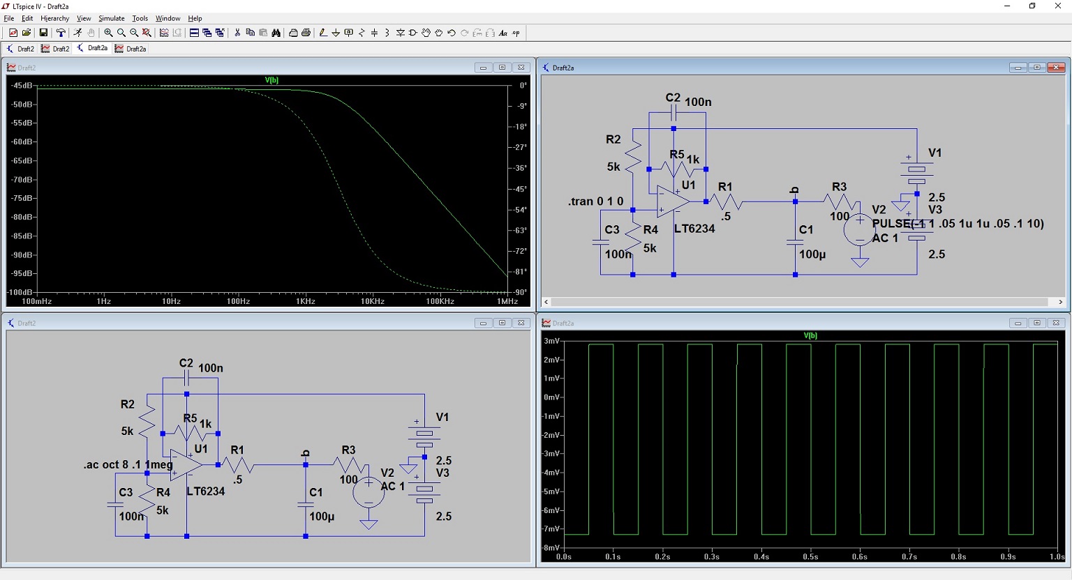

    Been thinking of trying a TLE2426 for my detector. Did a circuit in spice to try. Change in volts equals change in current times R1. Used a LT6234 to simulate, need to find an available 0Pamp that can sink and source ground current and doesn't oscillate with a low R1. Probably there is a better way.

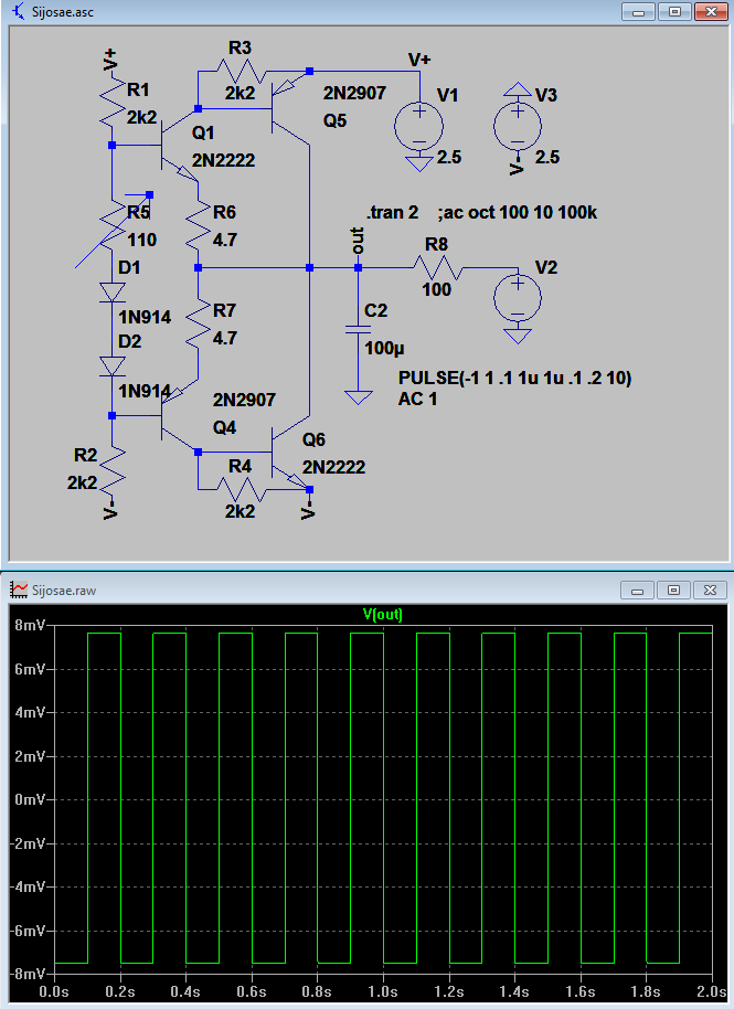

      OK, so you think you need a virtual ground at about 1 ohm impedance? Well, Sijosae splitter was not intended for such low impedance, and perhaps you actually need it that low, but with a little care most probably not. In case you are a noise freak, a slight complication of a basic Sijosae circuit may do precisely what you need, like this
      It runs with a quiescent current you may set with a trimmer, and at 1mA it gives below 1 ohm, and below 5nV/sqrt(Hz) noise.

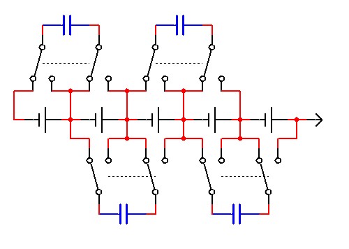

        This is a basic idea:
        And you may find a practical design for powering something much more powerful here: http://www.mtukrc.org/download/clark...paper_2009.pdf (1.1MB)
        There are also a single capacitor versions that are just as good. Benefits of such balancing is more capacity.

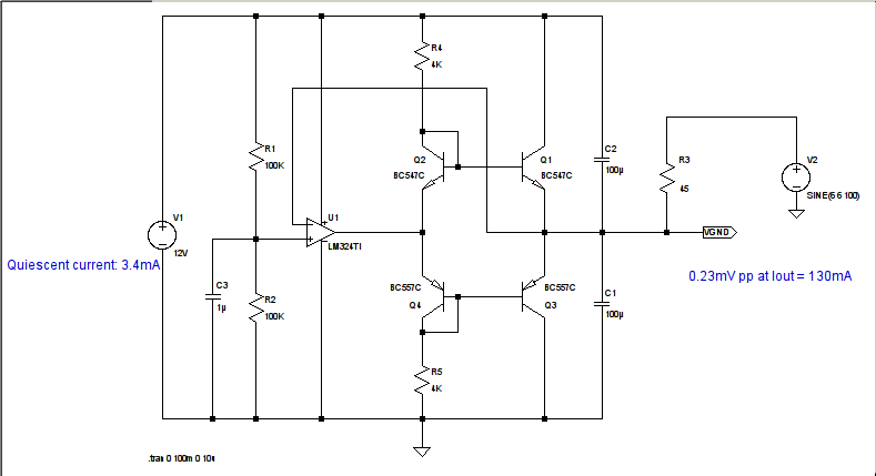

          Here's a regulated rail splitter with 3.4mA quiescent current and a ripple of 0.25mV for a current of 130mA.
                              [ATTACH]34516[/ATTACH]
                              [ATTACH]34515[/ATTACH]
                              Have you built this?
