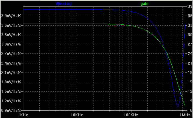

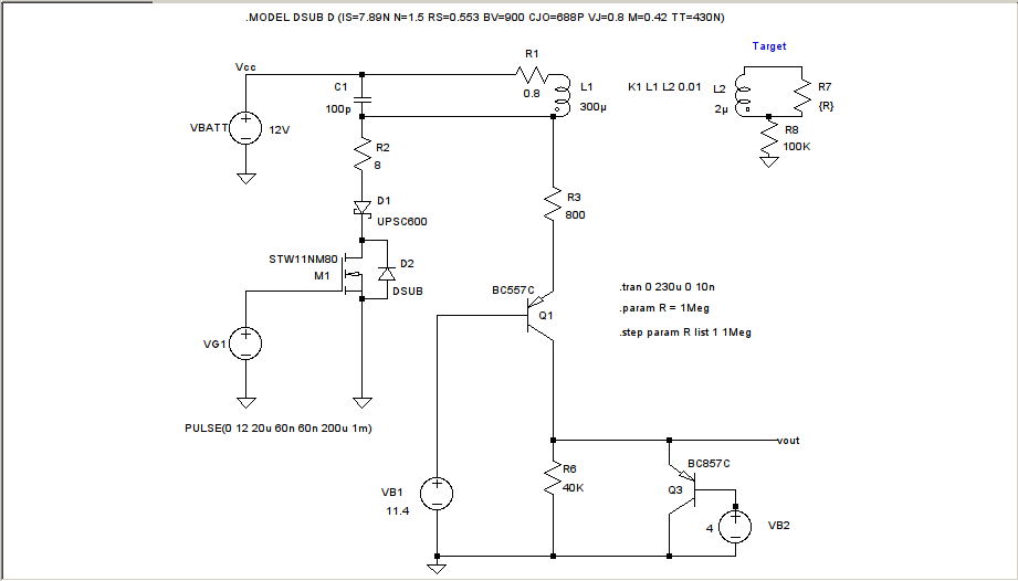

        Common base amplifier, gain is Rc/Re, where Re is valued fo critical damping
          I tried what Davor said with a Bss127 and a FDV302. Couldn't get it fast enough, maybe someone that knows what they are doing could help.
            Common base preamp:
            PI_common_base.zip
                That's spot on - you can't get input noise below 3nV/sqrt(Hz) with damping resistor connected in series - regardless of the amplifying device's capability to go much lower. 1nV/sqrt(Hz) corresponds to ~60 ohm, and that's too low for a meaningful damping resistor.
                Going down with noise will require a non-inverting op amp with some sort of blanking/clamping device. Alternatively it may be a FET or a transistor, but with no capacitors in biasing circuitry to avoid long recovery. It is much easier and cheaper achieving below 1nV/sqrt(Hz) noise with discrete devices, but I have no idea what role may non-linearities have in PI. It is quite simple to demonstrate importance of front-end linearity in VLF, but things are not as straightforward with PI. Intuitively I'd say linearity must play a role in early sampling, but I may also be wrong.
