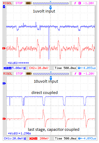

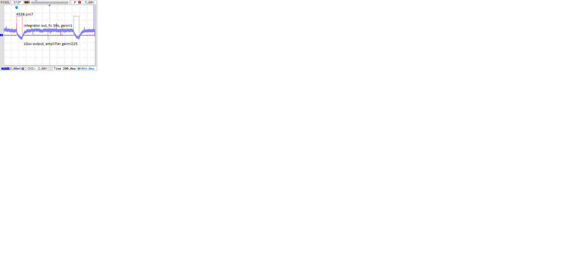

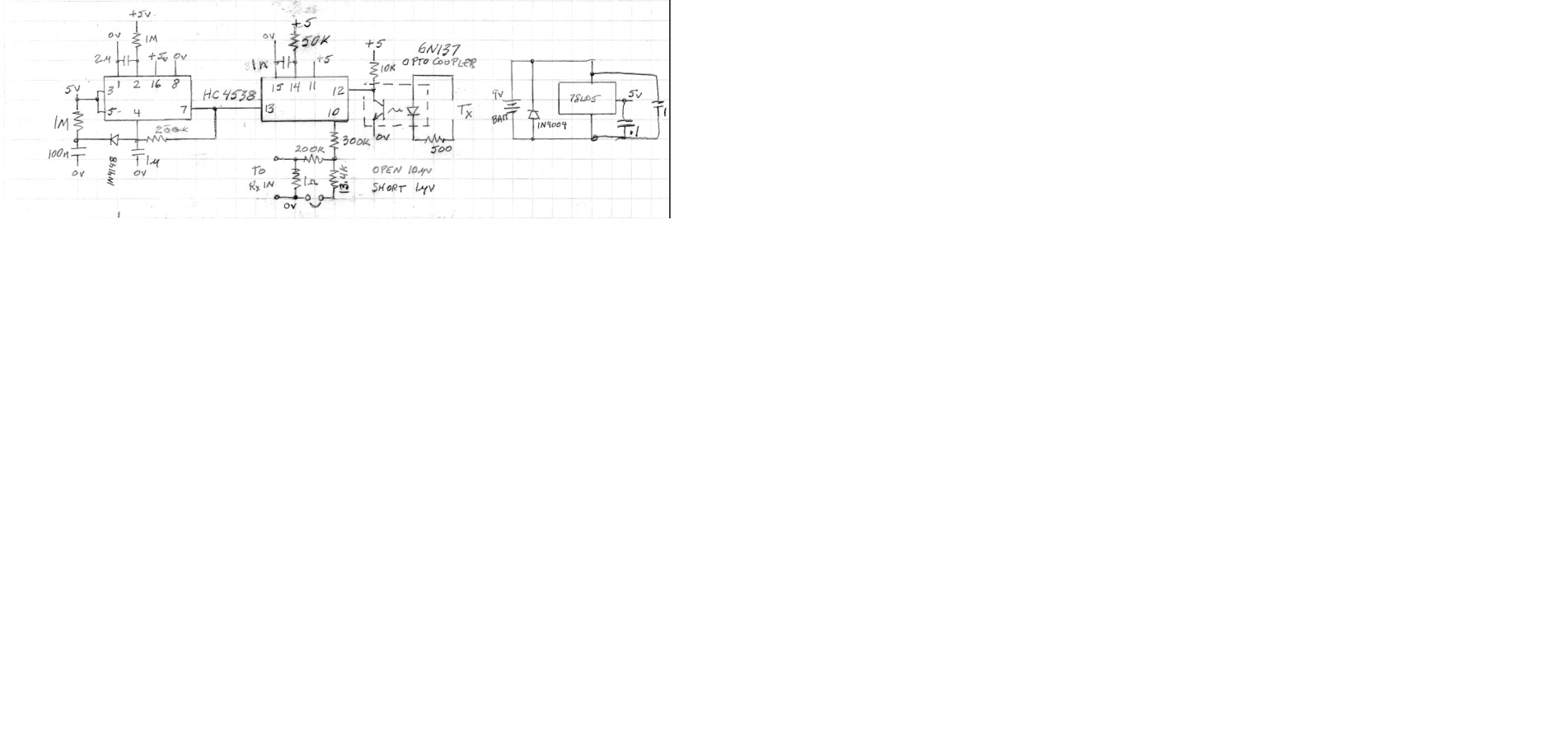

              My thoughts on signal to noise, hope some are close to correct. First, need to compare peak to peak not RMS. Sweep coil over target and miss the next sweep. Have a pulse .1 to.2 seconds long. RMS is going to approach zero. Peak to peak white noise typically 6 times RMS. When does the target signal disappear. Searched minimum signal to noise, 3 to 1 was a suggested value. Example: scales, lsd 1 gram, noise 0 to 5 grams. Add 5 grams, displays 5 to 10 grams. If the weight was added and removed when the no weight reading was 0 the reading would be in the noise band. Signal needs to be greater than noise to have signal reading greater than noise reading every time. 3mv noise doesn't tell me what I need to know. Eric was probably referencing a test point on a particular detector which would if I could calculate the gain. Noise and signal should be referenced to the input(coil volts). I'm thinking if I could detect a 1 uvolt change in coil volts that would be good. Did another schematic for a 1 and 10 uvolt test signal. Reply #67 didn't work, missed the obvious reason why. Appreciate comment if I missed something this time.
              Tried the circuit. This one worked. Looks like the 3Hz integrator filter is to low. Need to work on the amplifier noise. New schematic(gain jumper wrong on 4538 noise test_2)
                Tried a differential amplifier and different integrator. How low a noise level should we expect?
