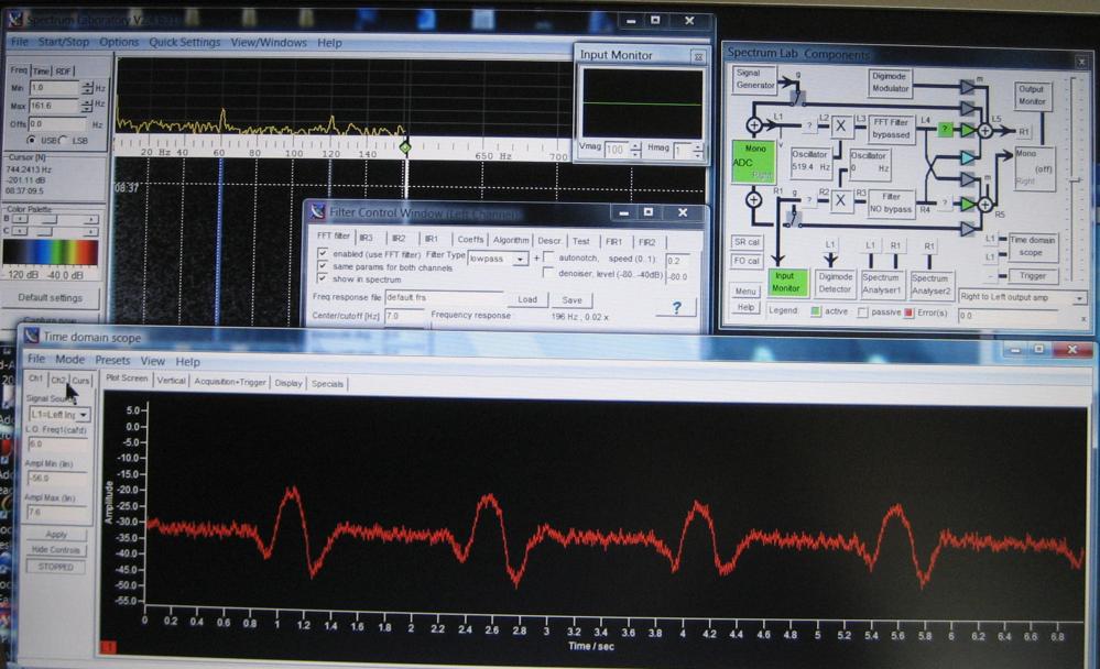

    Some years ago, I used SPECTRUMLAB, to look at my signal. Attached is a screen shot. You can see the FFT. It shows distinct noise at the 60Hz mains and 120Hz harmonic.
    Unfortunately, as it uses the sound card of the computer, it's frequency range is limited.
    I am going to search for this software again, hope it works with Windows 10.

        Spectrum Laboratory for Soundcard with Waterfall and FFT.
        try here
        • #79
          Thanks, I got it and it seems to work fine on Windows 10

              FFT usage and hints
              FFT's are a mathematical way to convert from time domain (amplitude vs time) to frequency domain (amplitude vs frequency).While these are just different views of the same signal (object) each domain has advantages when it comes to looking for different things. If the signal is complex waveform it is difficult to decompose it into the various frequency components. In the case of our PI's the signal is ideally a rectangular pulse of width t. The Spectrum of this ideal pulse would be a Flat line starting at DC with the first zero in the response at 1/t. There would be successively smaller cosine shaped humps after that and successive zeros in the response at 2,3,4,5...times 1/t.
              There used to be some great online calculators to help you visualize what any time domain signal looks like in the frequency domain. I suggest you do a google search for fourier component calculator to find one that works it's your computer. This wil help give Aquino understanding about how FFT's work. A general search for FFT's yields lots of information but much of it is very math heavy.
              However there are few basic rules for using the FFT's in any device, like a scope that has this function.
              1. Time and frequency are inverse domains so good time resolution wil give poor frequency resolution.
              2. Set the scope record length to around 10000 points.
              3. Set the sample rate so that it is around 4 times the highest frequency component you expect to observe. For example if you want to look at all the noise coming out of the first stage of the preamp and want to see all the signal to say 250Khz set the sample rate to 1 Ms/S.
              4. Make the signal fill the screen vertically to the extent this is possible.
              5. Turn on FFT. You should see a signal in the frequency domain. Many scopes will allow you to place cursors on the spectrum and measure amplitudes at various frequencies. Use haning or hamming windowing if this is adjustable on your scope and if the signal contains periodic components. No windowing is necessary if the signal contains broadband noise.
              6. You may have to adjust the sweep speed slightly to show the best frequency domain detail.
              7. Since FFT's are just mathematical transforms of the time series of the data they have limitations.
              a. You wil not be able to se signal frequencies higher than 1 / sample rate. ( 1 MS shows signals up to 500KHz BUT it is best to ignore anything great than 250 KHz in this example)
              b. The best resolution you can get is the sample rate /2 / .5 times the record length so with the setting above this becomes
              1MS/s / 2= 500KHz/ 5000 points = 100 Hz. So with thes setting it would not be possible to differentiate the difference between 50 Hz and 100Hz, they would just blob together on the display.
              c. The best vertical dynamic range you can get is approximately 6 x the number of bits your a to d converter has ( 8 or 48 dab) in a general purpose scope.
              Using a sound card with a PC can give much broader range in amplitude but not in the frequency range since most sound cards are limited to 96KHz sample rate and give a frequency range of 48KHz. This is usually adequate to look at the output after the integrator since it severely band limits the signal. I use a pice of great software from Croatia cal ARTA. Even the free version if fully functional except you can not save waveforms or spectrum displays.

                that is nice software. It will also let you try out various filters and see the effect on the noise.
