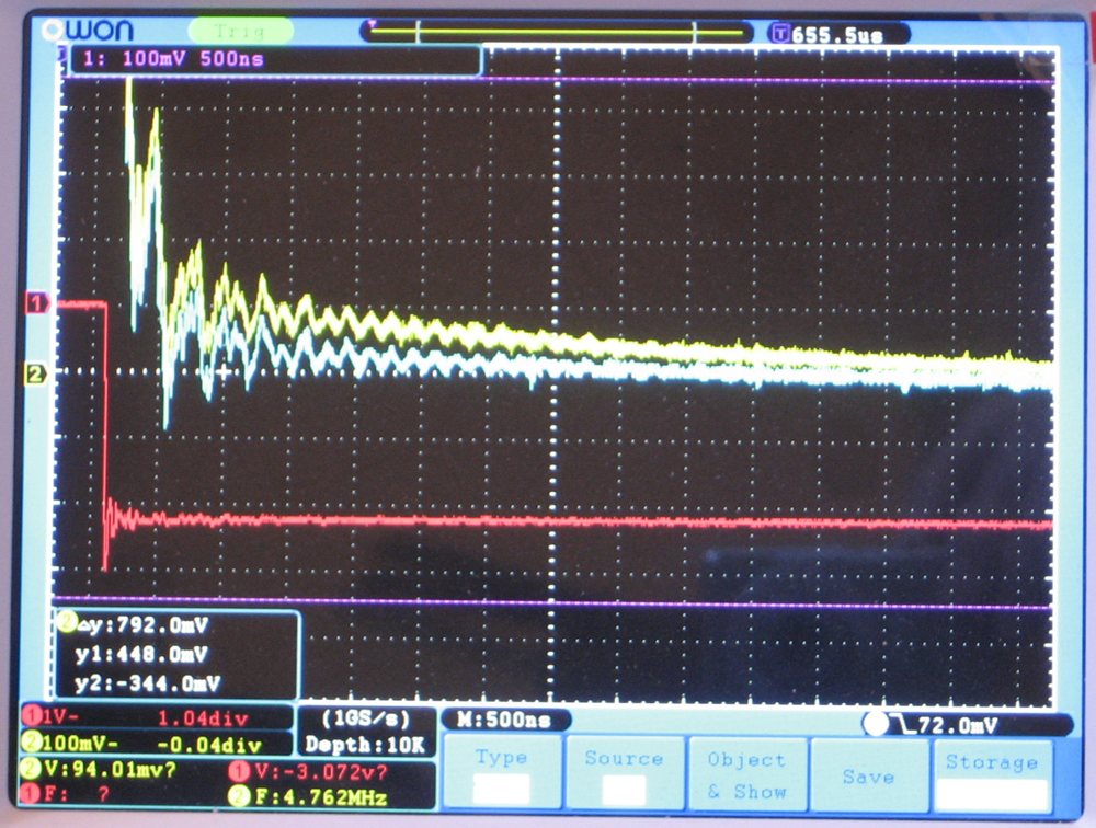

Tinkering with coils, specifically trying to build a large fast coil.
This TX coil has a diameter of 1 meter. Balanced RX coil.
The picture shows the scope set at 500ns
The red trace is the TX switch OFF
The blue-white trace shows no target
The yellow trace shows a foil target.
I am quite happy with the coil arrangement, however, I also have a problem that I need to resolve:
We see on the red trace some switching noise oscillations. These oscillations have propagated to the battery ground and of course get amplified in the pre-amp.
The system is soldered on perforated board, so now I want to hunt down the exact sources of the noise so that I can eliminate them when designing the PCB's.
Any suggestions are welcome.
