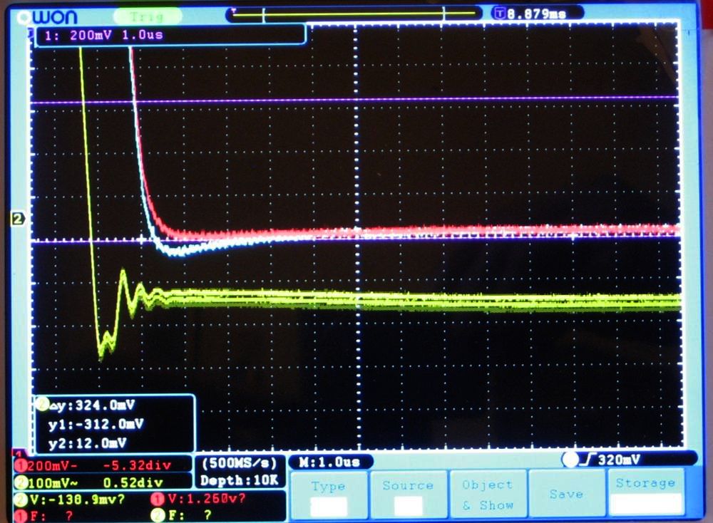

            2.5us sampling at 9 Amps
            Cleaned up a bit.
            Added some ferrites and AVX capacitors to power supply line.
            Added HF snubber to TX, but it is not perfect yet as you can see by the Mosfet oscillations at the end of the TX pulse.
            Yellow trace, end of TX
            Red trace - foil target with a TC of about 2us. Trace at input to ADC
            blue-white trace no target
            This is with the 1meter diameter TX coil and a coil current of 9 Amps.
            • #51
              Now in retrospect, I think my recommendation to use a ferrite bead on source lead was misunderstood. I meant to literally put a ferrite bead on a MOSFET source lead.
              The other thing I can think of regarding the supply line is, in case you are using a LDO or 78xx regulator, or any fast regulator, to never use low ESR or low inductance elkos as post-regulator filter, as these tend to cause a regulator to oscillate. It is an odd effect, but well documented at DIYaudio.
              • #52
                Thanks for the help.
                The noise on the initial picture had several different causes.
                A silly mistake of mine, was to use a 12" ground lead on the scope probe. It made it easy to reach the test points without changing the probe ground clamp, but it is amazing how much noise 12" of straight wire can pick up.
                Another problem was the noise picked up by the battery and other wires. The most worrisome noise being on the battery negative terminal - system ground. The ferrites and bypass capacitors did help.
                Filtering the signal, LP at 1MHz, helps with the noise, but increases the delay. However, it is not clear yet how much the target signal loss it causes, because the LP filter reduces the very early peak signal of very short TC targets, but also integrates the signal, so that the integrated signal, 3us integration, may show little loss.
                The real problem that still exists, is the Mosfet oscillation at the end of the TX pulse. Adding a ferrite close to the Mosfet lead might help. I will try.
                I have added a snubber for that HF oscillation. It has helped some, but it is probably not well calculated. This is where I want to concentrate my next effort.

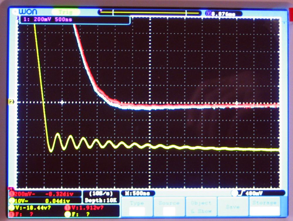

                          2.5us sampling
                          thanks for the help everybody.
                          Making progress.
                          Yellow trace end of TX, 9 Amps peak coil current, took air signal, so it was moving a bit, but you can see the effect of HF damping.
                          Blue-white trace, no target
                          Red trace, foil target.
                          Now I need to draw the schematic and see what I actually have here. Added a 0.8uH ferrite, but this increased the oscillation. Then added a AVX 10uF decoupling very near the Mosfet and then a 0.47uF tantalum next to it and that did it. Still got the first snubber in place, so need to sort out what the real snubber is.

                            • #59
                              ...Added a 0.8uH ferrite, but this increased the oscillation. Then added a AVX 10uF decoupling very near the Mosfet and then a 0.47uF tantalum next to it and that did it.
                              So it is in the end simply a protoboarding problem.
                              • #60
                                Yes, so I learned something about the importance of proper layout, when working with pulses of 10Amp current.
                                Many thanks to all for the good advise.
                                The foil is several pieces of about 2" square, to obtain a target TC of somewhere 1us to 2us. The Opamp gain is about 8.
