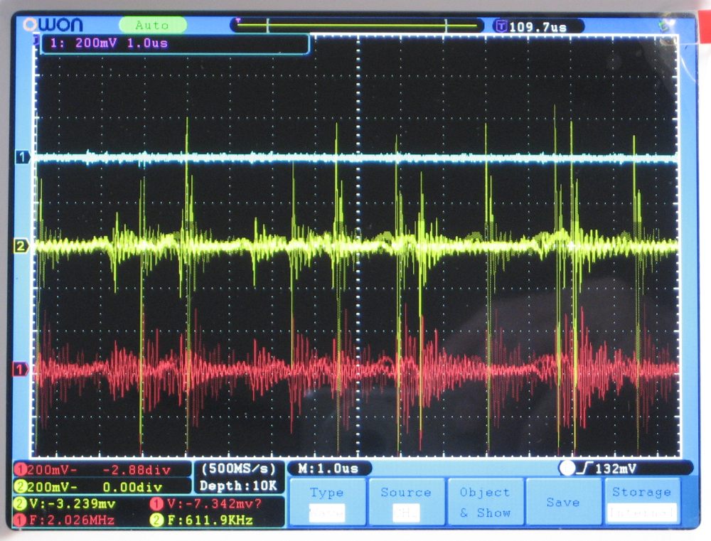

    Attached is today's noise picture, #2. Same picture as the first noise picture, same target, same distance. I think you can see significant improvements.

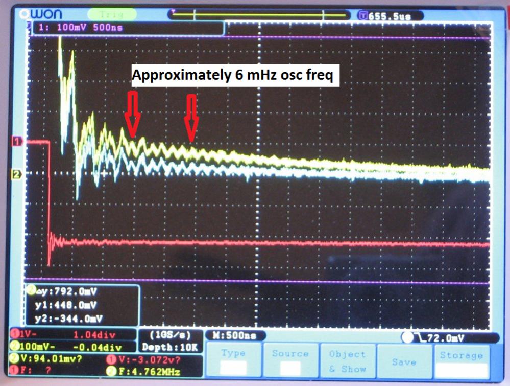

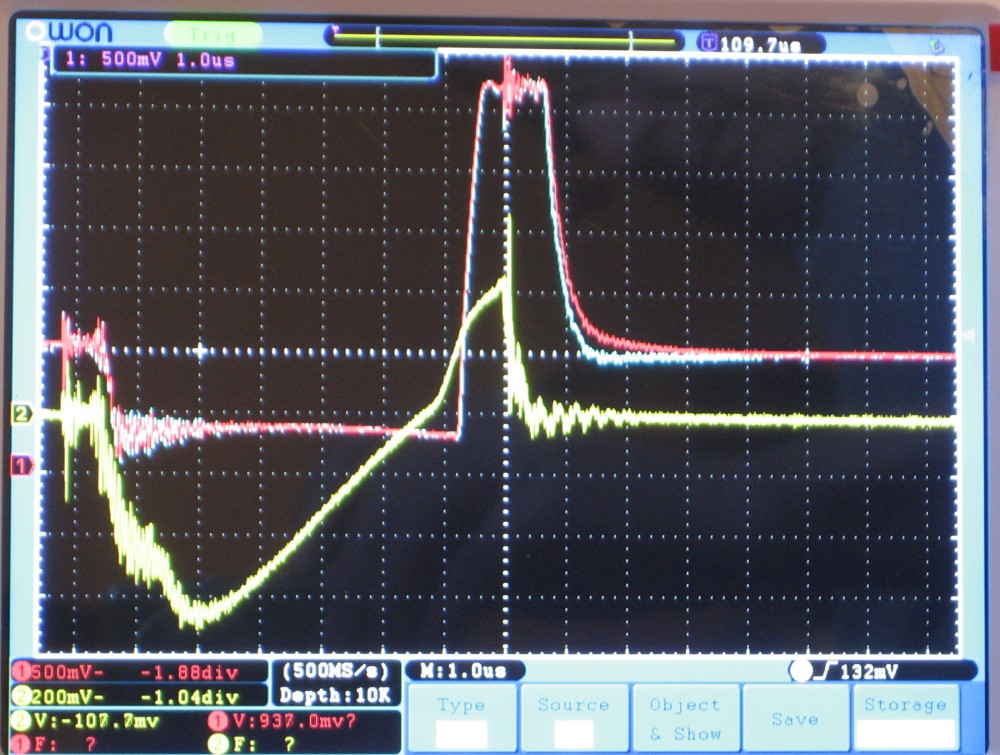

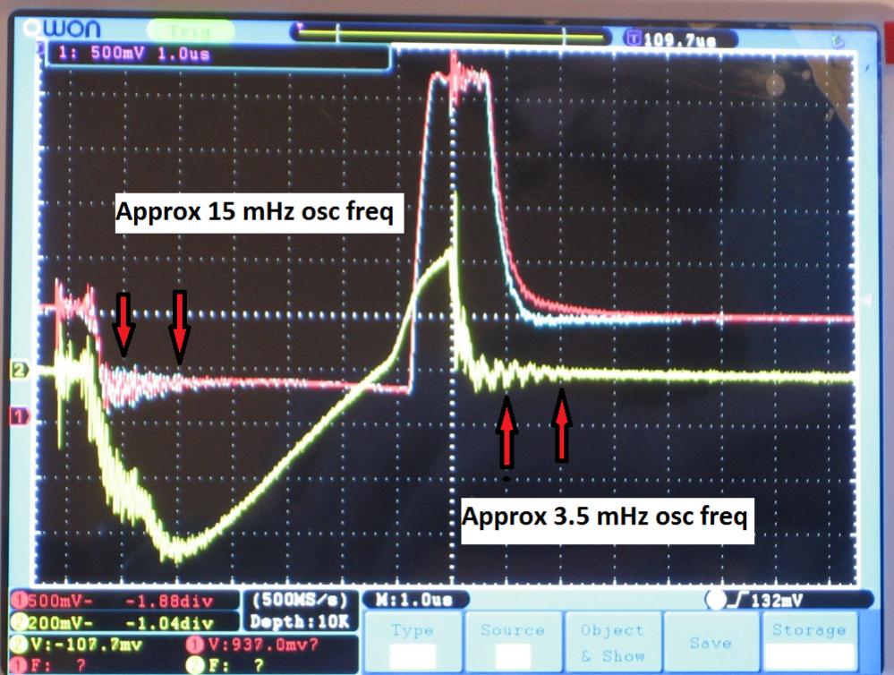

        Hi Tinkerer
        Looking at the power noise it has a very high oscillation frequency of around 15 MHz. This could be related to small diameter wires and the layout on your proto board. It might be worth a try to take the MOSFET circuity off of the proto board and wire it directly using heavy short conductors. The addition of .1 uf capacitors such as suggested above by CAS is standard practice. In this case for 15 MHz you might try smaller values such as .001 uf.
        The 3.5 to 6 mHz oscillation in the receiver may go away when the 15 mHz is cured.
        Thinking ahead the layout of the PCB should have heavy runs and as much ground plane as possible for the transmit area.
        Have another good day,
        Chet

          Assume tinkerer that your using a mosfet for
          The switching,
          And at half a micro second it's switching very fast,
          Try a 220 ohm or so between gate and whatever your
          Driving it with.
          Just thinking a while back I had a noise issue
          When driving a coil // mosfet to fast resulted in
          Noise at the peak of the flyback,
          A 220 ohm was just enough to stop it.
          Not sure about what circuit your using but wondering
          If noise could be migrating down and causing a problem.
          Loads // high voltage on a mosfet do affect the gate.
          Just a thought.

                  The noise:
                  At present we are using an ADC that samples a sample width of about 2.5us. The noise is not visible at all after integration. However, the plan is to sample with 500ns, so I need to eliminate the noise.
                  There are many sources of noise in this circuit. My goal is to tackle them one by one, starting with the switching noise caused by the TX board. So I will disconnect all other parts and show only this noise.
                  The next thing I will try, is a snubber designed for the frequency in question. HELP WITH THE CALCULATION OF THE SNUBBER PARAMETERS would be very welcome.
                  Ah, the coil assembly itself. No, this coil is not yet cast or shielded. Been trying to decide if I add a turn or take a turn off, but otherwise it is ready for sealing. Also the coil cables are the full length, twisted pairs, without shield. Might want to shield them though.
                  Thanks for all the help.
                    this picture shows:
                    blue trace, no TX running, PSU and analog board connected. All 3 traces look the same low noise.
                    Red trace, RX coil input, disconnected from board, with PSUand analog board disconnected.
                    Yellow trace, input to TX board, with PSU and analog boards disconnected.

                      Hi Tinkerer
                      I am trying to understand your findings here? Does this test indicate the noise is from the power supply or from external noise in your work area?

                              Hi Tinkerer
                              Chet
                              Thanks for the feedback. So far I can not see any noise from external sources. The noise from post 39 comes from the LPC2148 that we use for the ADC, timing and writing to the SD card. This board also used most of the power.

                                Sorry about the mix up. The schematic I posted is the way the final PCB is projected. The prototype perforated board is obviously not the same. It also does not include the TPS25940. The work done on the board today proves that the bad layout of the perf-board is the cause of most of the switching noise.
