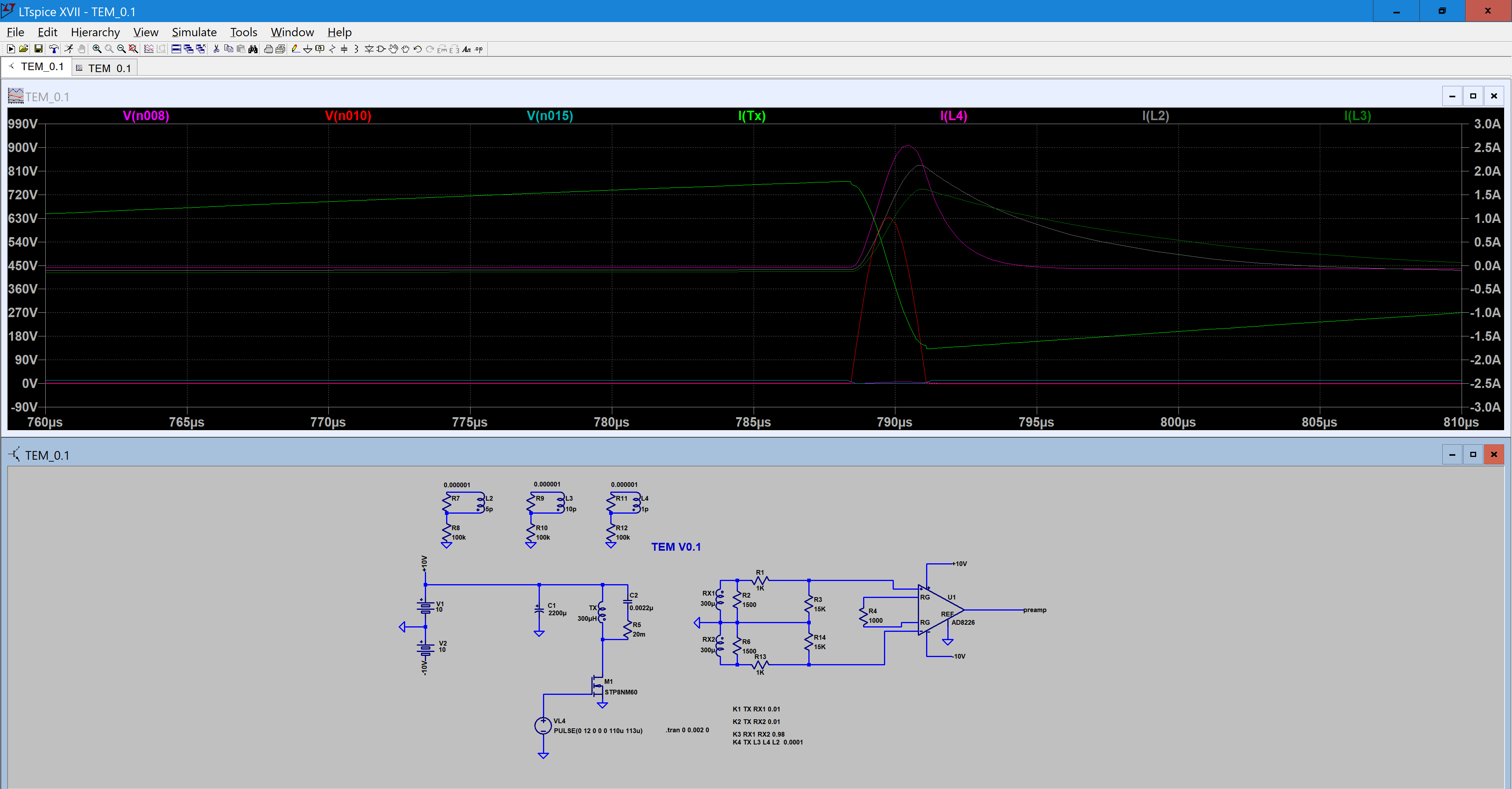

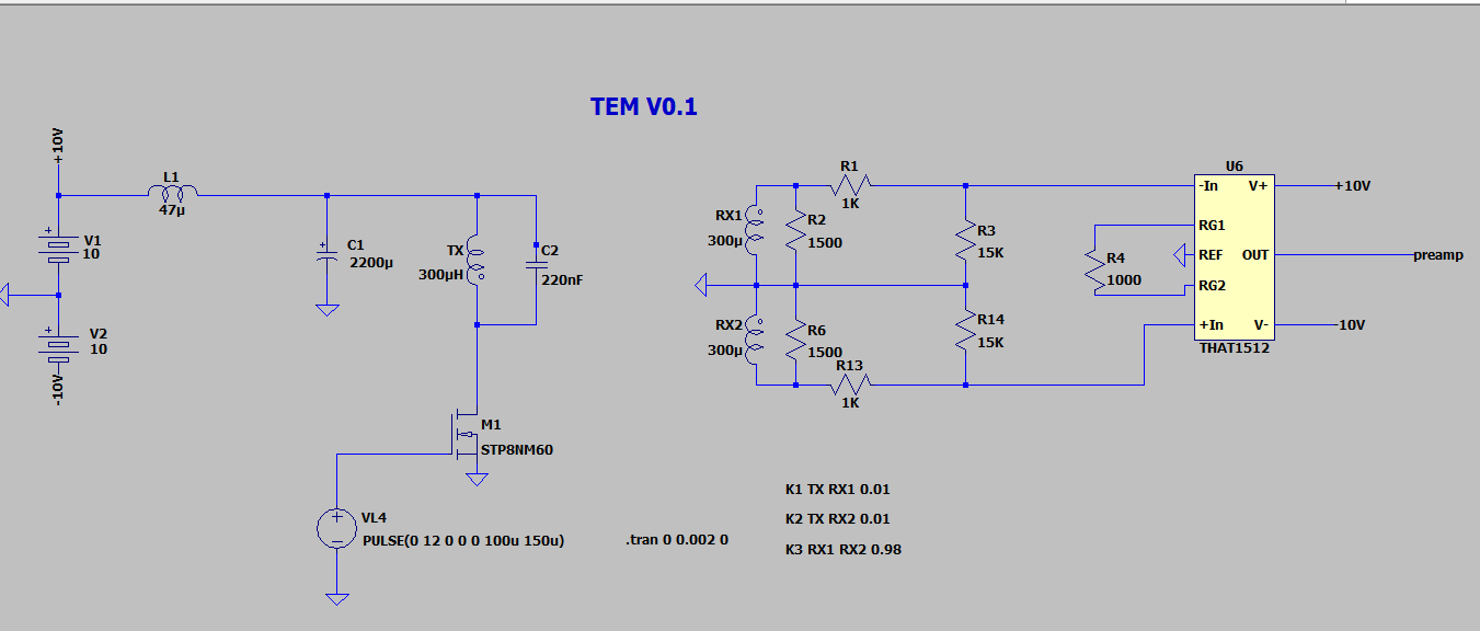

    Lets start with this simulation file if you like it (see the attached files).
    This steers away from the co-planar coil and the reverse TX coil controlled with a P-ch mosfet but I think it's the one thing it got people scared of.
    It's with a regular DD coil with TX coil 300uH. The RX is made with bonded bifillar wire used to create center tapped RX (bought 0.25mm wire of this type so it's actually available for purchase and you don't have to built it yourself). The preamp is THAT1512 - for ease.
    Protection diodes in the RX my observations where not needed (KISS).

        eclipse,
        I have taken the liberty of changing your simulation to fit better for the small nuggets that you are looking for.
        the TX L2 you had is the bucking coil for a concentric induction balanced RX coil. You don't need it for the DD coil.
        I also added 3 targets, 1us, 5us, 10us, TC's, to show the target reaction on the TX pulse.
          The coil (47uH) is inductor for not allowing high current flow back to the battery supply or other circuit sections as per Aziz TEM designs (aka magic choke).
          In my version 220nF cap reduces the flyback to ~100V and the RX sees a lot less so protection diodes were not needed.
          But with lower tuning capacitor the voltage goes up and protection diodes will be needed.
          You've changed the op amp with one that's rated for up to +-35V on the inputs (and the simulation runs a lot faster than before)
          I've built the tx/preamp section with real components and it worked (my simulation).
          I've picked this preamp because it's ready for Bi-Polar TX without modifications needed.
          I've experimented a bit with the next thing I wanted to do but gotten not very far - figure out how to filter the TX voltage
          in a way that it will work for wide range of TX flyback 100-250V for example, with minimum adjustment needed so that it can be used to subtract the RX
          ( as per your post a while back called Breakthrough!!!!! Full discrimination with PI).
          I don't know if you have made further experiments of this but this was the direction I wanted to dive into, I think this topic has been overlooked.

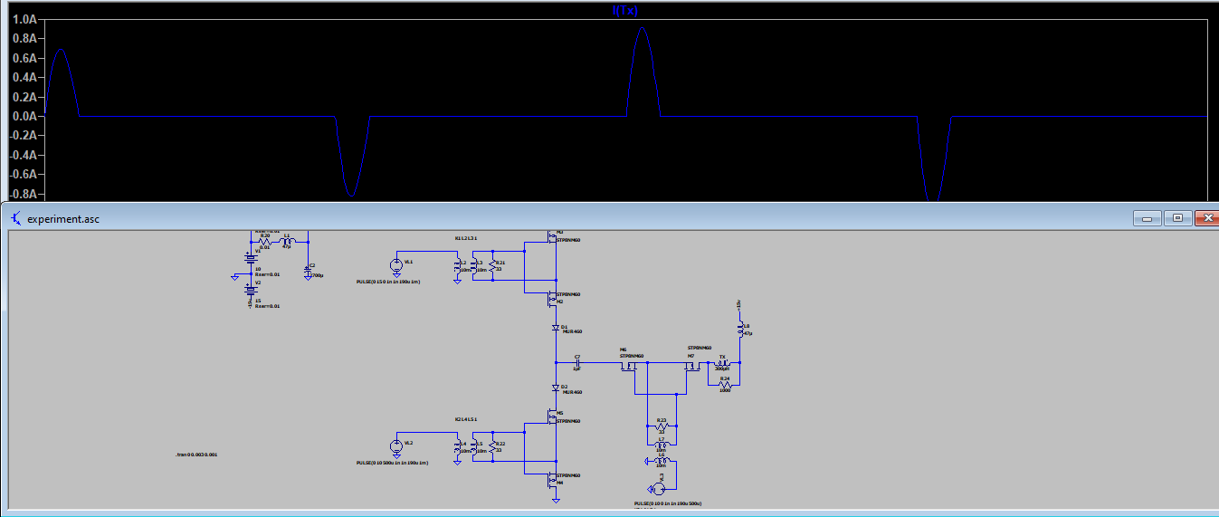

                        Here's an experimental circuit. What do you think ?
                        experiment.zip
                        And the bipolar circuit.
                        It can be made to become the THS.
                        Can it be made to be TEM ?

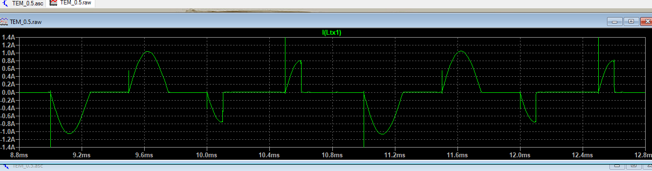

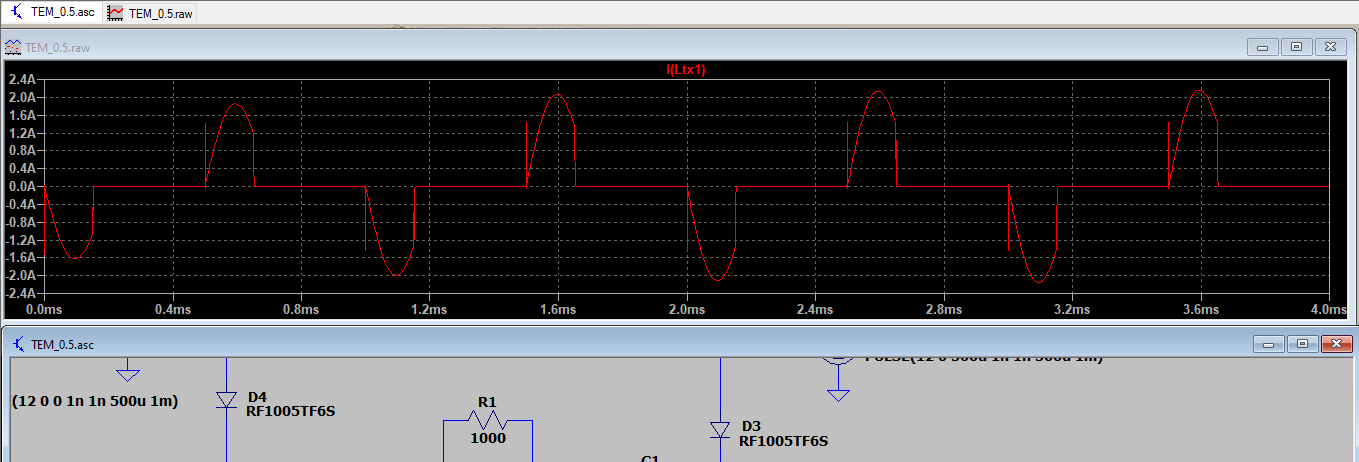

                          Bipolar TSW with the bipolar schematic posted above after playing some of the values
                            just figured why not do this - we could have both (multi-frequency) type deal (half sine + half truncated sine)
                            maybe focus on processing more .. rx/preamp sampling etc.
