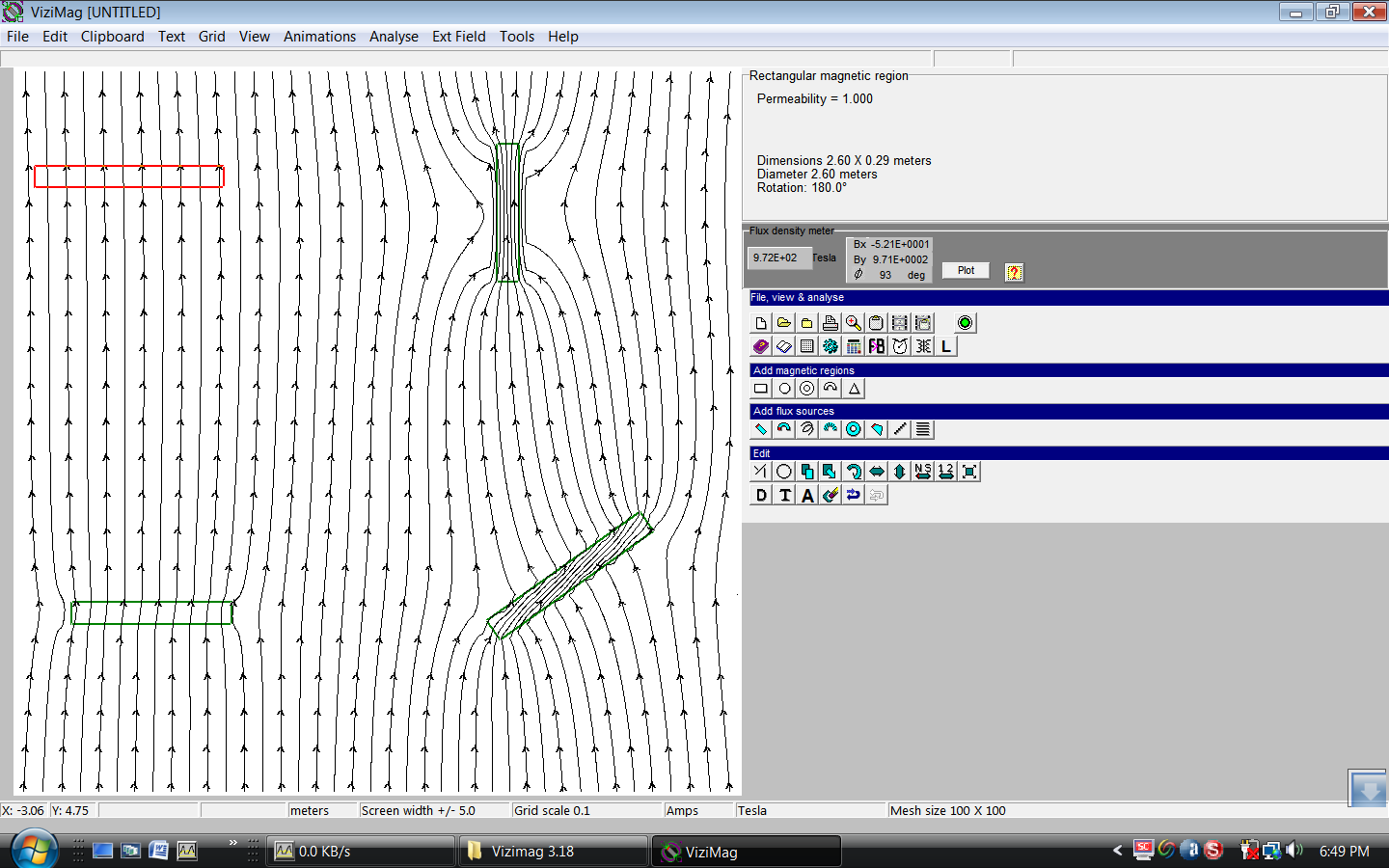

Magnetic field simulation
I came across an old simulation I did years ago. It shows the magnetic field and how it interacts with a copper target andwith an iron target. Left side target is copper.
Right side target is iron in 2 different position.
Note how the iron target pulls the magnetic field lines into the target.Attached Files
