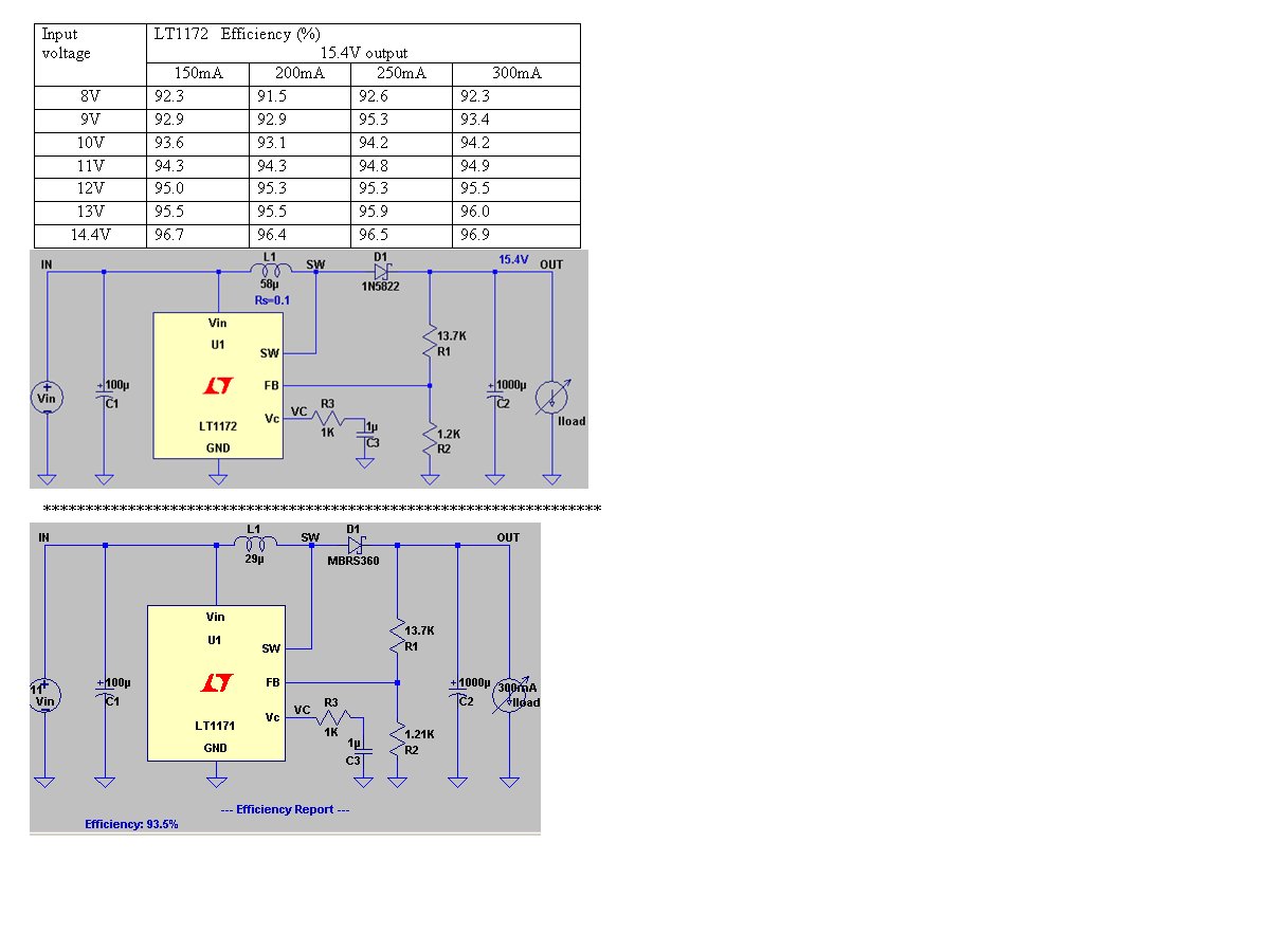

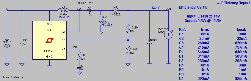

                        Efficiency tests results with the LT1172 at 15V are good, almost great. For various inputs between 8-14.4V and output between 150-300ma.
                        Better than 90 percent efficiency is possible for all combinations of input output. The single 58uH inductor circuit with 0.1Ω series
                        resistance shouldn't be too tough.
                        LTspice can make some wacked out calculations sometimes but when you have 20 in a row maybe there's a pattern.
                        I realized that LT1172 is best when used as a step-up regulator. The circuit I posted the other day is called SEPIC which allows a very
                        wide range of input voltages, but power efficiency suffers. So long as the step-up mode is used the LT1171 (big brother to LT1172) can
                        be used and with a smaller inductor. LT1170 can also be used, with an even smaller inductor, all with very good efficiency.
                        I will look at some more possibilities.
                        edit: If we use 15V as TX voltage then we can use step-up switchers in the step-up mode even with 14.4V battery input.

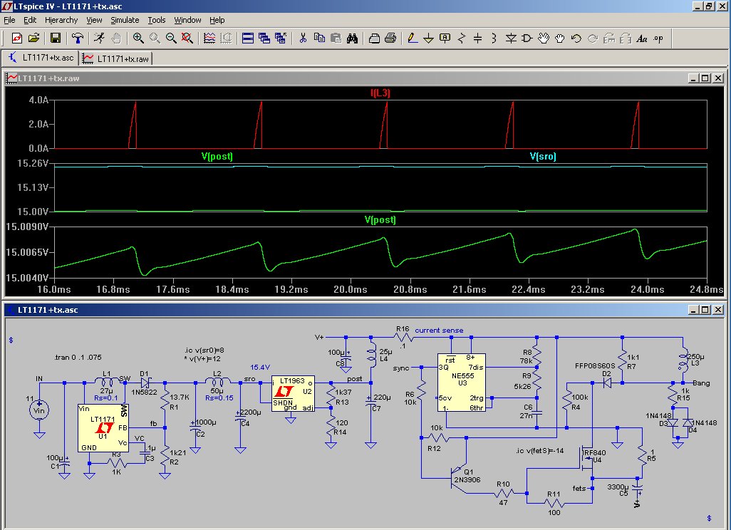

                            low noise post regulator
                            LT1171 can pump harder and thus use a smaller inductor to get the same job done, and also do bigger jobs than the LT1172. Either would probably work OK but 1171 is choice.
                            There could be several power supply versions. An economy version might use the LM2940 as a post regulator. I have no simulation model for the LM2940-15 so I experimented with some LTC adjustable regulators. I found one I like very much. There may be others but I made some mistakes. Comparison testing did not go well. I may try again, but I don’t want to spend a lot of time.
                            For a low noise supply I think the LT1963 (adjustable) would be a good choice. LTC provides a model for this device. In simulation I am able to get about 3mV ripple at the output of the post regulator using a two small pi filters, one at the switcher output and another at the post regulator output. I was pushing 4 amps (peak) through the coil at 600pps. With a different pi filter, ripple could be even less.
                            The LT1963 is $5.50 from Digikey. It's not inexpensive, but probably hard to beat for this purpose.
                            http://www.linear.com/pc/productDetail.jsp?navId=H0,C1,C1003,C1040,C1055,P2 222
                            The LT1963 datasheet lists thermal resistance junction to ambient ӨJA = 30ºC /W. By limiting the differential between input and output voltages to <0.5V, and even with 500mA load, the junction temperature should rise only 12.5º C. No heatsink required. LT1963 maximum dropout is 0.35V at 500ma (from -40 º to +125 º) so we’re in good shape.
                            The LT1171 is rated ӨJA = 75 degºC/W and should dissipate about 0.3W or less throughout the battery's discharge (from 14.4V~8.5V). Temperature rise could be about 25degºC as the battery nears its discharge voltage, when device dissipation would be highest. LT1171 has Tjmax of 100deg º C, so it would not hurt to have a small heatsink although it’s not absolutely necessary.
                            We need a negative voltage converter for the -5V supply. ICL7662 are still available, but if a resistive drop were between the converter IC and 15V supply, we could safely use a wide range of devices having maximum input voltage ratings well below 15V.
