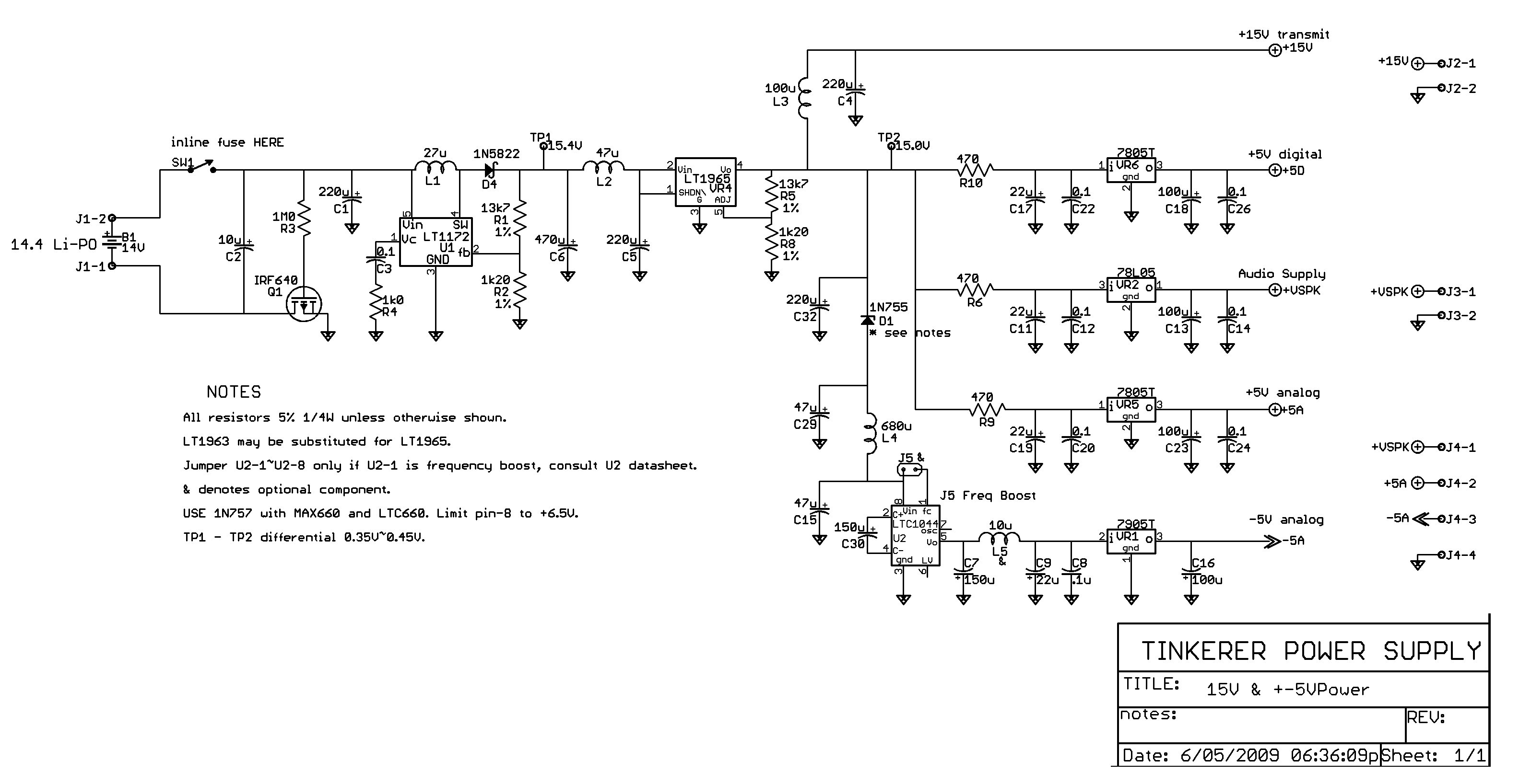

          Anyway, here is the schematic of the power supply.

            I don't know much and am a bit lazy so I just ask some questions to knowledgeable people instead of searching for the answers in the datasheets.
            So here it goes:
            A nominal "14.4V Li-Ion" battery pack has a maximum peak charge voltage of 16.8V and a cutoff charge of 11V.
            Is it OK to use the configuration above for an output of 15V?
            If we were to take the input of the 5V regulators directly from the battery voltage. would there be a saving of power, instead of boosting and regulating and taking the input from the regulated 15V?
            Thanks for all the help
            Tinkerer

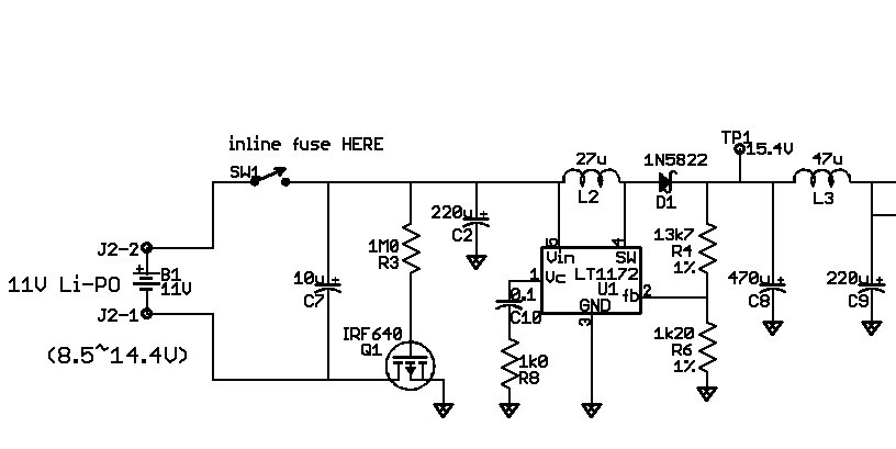

              Mistake. Input voltage should be 11V. Good catch, Tinkerer.
              You told me that 14.4V was full charge, 11V was nominal and 8.5V (I think) was time to recharge for the battery that you had selected. So, unless you want to change battery choice, the 14.4V is wrong and needs corrected.
              But, please don't do it!
              We can't use the higher voltage you just mentioned because above 15.4V the switching regulator would no longer be operating in the step-up mode. I don't think it would start. You would be running directly from the battery. (Hmmm, what happens then??) I would want to use the SEPIC topology if input exceeds 15V. Efficiency would suffer. What I have designed could also be used with a 12V gel-cel but won't work properly if input exceeds about 15V.
              You are right about gaining efficiency by regulating directly from the battery but the gain would be relatively small because the transmitter is responsible for the vast majority of the current draw.
              By using the +15V as the feed we know that the input voltage will be a constant 10V above the regulator input. Knowing that (and estimating the current draw through the regulator) allows an input resistor to be selected as part of an RC pi filter, and drop the excess voltage. If the input were allowed to vary 6V over the battery discharge cycle I would probably want to remove the 470Ω input resistors but no harm would be done.
              It would be OK to jumper from the B+ to the "south" end of the 470Ω resistors (removing the resistors), or maybe I could redesign as you say, coming directly from the battery. It seemed to me a good idea to isolate the individual 5V regulators and the 15V output is a convenient, predictable input source, but I will admit a small efficiency advantage by regulating directly from the battery.

              edit: In the +5V audio circuit, the 470Ω resistor shown is probably way too high. The best value would depend on the audio current drawn (unknown to me) and it may be best to remove the R and run this regulator directly from the battery. I'll submit a change in a couple of days.
                no LTC660 or MAX660
                Here is another mistake or two. In trying to accomodate the widest range of CMOS voltage converter ICs possible I made a note on the schematic draft that if MAX660 or LTC660 were used, then the Zener diode at the input must be changed. I cannot guarantee that inserting a 1N757 will lower the 15V to below 6V "Absolute Maximum Input Voltage" for these devices, but if it does, then the output of those two devices will almost certainly not be high enough to use a 7905 regulator. National's 7905 datasheet states -2.3V is required overhead for the 7905 with a 100mA load, and -2V required at 40mA. Without getting into the fuzzy math I extrapolate that 7905 cannot be used with those two converters whose maximum output at no load would be -6V.
                What's even worse is that I know of very few negative LDO regulators having the same pinout to solve the problem. There is probably one somewhere, and I will look, but the most comprehensive plan may be to exclude the MAX660 and LTC660 as possible choices for U2.
                edit: I don't know of any -5V LDO regulators in either the TO92 or TO220 package. All I know are SMD. Anybody???

                          Here's another something that needs correcting. For the LT1171 and LT1965 I have the voltage adjust resistors shown as the same values in the previous draft. (I won't call it a schematic because it still needs work.)
                          Those two devices have slightly different reference voltages, so although I calculate about 0.4V voltage differential using those resistor values applying the voltage output formulas - according to the specification sheets for the LT1171 and LT1965, simulation shows otherwise. The post regulator may be in dropout, and not what we want.
                          Funny thing, I get different results with those same components in different simulation files and I have yet to identify the source of variance. That's scary.
                          So, a simple catch-all adds a trimpot in either the switcher or the post regulator circuits. (Oh, crap. More decisions.) Just kidding, that's an easy one. It'll be whichever one is EASIER to ripup and re-route. (Yes, I'm lazy too, and behind schedule.)
                          In reality, I suspect that a LM2940-15 would work fine in this power supply so the obvious choice would be to make the switcher's output variable. That's what I'll do next time.

                            Yes it is a lot of work to do a good power supply. But it is an important part of the whole circuit. We appreciate your effort.
                            Earlier, you cautioned about different grounds. Could you expand on that a little?
                            Are you using a Star Ground or a Ground Plane?
                            How do we avoid getting noise on the ground?

                              Tinkerer I guess the answer to your question is "star ground", and ground plane(s) is/are are optional (if you call the bottom fill a plane).
                              About the +5V regulator inputs; I would like to use input resistors (except possibly for the audio regulator). Those resistors could easily be removed and the B+ used as regulator inputs, but I have another issue that worries me.
                              I've been experimenting with the filter at the input to the FET and found that a smaller inductor and larger capacitor may give the lowest ripple on the +15V output. These tests take time, but I won't stress. L & C can be upgraded if something is found that works better. I'll make room.
