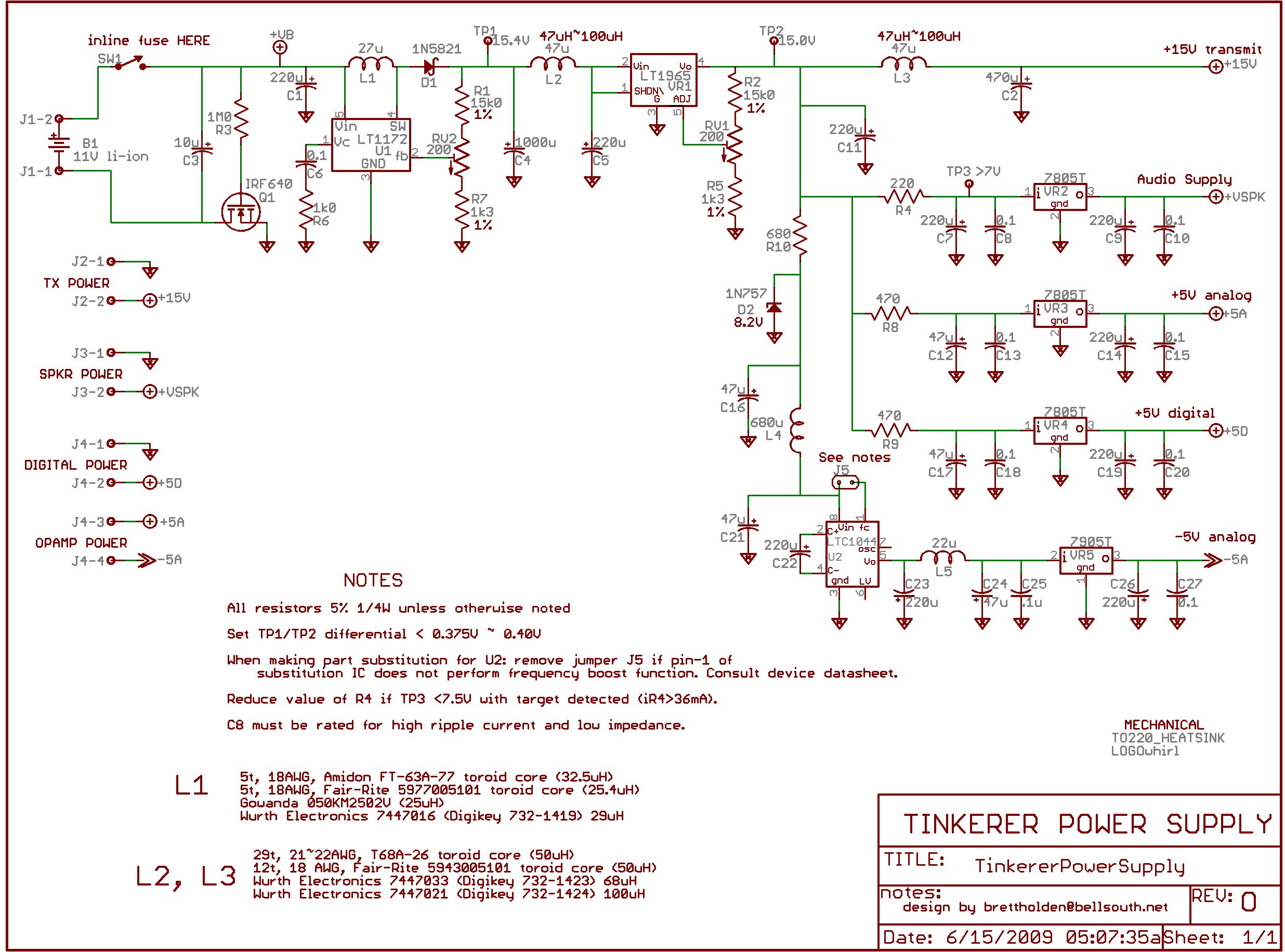

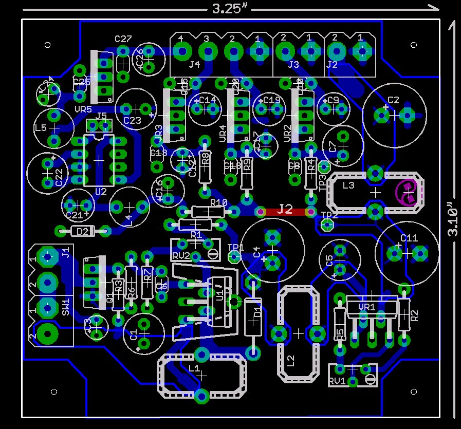

    Whew, Finally done. As I was making the parts list I kept coming across little things to tweak. Big ones, too.
    This power board is designed to use an 11V Li-Po or similar battery (that could have an output ranging from 8.5~14.4V)
    and develop a constant +15V to power a PI detector having an N-channel FET and a DD coil. There are also three +5V outputs and one -5V output.
    This board can also be used to power a monocoil detector that uses a P-channel FET.
    I've tried to keep the schematic and the parts list consistent but there came a time when I had to break the two apart
    and the parts list was updated manually even as I was making changes in the project.
    There is an explanation in the zipped folder so I won't repeat everything here.
    You can open the schematic and board in Eagle 4.16 or anything later (freeware or standard versions will open it).
    It was made with a legal freeware version so there should be no DRM issue to mess things up.
    A few days into this design I realized that I could use it in my upcoming project because I'll be using a DD coil.

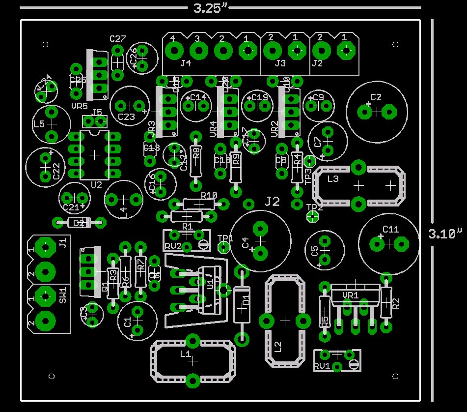

    The PCB layout shown here looks incomplete because the ground polygon is not poured. To complete the ground path you
    need to open the schematic and board. In the board file do a "Tools > Ratsnest". Turn off all layers except for Bottom, Pads, and Vias and
    Dimension (16, 17, 18, 20).
    Then, "File > Export > Image" allows you to output the board file either to the clipboard, or to a file folder.
    Save it to a file folder if you want to print it out. You have different file formats to choose from that way.
    Use monochrome if you want to etch. Be sure to use a high enough resolution, the default 150 is pretty useless.
    The polygon-poured picture is just too large to show here, and changing the resolution to reduce the size would make it
    unusable - so there is not much point in showing it here.
      L2, L3 toroid calculation mistake

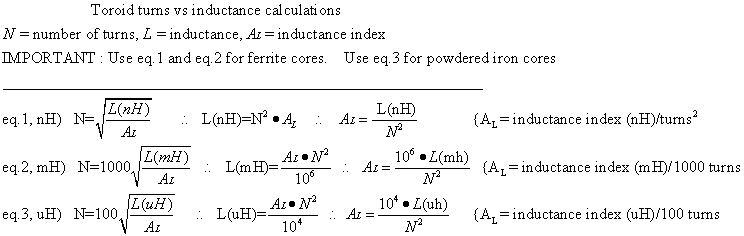

      I made a mistake when I calculated the number of turns to be used when using 26 mix powdered iron toroid cores for L2 and L3. I think the L1 calculation (using a ferrite core) was OK, but L2, L3 are bad wrong. A 26 core (or the Fair-Rite core listed) should not be used because too many windings of would be needed.
      I gave myself a crash course in using toroids. I found only a mish-mash of incomplete and outdated material on the Amidon website. That was dissapointing because I always assumed Amidon is sort the Mac-Daddy of toroid cores. (Maybe that title belongs to Fair-Rite. ) The Amidon website's instructional data is purely stone-age. They have separate pdf files of scanned pages from one of their old databooks, probably from the 1980's from the look of it. Very difficult to browse. I tried to fill in the gaps from other sources that were often heads above Amidon's site in presentation, but it was only tonight that I think I grasped the view of the big picture.
      Toroid cores have an AL, or inductance index associated with them which varies with their size and composition. When calculating the number of turns needed for a given core from its AL specification, there are three different formulas you might encounter. There are two interchangable formulas for ferrite cores (one relates to nH and one relates to mH) and a third formula for iron core toroids, relating to uH.
      The ferrite and powdered iron formulas are NOT interchangable. If you use one of the ferrite AL formulas with AL data for an iron powder core you will get a wrong answer, as I did.
      I overlooked the fact that the odd formula is the one that I was supposed to use when calculating the number of turns on the L2 and L3 powdered iron cores. L1 uses a ferrite core and I think I got that calculation right.
      I listed some factory wound cores on the schematic page and in the parts list that should be suitable for L2 and L3, but those two hand-wound recipes will come up short.
      We could use FT-63A-77 core for all three inductors (I calculate 9 turns for 105uH) but that core is over-size for what we need and it's kind of expensive. A smaller 77 mix core (say, FT-50-77) should work OK because it won't need to handle the same stresses as the L1 coil. I should have planned to use a 77 mix core at the beginning and I wouldn't need to be writing this.
      FT-50-77 with 10 turns #18 or #20 AWG should fit and make 100uH. I think that should work for L2 and L3. Let me sit on that for a few days...

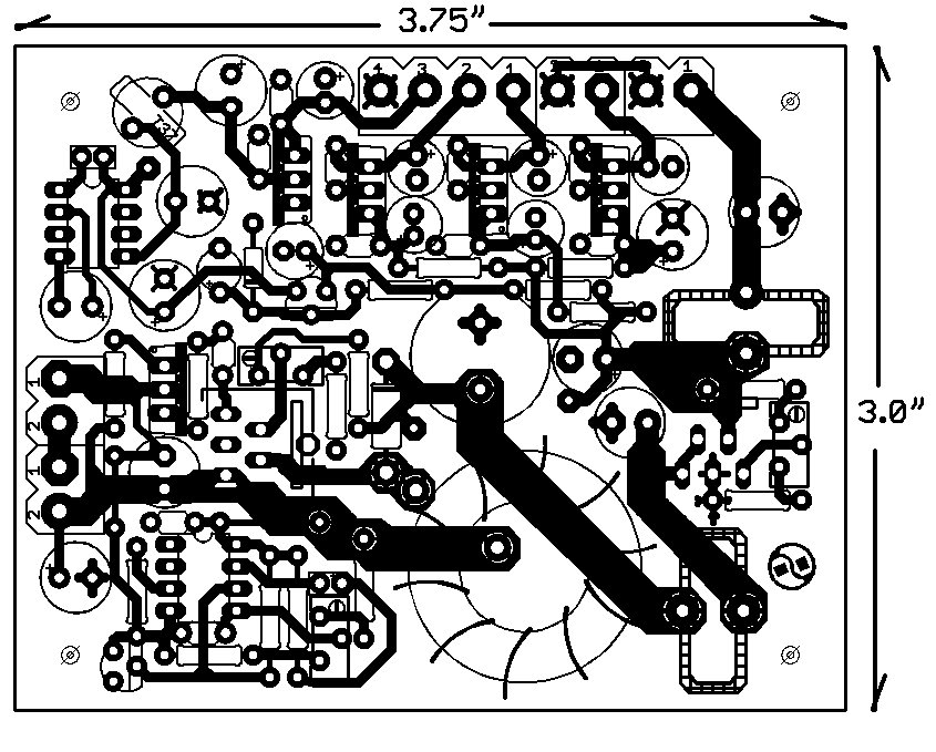

                      power supply update

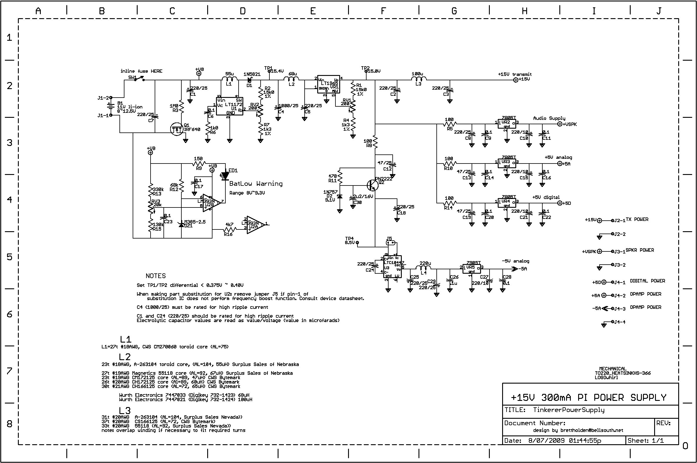

                      I've sent Tinkerer a rough draft of a new schematic and PCB layout using a more suitable core for L1. The new design uses a CM270060 toroid core that is about 1.1" in diameter. A smaller core could possibly be used but the ones I looked at would make it difficult to fit enough turns of 18AWG as I want. #19 wire might be OK and fit on a smaller core but for a prototype I would rather start out a little too big and maybe work down rather than to try and do it the other way around. Skin effect is in play at the LT1172 switching frequency (100kHz) so larger wire might be a waste, and at the same time smaller gauge wire exhibits substantially higher resistance than at DC.
                      There is only one good source for the CM270060 that I know of (CWS Bytemark) but the other inductors are much less critical. In fact, solenoid coils might be effectively used for L2 and L3, and take up considerably less room than toroids but the layout has space for toroids. There is room for T65 or T68 Toroid cores for L2 and L3 but I'm thinking that FT50 size ferrite could probably work. I'll need to research that. L2 and L3 need to handle a maximum of about 300mA (we're going loaded for bear) but there is essentially no AC voltage on them. L1 handles the supply current, PLUS, up to 12VAC, so it needs some bulk.
                      I'll look at CWS's stock of ferrite parts and try to pinpoint some "best" cores for L2 and L3, but I've already ordered Magnetics 55118 cores (or something similar) from Surplus Sales of Nebraska, and that's what I'll use. The closest replacement from CWS is the CM172125. Although the CM part has a larger outside diameter, it has both lower inductance index (meaning less inductance per turn), and a smaller "window area" meaning fewer turns will fit. Either one should should be good enough, but there is probably something better. It's just a matter of looking (maybe tomorrow).
                      I figure that to wind about 68uH with either of the last two cores would require using 21AWG, and that is as small as I want to go. 20AWG would make me feel better but I may only be able to obtain about 50uH. Either way, it's not worth losing any sleep over.
                      l need to take a few days to clean up the layout and at the same time try and weed out any glaring design errors. The power supply's design is not particularly complicated, but the devil IS in the details. There is added a battery low LED warning based on 1/2 LM393.
                      The board is a single sided design so there is no bottom ground plane - I can only hope that any radiated EMI will be of low enough power as to not mess up the processor or analog circuits.
                      If anybody can point me in the direction of a dealer who will supply small quantities of Magnetics powder cores (MPP material, or maybe High-Flux) I would surely appreciate it. The CWS product line is good, but they stock only a limited variety. Another source would be welcome.
                      edit: more on L2 and L3 cores. I have been concentrating so much on problems with L1 and how the more common ferrite materials (75, 77, etc.) are unsuitable, that - I have almost forgotten how those ferrites ARE probably suitable for L2 and L3. Ferrites toroids are available from Amidon, but with their extremely high inductance index (compared to "powder") they are a world apart from powder materials like MPP,and High Flux. It's late. I'll look into this TOMORROW.

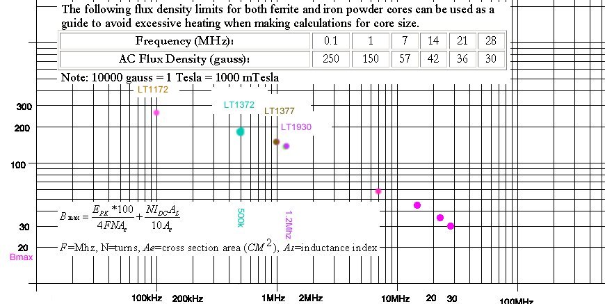

                        Instead of 250G, the allowable Bmax number I used for the LT1172 core was 500G at 100kHz. I do not remember where I got the number 500 from, because Amidon tech notes suggest that Bmax= 250G at 100kHz. This number is not set in stone and different core materials can handle more flux density than others, but I cannot go into detail at this time. At first I thought it was a bad thing that toroid core sizes jumped appreciably in size in my range of interest; so that I had to choose between either a core that seemed too small, or one that seemed too large. I chose the larger size. Looking back, if I had chosen the smaller core, and considering that I started with one-half the safety margin that Amidon suggests, the first design could run into trouble with core over-saturation at higher power levels.
                        As it is, I am not too worried about possibly having under-specified the first toroid because I made Bmax calculations to cover a wide range of input voltages and input current combinations, and excepting the fact that the 'target' number I used may have been inappropriate, there was some safety margin afforded by the large core size. And besides - if a larger core than what I selected is required, then I am not too interested in that solution anyway. (Sour grapes, anyone? )
                        I'll need to look over the older design and will make a post most likely on Friday, depending on how many 'adjustments' I see as necessary (but umh really, I don't want to have to adjust anything).
                        I am new at choosing magnetics for use in power supplies, so over the course of this thread if anybody has correction or suggestions to offer I will not take offense if you do.

                          An Eagle 4.16 PCB layout, schematic, and comprehensive parts list are in the zip file. This is my latest thru-hole +15V power supply, using the LT1172.
                          There are only a handful of toroid core manufacturers on the planet, and still fewer have what is needed for L1, and will sell their products in small quantities.
                          CWS Bytemark does have a suitable product line that is available in small quantities.
                          I chose their CM270060 core which is approzimately 1.1" outside diameter and .4" in height before adding wire.
                          It is made from MPP 60u material. With 8V~12.5V input and 15V 300mA output, L1 has a big job to do.

                          As I stated in my previous post, I may have used a number for maximum flux density that does not allow a wide safety margin at the 100kHz switching frequency.
                          Fortunately, my calculations of generated flux density did not max out at this value (500gauss), so I "think" the design should be OK. (Famous last words?)
                          Some manufacturers suggest 250gauss to be a safe maximum value to use. Maybe not justification, but, that number is only a guideline - the
                          correctness of which depends on the specific core material in question, and, the manufacturer where I got that number from does not make MPP60 anyway.
                          I honestly do not know how I decided to use 500G, but as I stated the other day, "if a larger core is needed, then I don't want this design anyway". Ahem.
                          I will eventually build and test this power supply design, so you the reader may want to wait to see what happens to me before you build this device for yourself.
                          After spending some more time researching the magnetics morass today, I have given trying to remember where and how I determined that 500gauss
                          should be the maximum flux density for L1. There are various charts available regarding core loss vs frequency for specific toroid core materials
                          and I will try and make some better sense out of what is available. I'll have to figure it out later.
                          If L1 gets hot the most sure fix would be to use a larger size core or else glue two smaller cores together. Neither option seems very attractive

                          Most of the ground connections on the PCB are made through Eagle's polygon pour feature, which was not turned on for the jpg below.
                          The picture's resolution would need to be higher than is practical to be posted for this forum.
                          The PCB was designed with Eagle 416 lite (freeeware) so any version after that should be able to open it for editing.
                          All you need to do to complete the grounds is go to Tools > Ratsnest on the Eagle PCB editor menu bar.

                          a reflection of the variety that is possible. There are many more possibilities for L2 than what I have listed.
                          There is some leeway for L3, but that choke should have a value of around 75~100uH. If your L3 inductance is lower, then C3 should be increased
                          to keep the transmitter load from affecting the VR1 output. I wanted to smooth the input to the various +5 and -5V regulators, but a few tens
                          of millivolts of input ripple should not make much difference on those 5V outputs.
                          That's all for now.

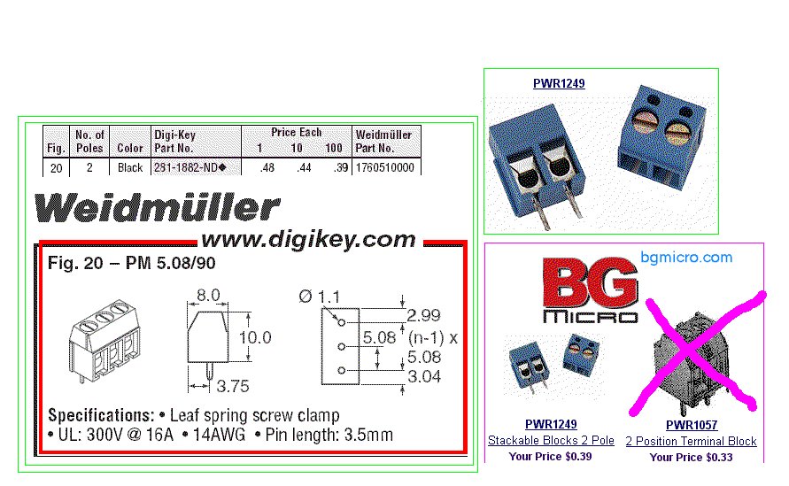

                            I took another look at the power connectors and may have made a mistake on the parts list.
                            I would not suggest that PWR1057 from BG micro be used. BG does not give a complete description of that part and it does not look like what I have, so don't try and use it.
                            I thought I had purchased some, but that is not what I have. Use the PWR 1249 or else the WeidmŰller part from Digikey.
                            PWR1249, at 9mm, is slightly wider than the WeidmŰller 1760510000, and that is what I used for the PCB layout.
                            • #44
                              What about LM2575 or LM2675.
                              It has wide input voltage range: 8V to 40V.
                              External shutdown pin allows deactivation during critical sampling processes.
                              Below schematic is from http://www.mino-elektronik.de/12VDC/...h_aus12vdc.htm "Multiple power supply from 12V-DC"
                              +18V@50mA may be a problem for high TX pulse width.
                              • #45
                                Mustafa,
                                thanks for the contribution.
                                The power supply with the multiple output is interesting. It will need some tweaking, change the 8V outputs to 5V is easy enough.
                                The 18V to 15, or leave it at 18, but it will need about 150 to 300mA, depending how much pulse power one wants, or how deep the penetration should be.
                                The shutdown pin is a good idea, I wonder how much time the power supply takes to build up again?
                                Tinkerer
