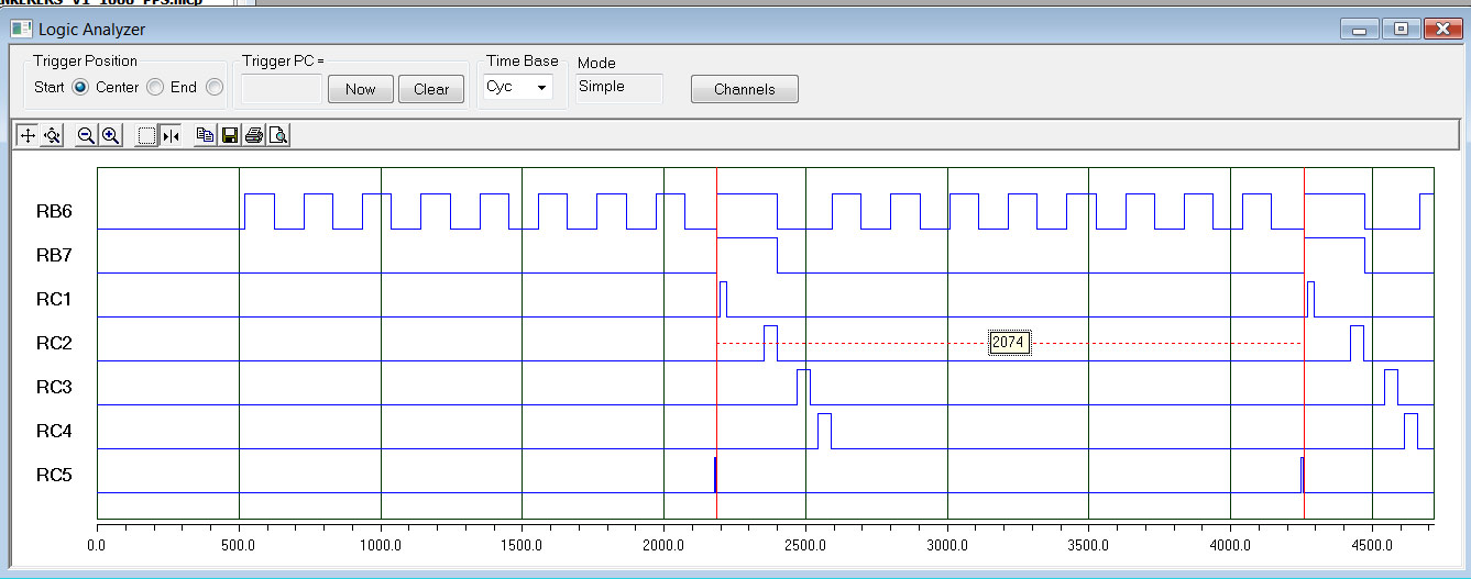

    Here is an initial timing schedule for the TINKERERS IB-PI.
    I would appreciate help with the writing of the code. At present it is for the PIC16F690 for TINKERERS IB-PI, V1.
    Tinkerer
    Timing Schedule
    This is the initial timing schedule. As the design progresses, there will probably be changes in so far as that we will be able to define the best timing for a specific coil and power combination.
    For the V1 we will just use one target sample and one ground sample and maybe a noise sample.
    For the V2, that has the possibility to change or upgrade the software by USB, we will use several target samples and ground samples.
    For V3, the sky is the limit.
    Explanation of the different timing pulses:
    The whole sequence has a duration of 1666.5uS This gives 600 PPS or TX pulses per second.
    Starting the sequence is actually the last sample pulse of the cycle, the noise sample. It is at a place where there is no signal left, the only thing left is the environmental noise. We can subtract that from the signal.
    Next. simultaneously we have the start of the TX pulse and at the same time the Sync pulse for the power supply. The sync pulse runs both, the ICL7662 Negative inverter capacitor charge pump and the capacitor charge pump that produces the regulated TX power.
    The TX pulse has a duration of 100uS.
    During the TX pulse we have 3 sample pulses. The first one is the most sensitive sample for small targets.
    After switching OFF, we have a sample pulse that gives the same response like any standard PI.
    The sample pulses have a duration of 5uS.

            TINKERERS_V1_600_PPS TIMING SCHEDULE
            Attached is the timing schedule with a pulse rate of about 600 pulses per second.
            There is also the Hex file to program the PIC16F690, running the PIC on the internal 8Mhz clock. No external clock or crystal needed.
            The TINKERER_V1 runs fine with that including the discrimination.
            Like every other part of the TINKERER_V1, there is a lot that can be improved.
            This is meant to be only the beginning. Try it, see how it works, then all together we want to start on the improvement.

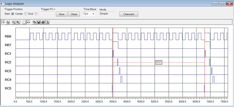

                      Most recent timing schedule at 1kPPS
                      It has been some time since I posted something new. Been working on the PCB's and refining a few things.
                      The biggest breakthrough, is that the TINKERERS_V1 is now capable of discriminating small, thin, rusty, steel pieces. These are some of the most difficult targets to differentiate, so I am quite proud of my achievement.
                      Attached is the timing schedule that accomplishes that. It runs at just under 1000 pulses per second. As you can see, several samples are taken at very specific times.
                      There are still many things that can be improved, so I am very grateful for any help that I can get.
                      This is supposed to be a OPEN SOURCE PROJECT, where all and everybody is welcome to participate.
                      Tinkerer

                          Hi Nicolae,
                          at present the PIC16F690 is running on the internal oscillator at 8Mhz. It gives enough precision for the timing sequence of this design.
                          The timing schedule above is fully functional and discriminating.
                          The signal processing is done in analog, so that it is visible and easy to understand.
                          The PIC could run on an external crystal up to 20Mhz which would be advisable for digital signal processing.
                          all the best
                          Tinkerer

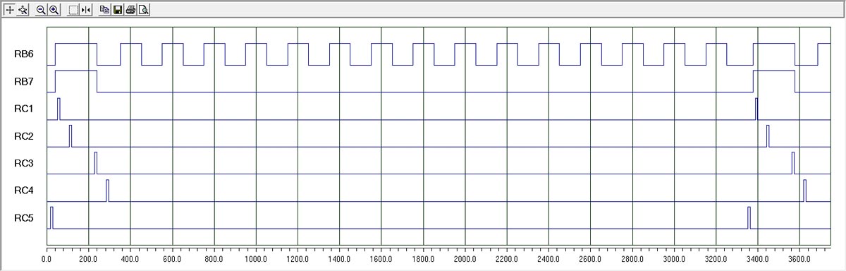

                              TINKERERS_V1 TIMING
                              Originally posted by nick_f View Post
                              Hi Tinkerer,
                              Do you mind explaining a bit what are all those pulses used for (RB6, RB7, RC1, RC2, RC3, RC4, RC5)? What are their delays and widths? Are you using all of them?
                              It's great news that you can discriminate small iron.
                              Happy New Year!
                              Nicolae
                              A HAPPY NEW YEAR to you too.
                              The function of the pulses:
                              RB6 Is the sync pulse that synchronizes the ICL7662, inverting charge pump as well as the boost charge pump that takes the battery voltage from 8 to 12V, up to 15V regulated. This way no switching noise falls in the sampling window time.
                              RB7 is the TX pulse
                              RC1 is the sample for gold and other short TC targets
                              RC2 is the sample for FE targets
                              RC3 is the sample for all metal targets, but more of the long TC kind.
                              RC4 is the pulse that controls the Tracking Ground Balance
                              RC5 is not needed for the function of the detector, but I use it to sync the Oscilloscope.
                              With the help of PICON, I am working on 4 different timing schedules that can all be loaded into the PIC and chosen by a switch.
                              If you want to build the detector please ask for the latest update of all circuits. I already have too many versions on this forum, so I am trying to post only one more, the final one.
                              Tinkerer
