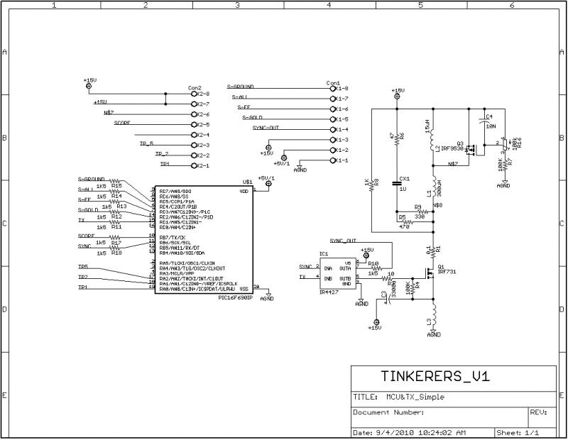

            Hi Jose,
            I looked on the forum for the MCU&TX file and could not find it. I know I posted it somewhere, but honestly the TINKERERS IB-PI forum is a mess. As a project in development, this is somehow OK, because it shows the development stages and the feedback from people all over the world, which is nice, but it means that anybody who did not follow the project from the beginning, has a hard time to put the right pieces together.
            Then I looked for the EAGLE FILE on my computer and again it is a mess. I had downloaded a free trial version of EAGLE 5.10 and un-installed it after the trial time was up. Somehow I lost my schematic files in the process.
            Anyway, here is a png file of the MCU and TX for the TINKERERS_V1.
            Tinkerer
            • #51
              Hi Tinkerer,
              can you (in short) explain idea of your TX stage again? Thank you.
              • #52
                Hi Tinkerer,
                IC1 is the Mosfet driver fir Q1, Q3 regulates the current in the bucking coil. The bucking coil is close coupled with the RX coil (not shown, to keep the circuit simple) the current in the bucking coil counteracts (180 degrees) the current induced by the TX in the RX coil so that the residual signal in the RX coil is reduced to a minimum.
                with the TX/RX coils induction balanced at high precision, any tiny movement or changes between the coils caused by temperature, movement during potting, or shielding, or highly mineralized soil, etc. upsets the balance. Q3 is used as a variable resistor and makes it possible to readjust the induction balance.
                The 1u capacitor absorbs the Flyback so that Q1 does not avalanche. During the time when the mosfet would normally avalanche, with the coil voltage at 100V to 300V I take samples. These sample give a very high response signal from the targets and also give information about FE and target TC.
                Tinkerer
