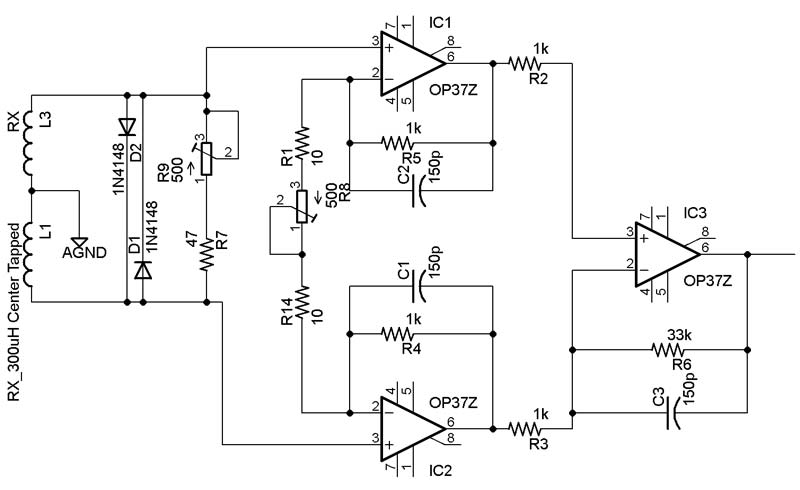

    Today I breadboarded the differential input preamplifier of post #6.
    It works great.

      It's hard to see the schematic that you provided. If I read the values right, and calculated correctly, is the gain of the circuit 3150? How's the noise? We should calculate the bandwidth as well, if you haven't done that already.

        thanks for the feedback, hobbes.
        attached is the breadboarded version, except, the opamps on the breadboard are TLC72. Better, low noise opamps should improve the results.
        The gain is variable with the R8 pot for experimenting purpose. The R and C's are the ones used. The value of the 150p capacitors depend a bit on the coil capacitance and choice of Opamp.

          Hi Tinkeres,
          a resistor is missing in the intrumentation amplifier design. The +input of IC3 should be connected with a resistor of same as R6 to ground.
          Check this out.

            Thanks Aziz, I added the 33k resistor from the +input IC3 to ground.

              But don't forget the compensation capacitor too for the symmetry (I myself did forget to mention this).
              Good work to start with such a differential pre-amplifier. Note: OP37 needs gain > 5 for stability. But they are well compensated with capacitors anyway.

                Thanks again.
                It was interesting to see how the resistor did not make any difference at all, but the capacitor made quite a difference in the signal shape.

                  have a look at this: INA163
                  http://focus.ti.com/lit/ds/symlink/ina163.pdf
                  Very low noise (1nV/sqrtHz) and wide BW (sufficient enough for us). This could replace the above circuit totally with increased performance. The frequency compensation with capacitors can also be done due to pin outputs of the chip. Operates from +/-4.5V to +/-18V. Only SO-14 package. No DIP.

                    That looks like an excellent choice. There is still a lot to learn about using a differential input amplifier for the PI front end, but it definitely seems to be the way to go.
