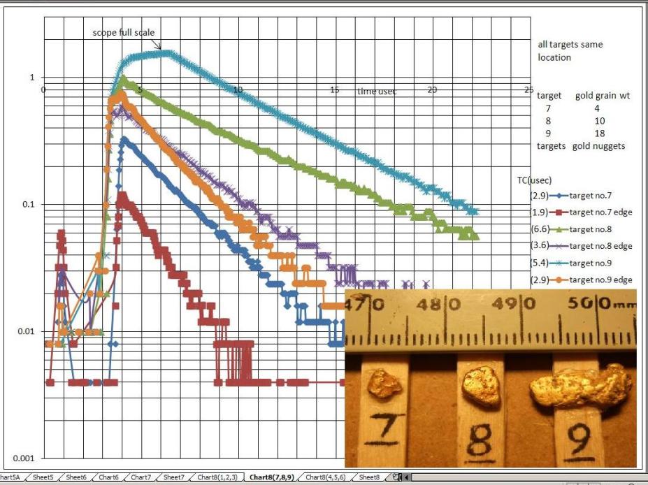

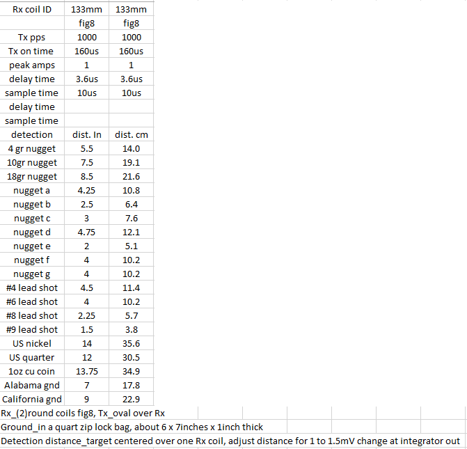

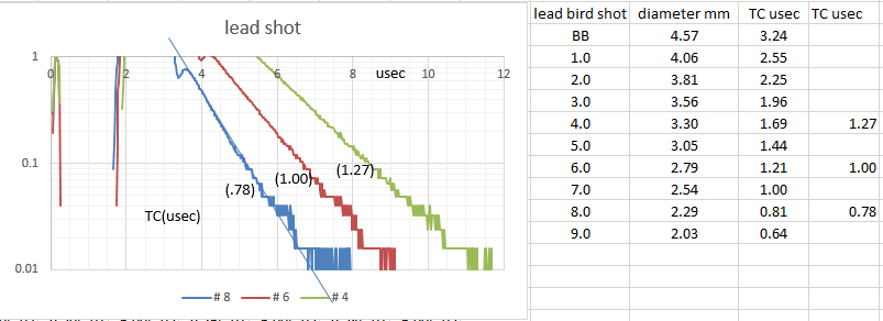

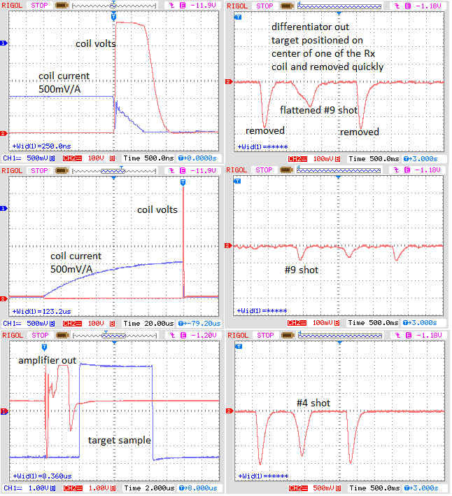

                      #4 lead shot has a diameter of 3.1mm, so from calculation:
                      in this case the current implementation of the Arduino Nano detector should not be able to detect #4 lead shot. This is because the minimum main sample delay is 10us. Since 5 * 1.39us = 6.95us, the eddy currents will have died away long before the main sample occurs. The 10us minimum delay is caused by the software overhead due to setting up the timer register and entering and exiting the interrupt routine. However it should be possible to get below 10us if the delay is produced without relying on the timer. Of course this would still require a suitable coil, and possibly a reduction in the TX pulse width.
                      The actual position of the target hole will depend somewhat on the soil conditions, and consequently the TC you're trying to ignore.
                      Is #4 lead shot a realistic target to use for testing?
                      Carl has previously said: "If you can detect a #9 lead shot, then you can detect most 1/2 grain nuggets".
                      Calculating the tau of #9 lead shot gives 579ns. Which means that the eddy currents have vanished after only 2.9us.

                        Why not also add what we need to fully stimulate these small, low TC targets? Theory tells us that the TX pulse discharge slope determines how fully the desired target size is stimulated. This discharge slop depends on the value of the damping resistor and any other resistance in parallel with the damping resistor such as the first amplifier stage input resistor value while the clamping diodes are conducting. Visualizing this forms a discharge slope with a kink at the point where the clamping diodes stop clamping and are open.
                        A good discharge slope mental model is formed when you take the coil value in uH and divide this value by Rd or damping resistor value. The 1.39 uS target would need an Rd of 1.39 divided by 5 or .278 uS with a 300 uH coil needing a 1079 ohm damping resistor to fully stimulate the 1.39 uS target. 300 uH coil divided by a Rd of 1079 is .278 uS.
                        This now gets down to needing a very creative coil construction technique to keep coil wire from retaining any eddy currents and looking like a target. Using Litz wire or very thin coil wire is required. The coax wire joint to the coil wire and/or the shield is another challenge to keep this solder joint from looking like a target.
                        The main point that I am trying to make is that at very low delays the coil construction techniques needs to focus on techniques to reduce coil and circuit capacitance and keep any physical parts of the coil from looking like the small targets you are trying to detect.
                        I hope this gets a discussion going in this direction.
                            What I think, not saying it's correct.
                            The actual position of the target hole will depend somewhat on the soil conditions, and consequently the TC you're trying to ignore. The grounds I've measured have the same R decay slope. Tx time and profile effect decay slope, maybe others. Don't think soil condition effects hole location. Tx time and profile + delay and sample times do.
                            Don't know if a piece of #4 lead shot is a good test target for toolnuts .3grain nugget. https://www.geotech1.com/forums/attachment.php?attachmentid=53833&d=1606672927 a chart I made for another thread. The #4lead shot is harder to detect than the 4grain nugget(reply #51)so maybe a larger shot would be better. #4 was the largest I have to test, will get correct size if we can define the size. There was only one of the seven 8mesh nuggets(reply #51)that detected farther than #4 shot.
                            Since 5 * 1.39us = 6.95us, the eddy currents will have died away long before the main sample occurs. TC isn't the only thing that effects signal strength. #9 shot and a 10mm square piece of regular strength aluminum foil have a similar TC but the foil has a signal strength about 100 times the shot.

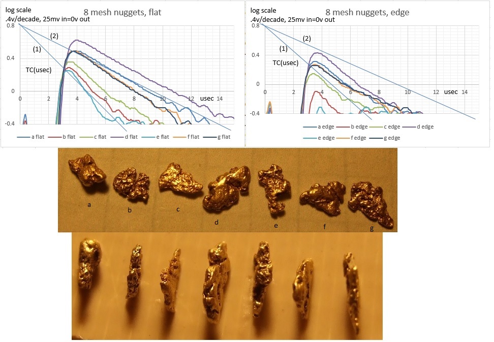

                              The surface area delivers most of the target response amplitude. Take a lead shot and knock it flat and see how the target response amplitude increases. Still the same mass of lead, but much more amplitude.
                              Gold nuggets are nearly always more flat than round. Often like flakes for very small nuggets.

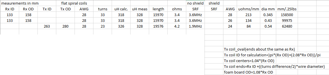

                              There is a relationship of target response amplitude with coil diameter and ampere turns and di/dt. Green, your 133mm diameter coil can see the #9 lead.
                              What is the peak coil current?
                              di/dt?
                              Ampere turns of your TX?
                              Surface area of your TX coil? In this instance it is a bit more complicated, as the TX coil is oval.
                              An EXEL spreadsheet with these calculations would be a very useful tool.
                                fig8 coils133_spread sheet I used when I made the coil.
                                gold detector1_scope ground, analog ground(2.5V above -PS). CH1, volts across .5ohm resistor from -PS to Mosfet source(reason shows current only in avalanche) recordings of differentiator out with different targets(#4 shot 500mV/div)(#9 shot 100mV/div)
                                gold detector2_picture of #9 shot and #9 shot flattened.
                                Delay and sample times from nuggets2 where different than todays recordings. Tx current was 1A peak current constant rate instead of not controlled 2A peak.
