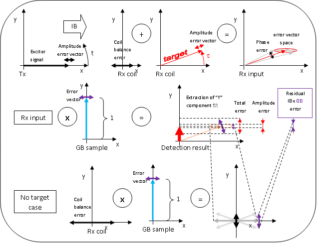

                              I made some drawings that may be amended in case I missed something or if some ideas can be presented more straightforward.
                              First row presents an VLF exciter, IB coil with partially balanced out Tx signal, a target response, and a composite of target + IB reduced Tx signal. Whole shashlik goes into a Rx.
                              Second row shows a concept of coherent multiplication (mixing) of Rx signal with GB normalised signal. As mixing usually happens with analog switches the amplitude is 1. Due to the troubled design of a typical detector, a perfect 90° GB is spoiled by some phase error that is propagated further to other "channels" of a typical discriminating Rx, but I didn't go that far - I was happy with GB. The resulting signal is actually a slowly changing DC whose amplitude is an ideal one, + and - the error. I hope the idea of error contributions are clear enough.
                              A third row shows what happens when there are no real targets and there is an error in induction balance of a Rx coil. Due to the phase error we get some small resultant signal that disables us from going any deeper in weak signal exploration.
                              Conclusions:
                              • if you have a perfect GB you can live with some error in IB
                              • if you have a perfect IB you can live with some error in GB
                              • with unchanged GB phase error and unchanged IB error you can't go any deeper because your dynamic range remains the same - regardless of extra juice you pour into your Tx. This problem is indicated by a vector described as residual IB x GB error.
                              Please note how target angle is related to the target tau
