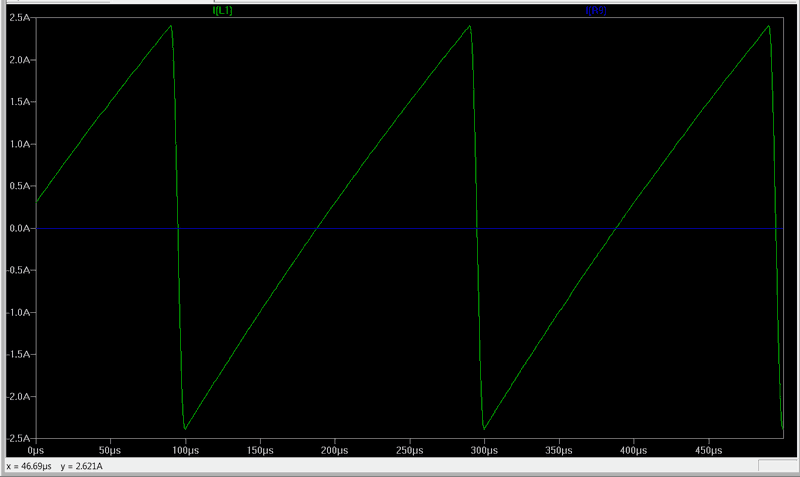

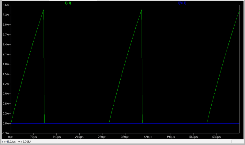

    Bi-polar TX pulses.
    Ok, let's look at the TEM TX pulses in the picture below. About 2.5A positive pulse and then 2.5A negative pulse. I added the blue 0A trace to make it easy to see.
    Compare with monopolar pulses from a traditional PI. The pulses look much the same, but they are only positive. Again the blue trace shows the 0A level.
    Does the TEM TX qualify?

            Bi-polar TX pulses.
            Tinkerer
            It does and it doesn't. It's bipolar but not symmetrical. The positive pulse rises slowly then falls sharply wheres the negative pulse starts with fast rise and finishes slowly. In addition the pulses are not independent ie. starting from a point of zero coil current flow or with a settled target. So it won't be as simple as inverting the negative pulse samples and averaging them with the positive ones. However I tend to think the information is still there it just needs a slightly more complicated method of extraction.

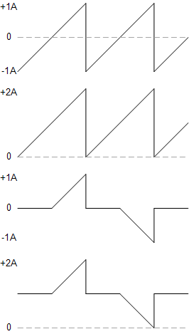

              Not bipolar at all, in the sense of the magnetic field. Below are 4 pulse methods; the top two are not bipolar, the bottom two are. The current min/max values are irrelevant; the top pair of pulses are identical as far as target response goes. Same with the bottom pair of pulses.

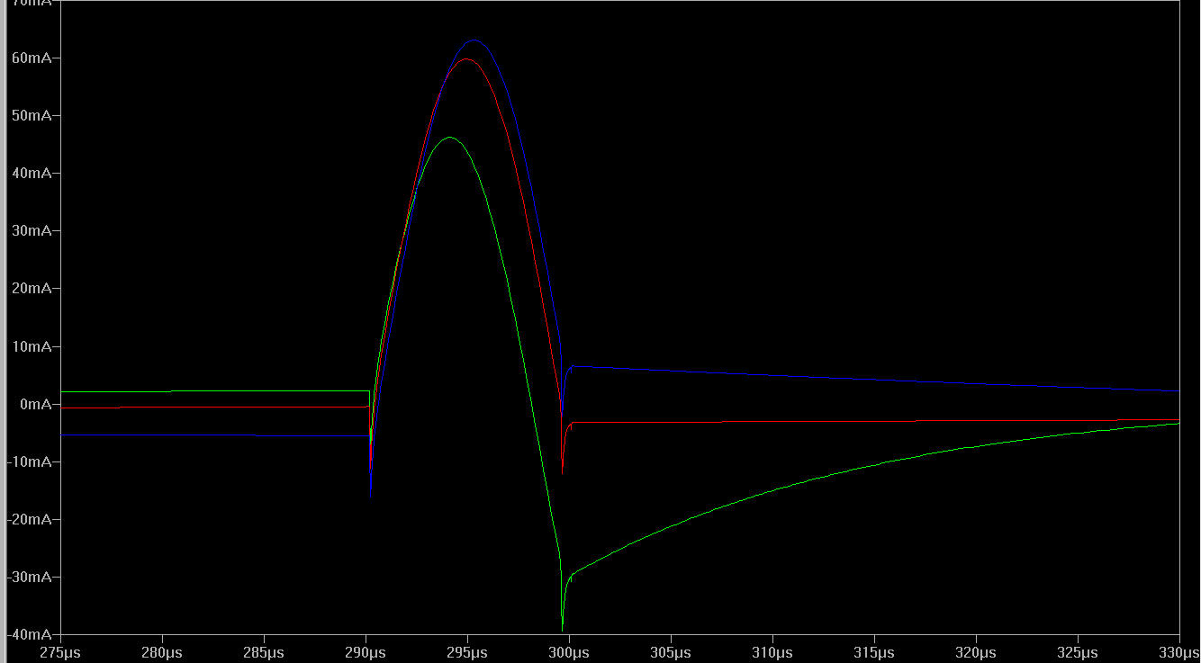

                Target extraction:
                Below is the unfiltered TEM RX signal.
                The red trace is NO TARGET
                The green trace is the GOLD TARGET
                The blue trace is the FERRITE TARGET
                We can observe the variation of target amplitude as well as the phase shift.
                Does the TEM qualify as a PI-VLF hybrid?

                  Target extraction:
                  Tinkerer

                    Bi-polar or not
                    Looking at your drawings, I would agree. A pulse that goes from +V to -V would be monopolar because the current only goes in one direction.
                    However, the strange thing with the TEM method, is that the current in the coil does go in both directions.
                    Or does it not?
                    Am I mistaken?
                    The Flyback capacitor absorbs the Flyback and then sends the current through the coil back to the battery, or in this case the capacitor bank.
                    I added the LTSpice simulation so you can have a closer look at it.
                    Tinkerer
                      Yes, but the current return is not at the same slew rate as the flyback. Ergo trying to match a flyback sample with a recharge sample will give radically different results. You need a positive flyback matched with a negative flyback.
                        Also due to the charging cycle that begins right after pulse, this design has a shifted zero that has to be compensated. True bipolar pulses use no current in pause between them, and that is a beauty of it. Instead they use high voltage charged capacitors to supply the charge.
                        I just love that concept.
                        My exciter goes to that direction but with unipolar pulses. I intend to explore it a bit further.
