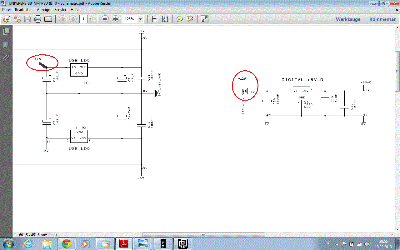

  • The tinkerer_SB PSU&TX side is ready. The pcb is very ugly because of my testboard, but all voltages are correct. There are two confusions on the PSU, so i have made a picture with changes how i have built it. The next step is building the RX-part.
    • Originally posted by mschmahl View Post
      [ATTACH]23283[/ATTACH]
      Thank you for the feedback. Your corrections are correct. I see that you use DESIGNSPARK, so I add the schematic.
      It is good to add a space for a second capacitor parallel to C6, as it makes easy to obtain precise capacitance for the LC tank circuit in case you want to change to a coil with different inductance.
      • Do you have a schematic for DESIGNPARK for RX? Can you share it?
        For the parallel Capacitor to C6 i use Sockets, so we can try different values. For what Inductance is the LC tank made now? 300uH or 350uH?
        I made the changes for TX now(R3 3W 2OHM, Switch, Socket for C1, R1 one side to 0V).
        Thanks a lot tinkerer!
            Do you have a schematic for DESIGNPARK for RX? Can you share it?For the parallel Capacitor to C6 i use Sockets, so we can try different values. For what Inductance is the LC tank made now? 300uH or 350uH?I made the changes for TX now(R3 3W 2OHM, Switch, Socket for C1, R1 one side to 0V).Thanks a lot tinkerer!
            Thank you for the help with the schematics.

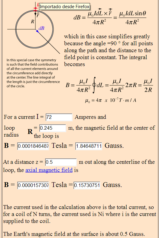

            OK, the purpose of R3 is to slow down the inrush current to the drive capacitor bank.
            For your purpose, small silver coins at 50cm, we want a powerful TX drive. We start with about 1.5A coil current, but we leave the possibility to increase to 3A coil current.
            Since you want to use small batteries, we limit the TX power consumption at about 50mA for 1.5A coil current.
            My hard drive crashed a few days ago. There are some draft schematics left. I send you one of these.
            Warning: this is a work in progress. The schematic may contain errors. I give it as a base to work from.

                Your coil cables are fine. As there are always some differences in wire thickness and bundle thickness, it is good to test the coil when it is ound, so that any differences can be corrected.
                Increasing the TX inductance to about 370uH, reduces the coil current(for the battery) a little but keeps the field strength about the same, because of the increase in the number of turns.
                OK, here is the information for the 50cm coil.
                TX Inner diameter 48cm 18 turns clockwise.
                BU inner diameter 29cm 8 turns counter clockwise.
                RX inner diameter 29cm 11 turns clockwise, center tap, 11 turns clockwise.
                Check out the IB coil thread and see about the balancing and where the pitfalls are.

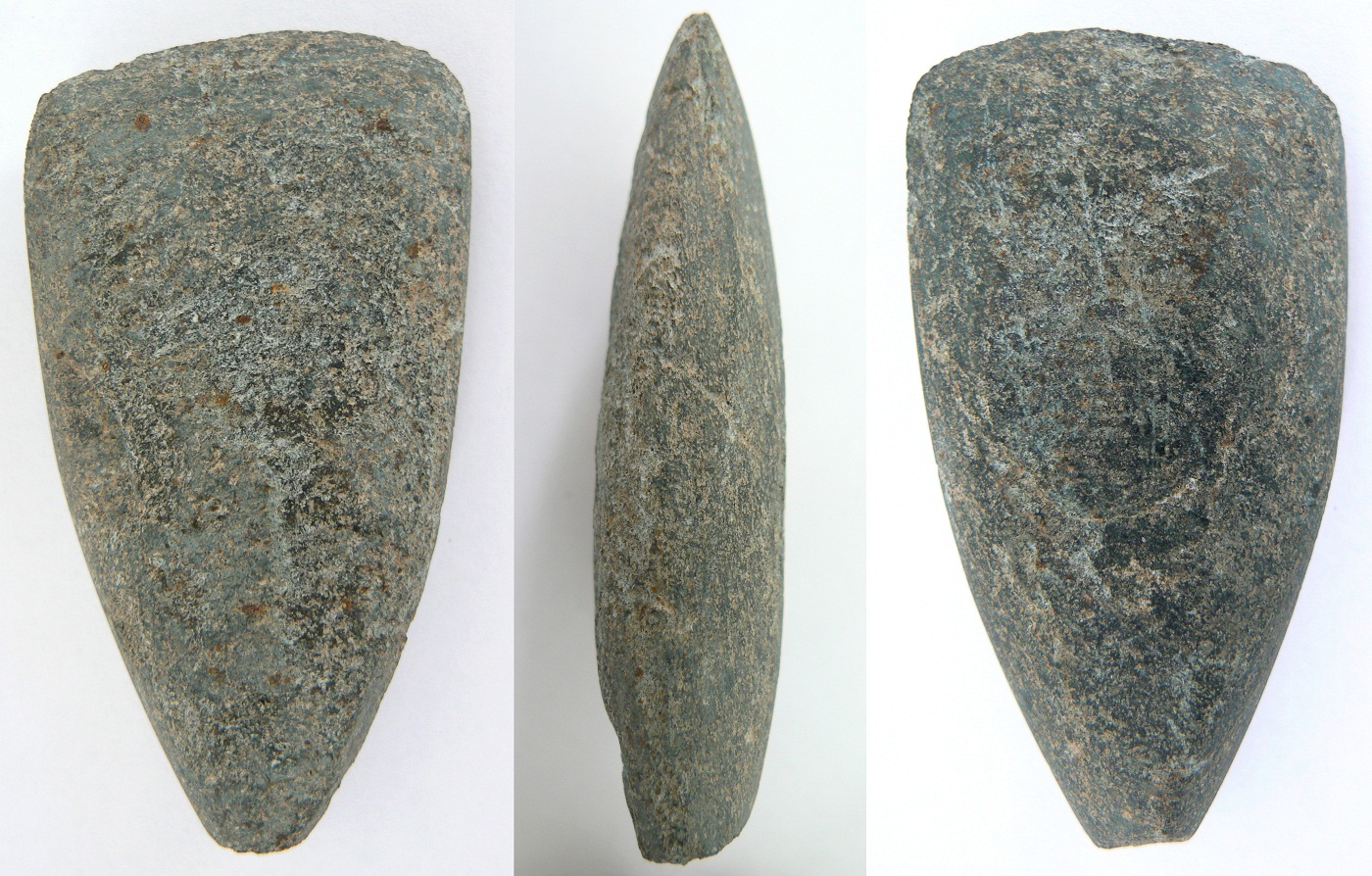

                  The legislation for metal detecting in Saxony is very restricted. I had to make a typ of license to search here. I have to get it each year new and have to be in contact with the archeological institut. The license is limited to a district. But it is ok. My oldest found together with the archeologists was a stony hatchet.Click image for larger version

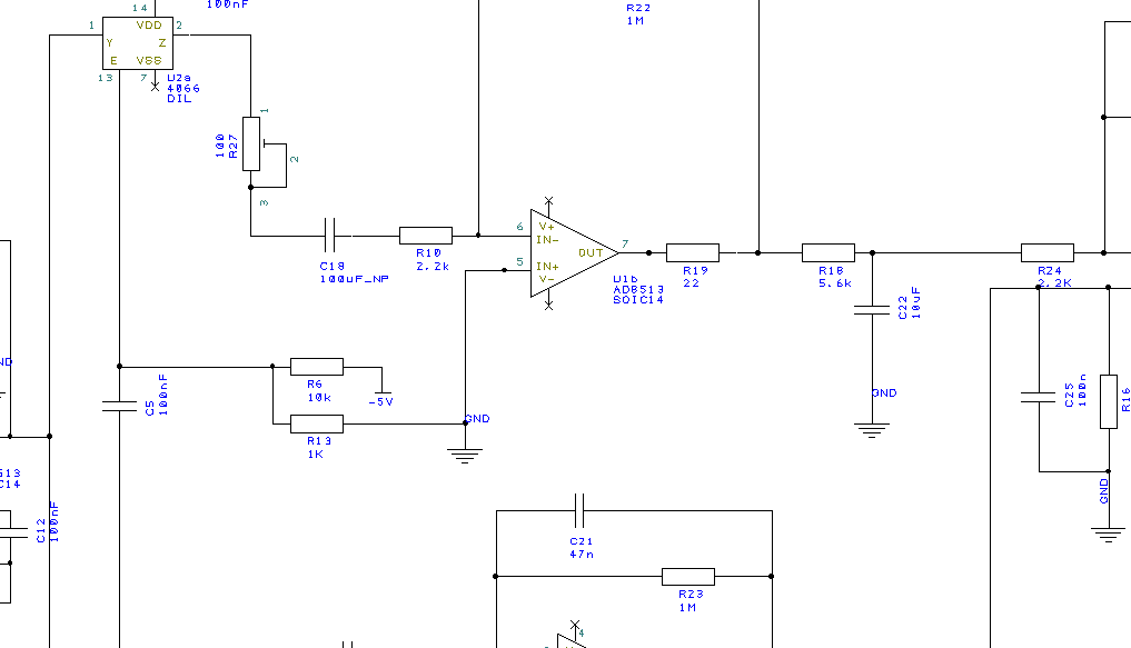

                    • @satdaveuk
                      Sorry i don´t have a pcb layout, only schematics.
                      @tinkerer
                      I have changed the RX Schematic as we have discussed it. Can you look around R6 to -5V, R13 to ground (6V)? I think something is wrong now.
Name:	TINKERERS_SB_MO coreccture.gif
                        @satdaveukSorry i don´t have a pcb layout, only schematics.@tinkererI have changed the RX Schematic as we have discussed it. Can you look around R6 to -5V, R13 to ground (6V)? I think something is wrong now.[ATTACH]23327[/ATTACH]
                        Let's start with R6 on the TX board. The purpose of R6 and R13 is to serve as damping resistors for the BU coil. The connection is between the TX and BU coils, as you mention above. R6 and R13 also serve as bypass for some of the TX current. In this case, some fine induction balance adjustment can be made.
                        While we are at the TX schematic, let's look at the PIC PSU, +5V D. This is referenced to Battery ground with Battery +12 input. If we use a LDO, we can also use Bat 6V input, for lower losses. The pulses from the PIC will now have a voltage of about 5V, referenced to Battery ground. When these pulses get to the RX board, to drive the U2 CD4066, they need to be level shifted. The CD4066 needs CMOS logic, that is LOW=3V HIGH=7V We drive the CD4066 with +/-5V, referenced to Bat_6V GND.
                        C5, 100nF referenced to the voltage divider R6 and R13 should bring the pulse to the desired level. Analog GND is actually 6V, when referenced to Battery ground or 0V.
                        R13=15k, R6=12k should be OK
                        Why is the PIC referenced to Battery ground? The PIC is driving the TC4452 Mosfet driver.
                        The reason I have these mistakes on the schematics, is because I actually use different parts on my test build, but as these are sometimes hard to find or to solder (TSSOT), I changed them on the Simple Basic design to make it simpler and easier to build. Then, sometimes I make a change on the board and forget to change something on the schematic.
                        Sorry. Thank you for your patience.

                        • Ah, like always I forget something.
                          You can change R8 and R16 on the TX&PSU board to 1.5K to increase the pulse voltage range.
