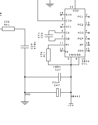

    Thank´s for the explanation. Do i have to change R4 and R39 on RX also?
    @Sido
    I have made some PDF´s to the changes.
    • Thanks mschmahl for posting the updates.
      Some diodes in the RX circuit have a prefix 2Nxxxx. what should they be?
      Cheers Sid

        Yes, R4 and R39 on the RX board should be the same.

          Thanks for the feedback. As you see on this schematic, it is a work in progress. The audio with the 4046 worked, but I was trying to improve on it. This is why we have another audio, using a 555 floating on the page. For the 2 diodes in question I used yellow LED's with a forward voltage drop of about 2.4V.
          It is extremely expensive for me to buy parts here, so I use what is available in the parts box. Not always the most appropriate.
          All the best
          Tinkerer

              • Am I looking at your circuit correctly ?
                the signal comes out of C29 and goes to ground ?
                  Please look at the schematic at the post below.

                  • Hi
                    the penny dropped maybe its a RC filter doh !
                    thats my seniors moment for the week.

                      You are not helping anyone by posting wrong versions of the circuit. this is not the circuit posted at http://www.geotech1.com/forums/showt...947#post155947.

                              • Sorry for my uncomplete update. I have now updated to the reference-PDF Tinkerers_SB_MO - Schematic from here http://www.geotech1.com/forums/showt...947#post155947
                                with all changes, that we have discussed previously. I hope i have not done a mistake.
                                Here are PDF and Schematic for DesignSpark
