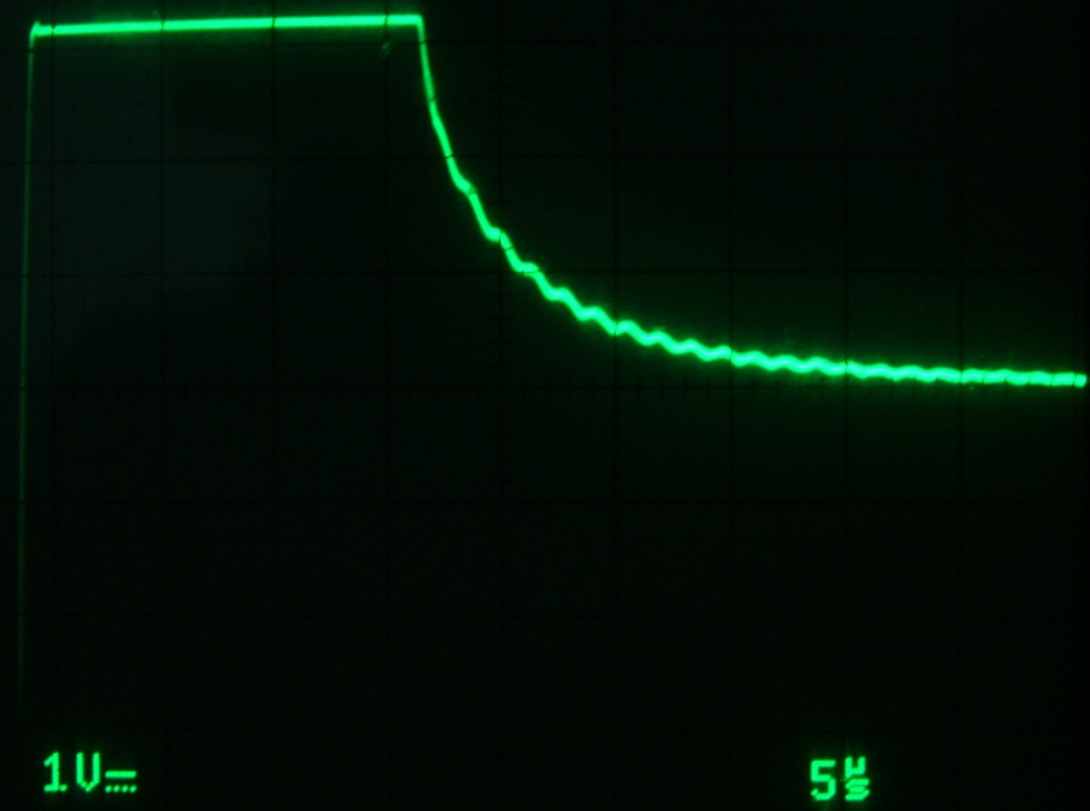

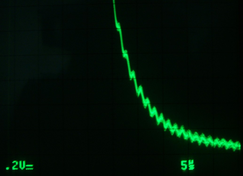

      The pics show the 80mV noise in the decay curve of the bus prototype. Adding filters to diminish it also reduced the usefull signal and therefore sensitivity. The forum members that voted also requested a ready made platform and the one chosen is shaping up well..... you can see for yourself if you care to look at the video.

          • Hi BjBj,
            The decay curve CRO shots are of the old bus prototype using the ATMEL chip. The noise and the difficulty for forum members to make the boards caused it to be defunct.

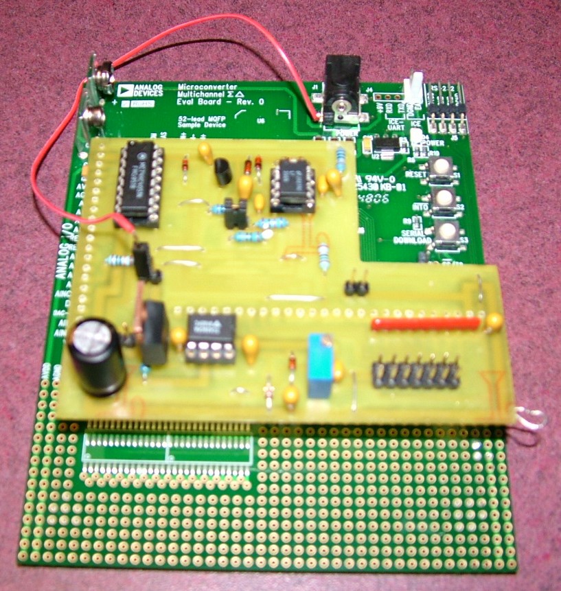

                        • The attached pic shows the UPIM plug in board atop the evaluation board.
                          Bottom right is the LCD display header with the red resistor network pullups just above it and the blue contrast adjustment pot slightly to the left.
                          Top right is the pre-amp and associated components.
                          Top left is the 74HC4051 muliplexer for the caps/AtoD inputs.
                          Bottom left is the MOSFET (IRF740), the mosfet driver and -V generation circuitry. The signal from the micro to "pump" the -V circuitry is disabled during sampling and AtoD conversion to minimise noise. Likewise, no data is sent to the screen during this period.
