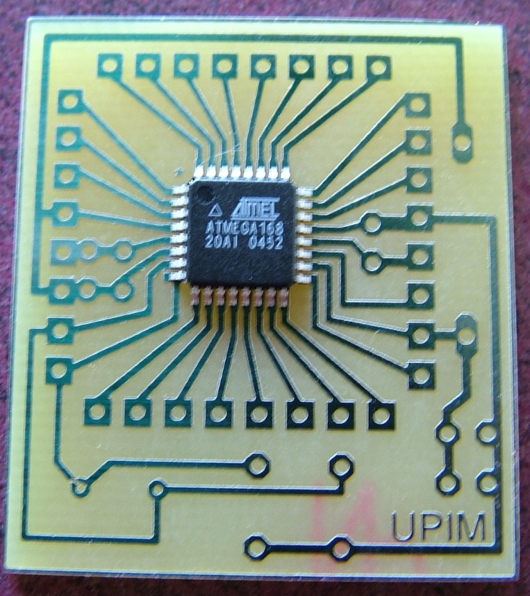

                        Micro SMD to thruhole adaptor board.
                        Attached .pdf shows a 1" * 1" board to adapt the SMD micro to thru hole. The bypass caps for the micro are on it too. Contemplating putting the external XTAL on it also to cut down on radiated noise.
                        bugwhiskers
                          SMD to thru hole
                          The attached pic shows the first prototype board ready for drilling and soldering.
                          The board now includes provision for an external XTAL to enable running the micro at it's full speed 20 MHz.

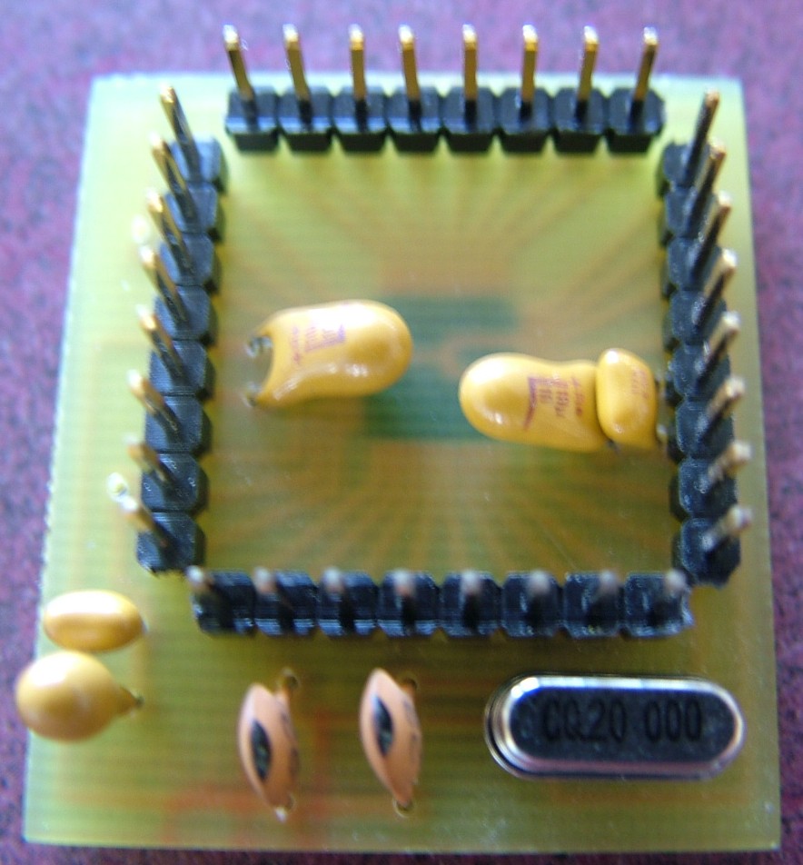

                            SDM adaptor board
                            The attached pic shows the bottom side of the SMD adaptor board. Bypass caps, headers and XTAL components in place.
                            Work on the main board schematic is about half done. Very slow because I have to make the schematic symbols and packages as well because a lot of the parts aren't in the libraries.
