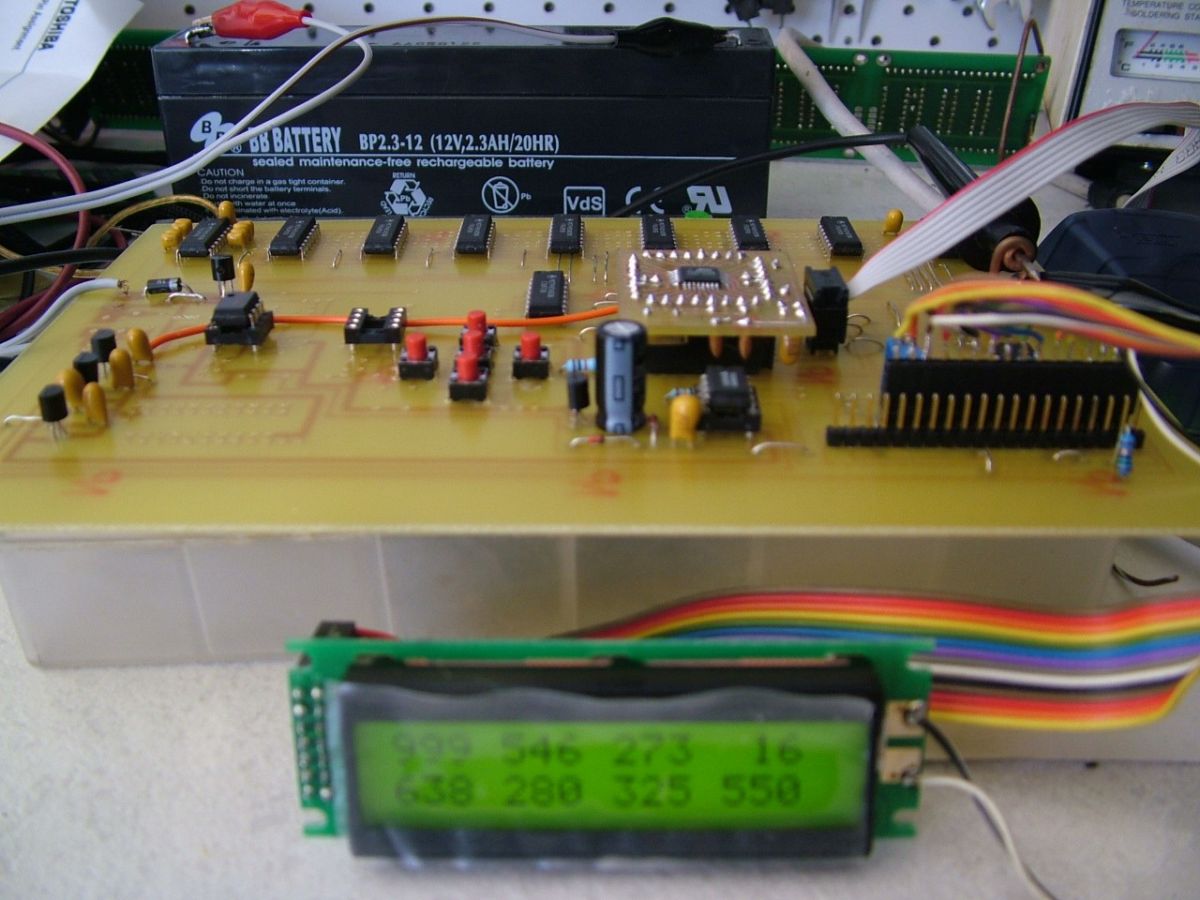

          Display
          The 16 character * 2 line backlit display is up and running. The UPIM daugher board can be seen in the middle of the large PCB.
          I have decided to enlarge the daughter board and incorporate the other SMD device, the "G" sensor on it.
          The numbers are leading zero blanked, ie you don't get 002 for the number 2.

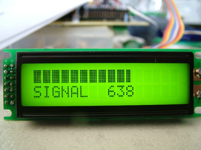

            Bar graph & Joystick
            The bar graph has been programmed in.
            The digital range is 0-1023.
            There are 16 characters * 5 vertical lines giving a range of only 80.
            To give maximum sensitivity to the bar graph it has to have an offset from zero ie adjustable so the left most bar is just visible at the point of threshold.
            The Joystick (or 5 buttons) are now being read, the following table shows the number generated by each button.
            No button=255
            CP(center press)=210
            North=169
            East=126
            West=90
            South=53
            There is approximately 40 between each reading so noise won't give a false reading.

                Hi Johnno,
                The 638 is just a number plonked on the screen to show where the digital signal strength will go. Only N,S,E,W and C(centre)will be recognised.
                Pressing all the buttons at once will generate a very low number.
                To allow for the offset mentioned in an earlier post there will be another adjustable number just to the right of the signal strength. It will allow the user to optimise/centralise the bar graph for maximum sensitivity.
                Things have changed a bit since original conception. There will be 8 user adjustable settings:
                1: Pulse width
                2: Cycle time (time between pulses)
                3: Delay 1 (first sample after pulse)
                4: Width 1 (width of that sample)
                5: Delay 2 (second sample delay after first sample)
                6: Width 2(width of that sample)
                7: Offset (for bar graph)
                8: Low battery voltage (crucial if you are using LI/LiPo batteries)
                There will be 3 screen pages.
                7 and the bar graph are on the first page called Search.
                1 to 6 are on the second page called Adjustment.
                Battery Low Voltage adjustment will be on it's own page with room for more if needed.
                With 8 user adjustable settings requiring 2 bytes each there will be room to store 32 sets of favoured adjustments in the on board 512 byte EEPROM (retained with power off) memory.
