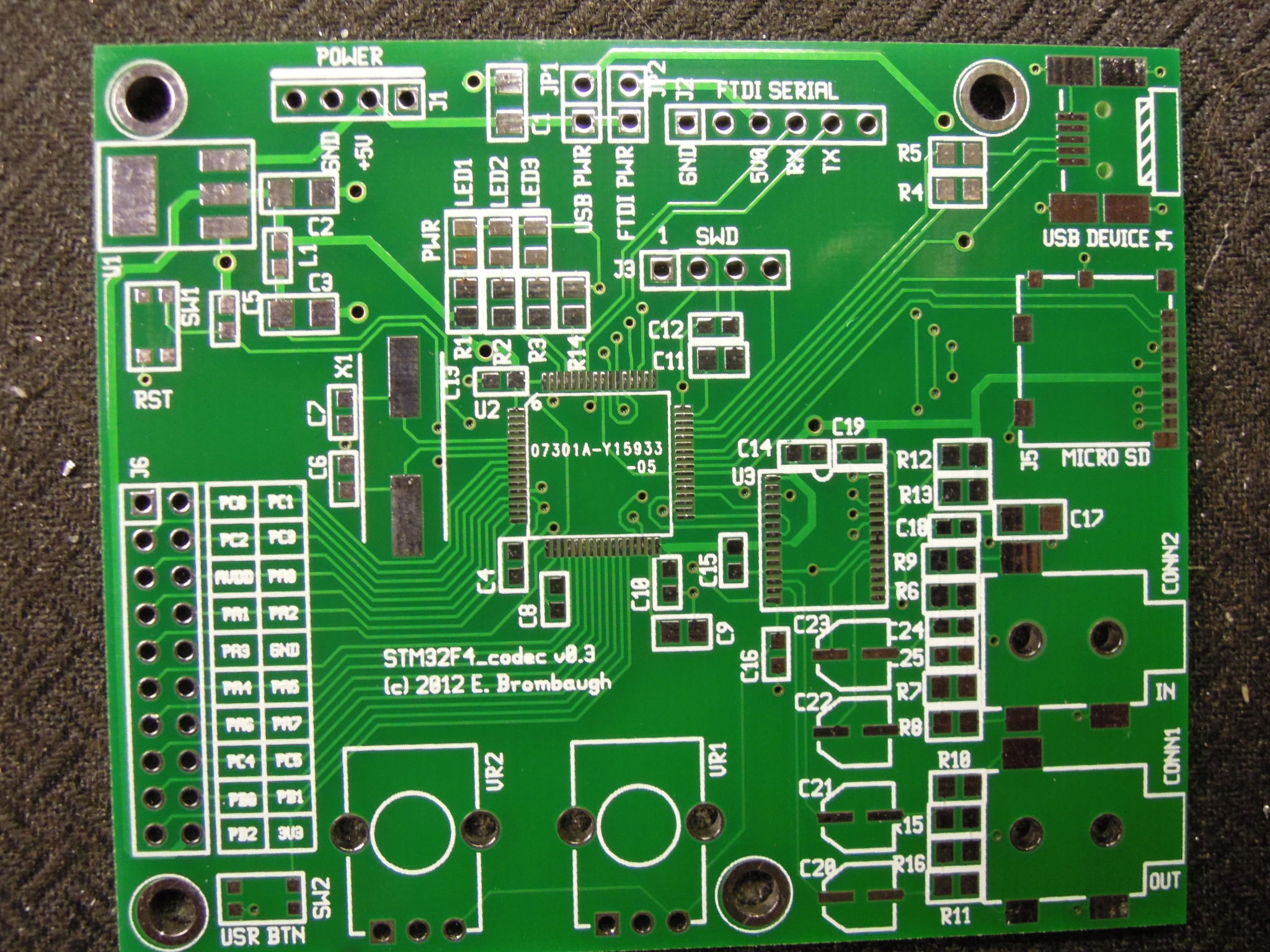

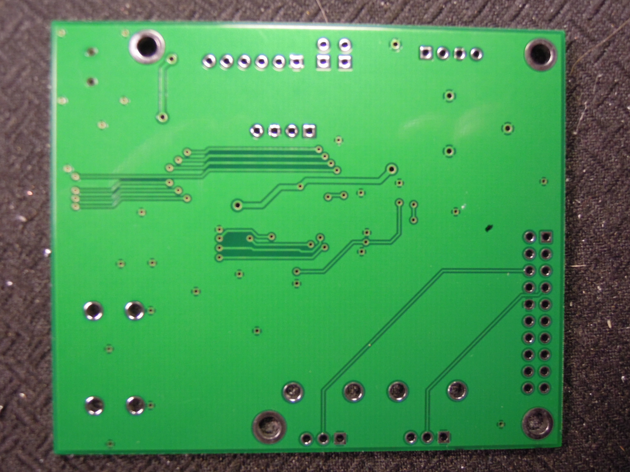

        • Hey guys I got those boards if anyone is interested. The ones from here;
          I had them made from his gerber files so they should be exactly the same.
          Pics
          If anyone wants one PM me. It's $6 for one or $10 for 2. We just started using the F4 at
          work. I have 3 or 4 projects going right now so it might be a bit before I start developing this board.

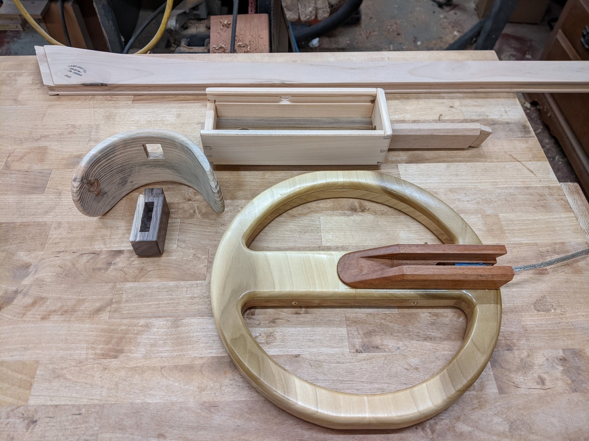

                    • My DIY detector based loosely around this and about three other open source detectors is coming along. I have it mostly built now, need to finish the glue-up then mount the electronics.
                      • Here are the wooden parts of the body:
                        • That's some nice woodworking.
                          • Thanks, it's my hobby. All joinery is mortise and tenon or dovetail, avoiding using metal fasteners (at least outside of the control box) for obvious reasons.
