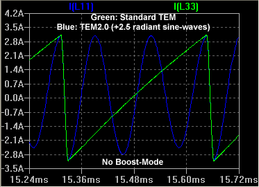

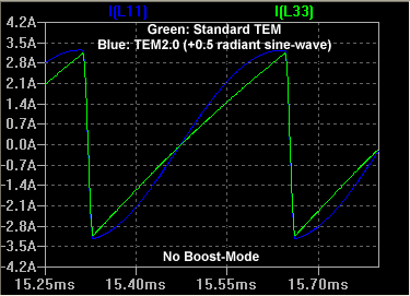

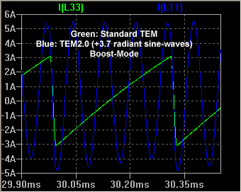

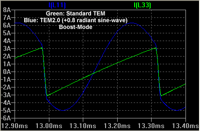

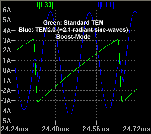

          • Hi all,
            I recommend to start with the standard TEM transmitter and move the big elcos (>1000µF) to the choke input connection and put additionally an unipolar (high voltage) capacitor after the choke output. Change the value of the unipolar high voltage capacitor value (larger than tuning capacitor and much much lower than the big elcos) until you get the following coil currents (see below).
            Have you recognised, that the circuit resonates at two different frequencies? Flyback period (mosfet off) is a half cosine current wave form and the pulse-on period sine waves.
            Number of radiant sine-waves (during mosfet-on):
            0.5, 1.5, 2.5, .., etc: no boost-mode (power efficient)
            0.5-1, 1.5-2, .., etc: boost-mode (for sine and half-cosines)
            1-1.5, 2-2.5, .., etc: boost-mode (for sine waves)
            Now some coil currents:
            After you have understood the principle, you can continue with the CLASS-E TEM version. You get same coil currents. The optional capacitor reduces the mosfet voltage so it should not break-down. ZVS-rule with optional capacitor is important here.
            Cheers,
            Aziz

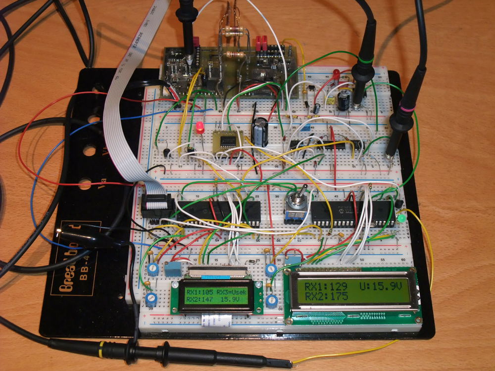

              • Hi Aziz,

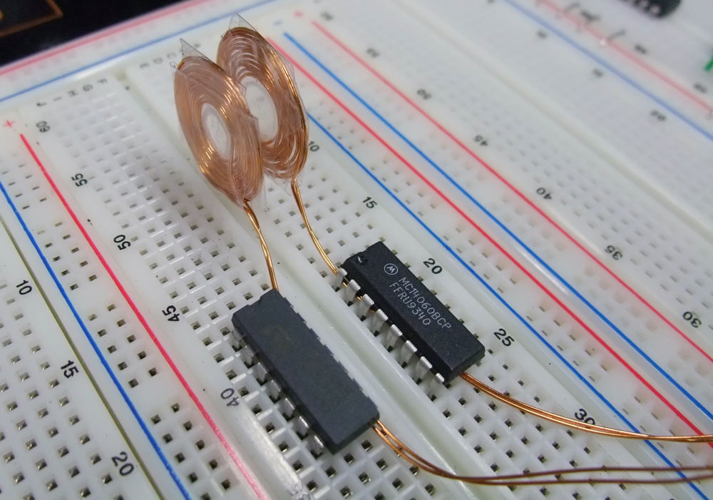

                nice idea to use Class-E The first part of your riddle is not too difficult (post #1640), but I had not enough time yet to try the harder part (and that looks more difficult).
                All this reminds me of some CPT (contactless power transfer) experiments that I did a few years ago. I used a series resonant tank circuit for TX and a parallel tank circuit for RX and was able to transfer a few watts over a distance of a few mm using two small spiral coils. For some more fun, I added a bidirectional data transfer by modulating the TX power and the load of the RX circuit (similar to what RFID tags do). I have to dig up the still existing bread board and the documentation. At least I have a photo of the test setup. There are three 100 Ohms resistors in parallel on the RX side (changing color already ) and the voltage after rectifying is 15.9 volts DC, i.e. 7.7 watts. The coil distance is maybe 5mm.
                And the two coils:
                I already posted a link on CPT in the Round/Square coils thread. Here it is again and some more:

                I hope the links are helpful. Now we need some more time to figure out how to use a Class-E amp for a detector TX …
                Thomas

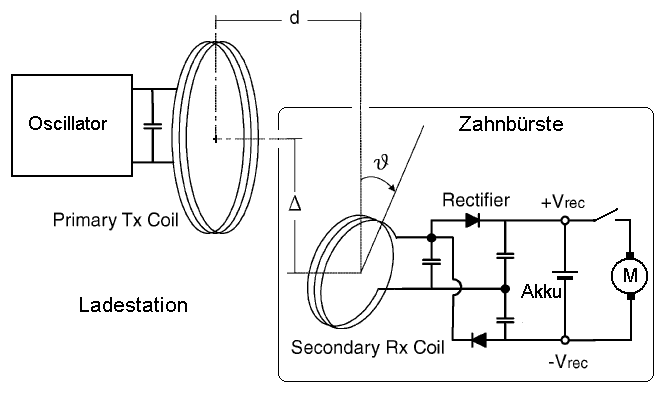

                    • TOOTHBRUSH DESIGN
                      Thomas, I have several toothbrushes containing wireless charged Akku. They are made in China much before papers cited in your post. Their design is made in Germany by TCM team before more than 10 years.
                      What you and Aziz wish to design? Unlike you, I will give other answer:
                      You and Aziz are trying to design an EFFICIENT TRANSMITTER FOR WIDEBAND METAL DETECTOR.
                      But you guys do not use the FREQUENCY DOMAIN - THE MOST POWERFUL TOOL FOR ANALYSIS AND DESIGN.
                      Why?
                      Here is the principle of TCM wireless toothbrush:
                        Why?

                          • Mike, you can’t compare the wireless toothbrush charging with the CPT designs from the links. The CPT designs have much more power because of the poor coil coupling (several cm and more apart) – comparable with the problem that we have to excite a target below our coils.
                            The toothbrush chargers use a split transformer with quite a good coupling, driven by a sine oscillator of a few kHz (round iron core in the charging station plus air coil in the toothbrush that fits around the core).
