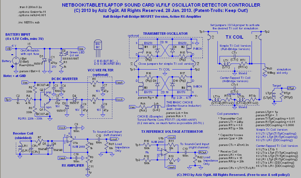

              • The Ultimate(tm) VLF/LF Oscillator Detector Controller Circuit
                Hi all,
                I'm releasing the Ultimate(tm) VLF/LF Oscillator Detector Controller Circuit (and zipped spice files for your convenience). As you can see it below, I have changed the battery polarity (Battery + = GND !!!). The preferred n-mos fets being used for the center-tapped TX coil (low Rdson, more power efficient). Everything is trivial and I have found some spare time to finish it finally. You can implement the "World's Best VLF/LF Detector"(tm) if you want (yes, you can!).
                Here is the final schematics:
                Here is the zipped spice file (LTSpice):
                VLF-OSC-Detector-Controller-2013-02.zip
                Ok, I have finished the VLF/LF Oscillator project and have kept my promise to publish it. It's up to you to code the software part now.
                Have fun.
                Cheers,
                Aziz
                • I would suggest "Really Good VLF/LF Oscillator Detector Controller Circuit" as the name. I doesn't do multifrequency. Or have a boost mode. Or do triangle waves. Or pulse induction. Or truncated half-sine. When you get all that incorporated, then we'll consider "Ultimate."
                    Ok, my bad Carl. Ultimate was meant, that I have finished the VLF/LF journey and it is the final schematics on this topic.
                    But I might give a little add-on option trick to the circuit above to make it multi-frequency capable. It would make the real ultimate option possible then.
                    Cheers,
                    Aziz
                    • It's a nice, fuel-efficient driver; I've been using a similar circuit for the past year. I tend toward bipolar, they run at a lower supply, and I have a 2-F option. I also designed (separately) a multi-waveform TX driver; it is quite the trick to switch between full PI, triangle, and sine wave.

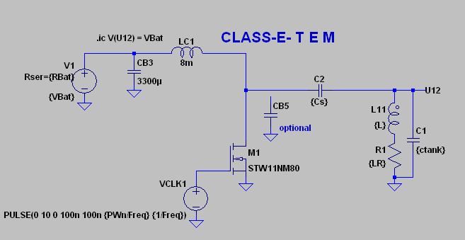

                            Hi all,
                            I think you all deserve the new transmitter. Look at the TEM principles. We are going to make the TEM2.0 transmitter.
                            And look at the Class-E amplifier principles. We are going to make the Class-E-TEM transmitter.
                            And we finally will see, that TEM2.0 and Class-E-TEM are the same thing.
                            I'll publish soon the very trivial "invention". Shame, I wouldn't even call it as "invention".
                            Both transmitters can stimulate large targets more efficiently. It supports boost-mode at the expense of more power consumption. The basic principle is: leave some TX coil energy back and invest it into the next pulse. You can even do without energy recovery and invest all the energy in the coil into the next TX pulse (super-boost).
                            It supports TEM-PI/Hybrid VLF principles too. More oscillating sine-waves will stimulate the targets better. It's a wideband transmitter with the option of increasing the low frequency section.
                            It's so simple: one n-mosfet, one inductor (like in the TEM TX), two tuning capacitors (unipolar, high voltage).
                            By varying the pulse frequency, duty cycle and the capacitors value, one can setup the operating mode.
                            Can you see the forest for the trees? It's a good quiz game. I'll give you some time to figure it out.
                            (I'm sure, it isn't novel. But it is a KISS-masterpiece. Patent-trolls: keep quiet!)
                            Aziz
                            • Basic Schematics for the Quiz-Game.
                              Now try some frequencies, duty cycles and capacitor values. C1, Cs, and the optional capacitor ain't that much. Try for C1, Cs 10-100 times of the tunning capacitor value.
                              The mosfet pulse on duty cycle is defined by the tuning capacitor and the TX coil inductance (like in the original TEM TX).
                              Good luck to you.
                              Aziz
                              PS: {L} being the TX coil inductance. LC1 is a choke. CB3 is a bipolar elco (1000µF - 4700µF)
                              • Teasing only the Patent-Trolls.
                                Hi all,
                                I think you have to chew on this brilliant "invention" a bit longer. I don't want to tease you.
                                I want you:
                                - train you learning by doing & experimenting
                                - train your natural "pattern recognition system" (brain)
                                - train you thinking out of the box
                                You have to make dozens of variations of the parameters I have mentioned earlier to fully understand the design (as I did).
                                I'll tell you the missing link to the latest VLF Oscillator Detector Controller project too, to make it wide-band TX (multi-frequency):
                                Connect a capacitor between Tp1 or Tp2 to V- (V- being the choke connection point or the source of the mosfets). The capacitor value can be 2x - 10x of the value of the CTX.
                                All the magic is made by using the magic choke. Long live the magic choke!
