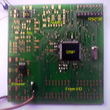

                  • Let's make a PC based metal detector with usb interface!!!
                    WIZARD, NICE LITTLE CIRCUIT BOARD YOU POSTED. WITH THE PROPER PROGRAMING OF THE DSP "PIC-CHIP" CAN YOU ANALYZE ALL SIGNALS FROM THE RECIEVE SEARCH COIL . CAN THE DSP ISOLATE DETECTED TARGETS IN THE NANO-VOLTS FROM WITHIN ANY TYPE OF NOISE OR INTERFERENCE ? BESIDES BEING PROGRAMED FOR CONTROL FUNCTIONS, CAN THE DSP BE PROGRAMED FOR SIGNAL ANALYSIS. MAYBE EVEN TELL YOU IF IT'S INTERNAL PCB CIRCUIT BOARD AMPLIFIER NOISE OR NOISE IN THE GROUND OR SEARCH COIL RELATED MAGNETIC FIELD GARBAGE. IS THE CRYSTAL 20 MHZ TO THE RIGHT OF DSP ?? WILL IT TAKE A LOT OF PROGRAMING. I AM VERY INTERESTED SO THANKS FOR YOUR INFORMATIVE POSTINGS............EUGENE
                    • I worked all the night long. It is interesting, that with higher Q coils, no amplifier for the TX signal is necessary anymore. I can spare the TX amplifier now. TX is driven with ultra small signal level on the sound output (few mW).
                      Now only the capacitors and the SMD pre-amplifier can be placed directly on the coil housing. It's getting more simply.
                      Good night!
                      Aziz
                      • amtech2005,
                        I think - nano Volts (for Metal Detecting) is theory and dreams... in this range the noise is very strong
                        I don't know(now) the sensibility of this board, Analog part is not ready,
                        I waiting some OP-AMPs from shop(SMD NE5534 or AD797AN) and I need to make good coil for test for range 5k-15kHz sine
                        This is experiment board from "sporting malice"...
                        About DSP and Digital detecting - this way will give more functions from analog design and can be best user friendly

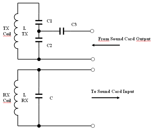

                        • Hi TheWizard,
                          don't be so pessimistic! Just work for a good result. If we wouldn't dream on such goals, we can not go through the barriers.
                          Why you don't make the first software not on the PC? It is fast, cheap and very easy. Later, you can adapt the software to the DSP hardware.
                          Just try this on the PC for a basic coil connection test:
                          L-TX, C1 and C2 are the determining frequency of a Colpitts-type resonator. This is coupled through the capacitor C3. Apply a well defined harmonic to the transmit coil.
                          f = 1/(2*PI*sqrt(LTX*((C1*C2)/(C1+C2))))
                          The receive coil is a parallel resonator. L-RX and C defining the frequency.
                          f = 1/(2*PI*sqrt(LRX*C))
                          Of course, the RX can be amplified before feeding to sound card input. If there is no ampliflier available, one can plug into the microphone input with activated microphone amplification.
                          Just try out and see the result with Lock-in Amp.
                          I am not kidding.
                          Aziz
                          • PS: Don't forget the protection diodes!

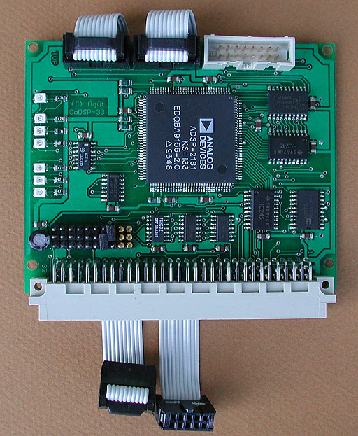

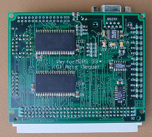

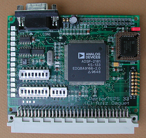

                            • BTW,
                              this is my DSP board (current version has 33 MIPS, I have also a 40 MIPS version). Also having a second DSP board for more calculation power. It was made ca. 10 years ago. But I do not want to use it anymore. Just using a laptop PC.
                              Interesting tip:
                              Use a cheap DSP starter kit having a codec chip (sound chip). This could make thinks easy and fast.
                              Aziz
