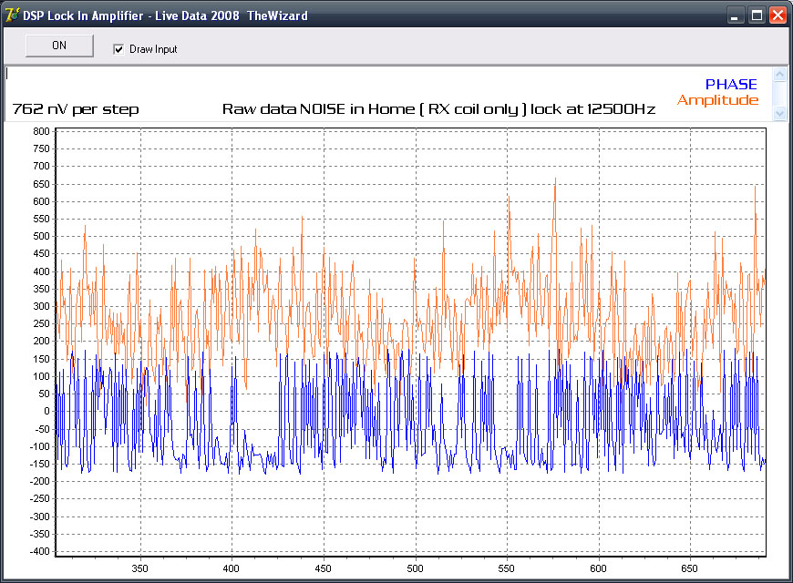

                        I have on my instrumentation amplifier a second op-amp for the reference biasing in order to use in a single supply mode. Maybe the op-amp (OP177) is not the best choice for this. Second: the high input resistance of the amplifier. I have to test some configurations yet.
                        But the NE5534 is working quite well. It has internally lower input resistance. It delivers also quite enough power for driving the coils (some 10 mA). Two of them, one for RX and one for TX would be sufficient for a quite good working and cheap* detector (*without the laptop). I would like to test the AD797. It will probably work much better.
                        It is quite interesting to see the thermal and mechanical drift of the coil and electronics part. But this can be quite easily tamed with the software programming (with moving averages + hysterisis of standard noise deviation + some range). The result will be a stable detector.
                        Aziz
                        PS: Now want to detect 1 Euro coin in 40 cm air.
                        • I can detect now lower than 1/100 degree of phase changes!!!
                          I want to measure the noise of my sound card tomorrow. This is critical and limiting device.
                          Aziz
                                Aziz
                                Such accuracy is totally useless in the real world. There are so many other factors, which affect the phase-shift returned from buried objects, that the ability to discriminate to even 1 degree accuracy is unrealistic.
