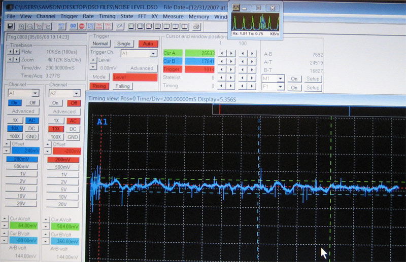

    Attached is a noisy output signal. This is the noise level on the signal without the presence of a target.
    The total time shown is about 5.35 seconds.
    The noise level about 150mV.
    With this noise level, the threshold would have to be set at about 160mV, that means that any target signal below 160mV would be totally ignored.
    What would be the best way to filter this signal?

    • Low-Pass?
      First you need to know SampleRate, Fstop and Fpass.
      Best way is FIR filter....
      If you have not CPU speed or DSP core, try some averages filters
      or Analog Filter after integrators(if is PI MD)

          Tinkerer
          Very simple answer: Using the lock-in amplifier.
          It does a very narrow band filter and ignoring the noise on other frequencies. This is the reason why I am saying, that nV to µV signals can be detected.
          Aziz

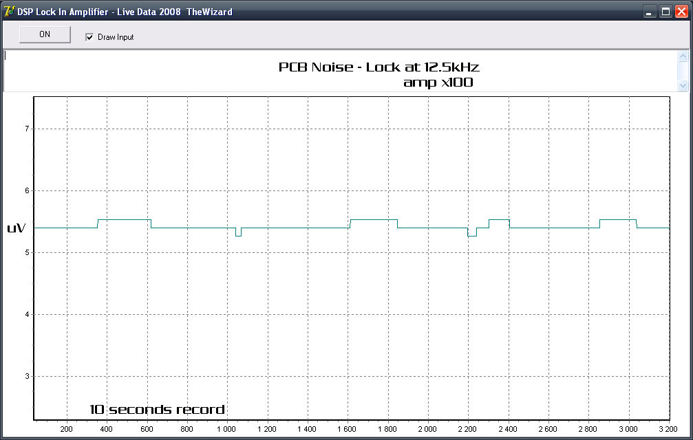

            • Aziz,
              your soudcard noise maybe is ~1549nV for bandwidth 96kHz.....
              and this is without pre amplification....
              • Originally posted by TheWizard View Post
                Aziz,
                I am not focusing on the full bandwidth. No, I am just measuring the noise at the lock-in frequency (max. 24 kHz) at the full internal line-in amplification. This is what counts.
                There is lots of more noise between 0 .. 1000 Hz. I can see the cross-talk of the DC-DC converter in the PC. On this frequency + multiple harmonics, the noise is higher and should not be used for MD. Anyway, on the frequency spectrum there are lots of frequencies for operation.
                It is interesting to see also the cross-talk signal from the sound card output to short circuited line-input. So I can measure the cross-talk level and the noise. Also the DC-offset and noise of the internal sound card A/D converter.
                So there is more accuracy when the sound card is quite good. There are some very good sound cards available today. At least as a PCMCIA, PCI-express cards or USB sticks. For a stand-alone project, look for some convenient codec chips. In the last years, they made big steps towards low noise and accuracy.
                BTW TheWizard,

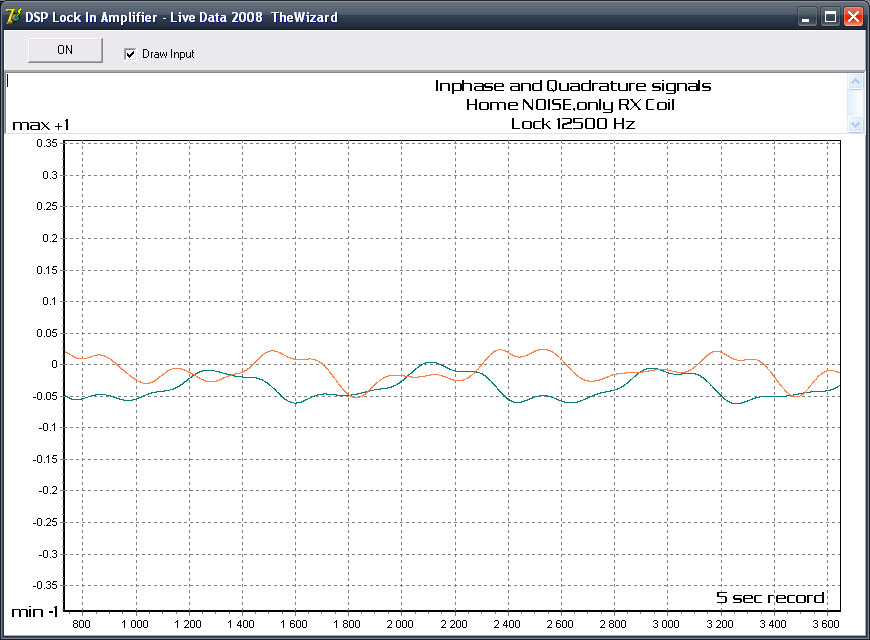

                look to your lock-in output (R and P output). It doesn't looks good. Please check your code. Your low-pass filter has a big cut-off frequency. Increase your time constant. I have more stable results.
                Aziz
                • Last my pictures - RE and IM is raw data from demodulator without any filters...
                  now is filtered....

                      Tinkerer
                      Sorry about the confusion. This is basically the DC output after amplification x 56,000.
                      The signal, without a target, from the RX coil was pre-amplified with a gain of 560, sampled, the samples averaged then run through the difference amplifier and then amplified x100.
                      Now I would like to filter and amplify x 100 again, then feed the VCO.
                      Tinkerer

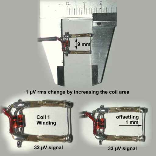

                        • Interesting lock-in amplifier experiment:
                          Measurement on line-input (no external amplification) with a line-output driven TX coil (83 turns, ca. 20 cm diameter).
                          A very small coil with one winding is placed on the center of the TX coil.
                          The signal is measured on 24 kHz (32 µV). The coil is then made 1 mm larger. The signal increases by 1 µV to 33 µV rms. Within the range of noise roughly ± 0.2 µV. The measured voltage is the mean value of some time constant (ca. 200 ms). The bigger the time constant, the better the accuracy.
                          This is showing the possibility of using lock-in amplifier.
                          Aziz
