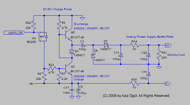

        • Hi all,
          I had to search for a better totem-pole driver and I have revised the discrete DC/DC converter (synchronized charge pump). Now the dead-time (battery short circuited state between switching transitions) is kept low and the efficiency is higher. It uses two same NPN transistors in the driver stage and has lower matching demands (not complementary BJT needed anymore).
          It delivers now more current and higher voltages. Probably I could increase the +5V analog power supply few volts. It depends on the total current draw of the positive power supply. The new charge pump generates lower ripple noises.
          It delivers from a 12 V battery supply a current of 42 mA at 8.5 V. See the schematics below for details.

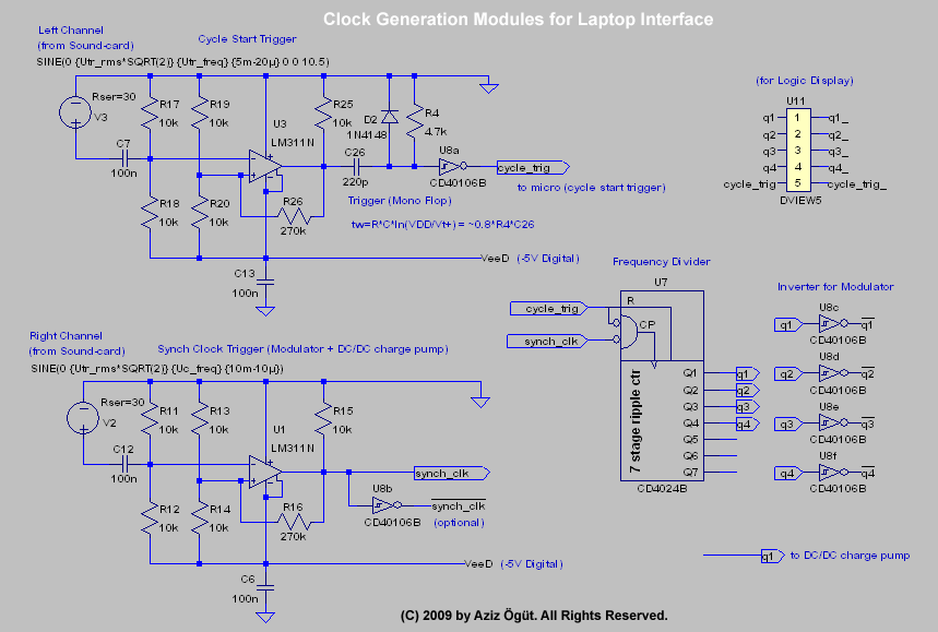

              • Hi all,
                I will go on with the below clock generation modules coming days. The schematics is already simulated and tested with LTSpice. Both channels can be operated individually. Right channel is for the modulator and DC/DC charge pump. So the right channel could run first to drive the DC/DC charge pump and to build up the +5V analog power supply. Left channel is for triggering the cycle start and synchronizes the clockings of the modulator stage on every cycle. The modulator is not shown yet. Minor changes could happen.
                Aziz
                • Hello friends,
                  I have built the synchronisation clock generator and it is working quite well. Thanks to LTspice, which made the extensive prior testing and implementation possible. No significant clock jitter is happening. The lock-in amplifier is working with the synch module absolute stable and I can start with the channel modulator part soon.
                  The extracted synch clock is superiour (~50% duty cycle), which can directly drive the DC/DC charge pump without beeing divided by 2 (q1). I will probably lower the modulator frequency by a factor of 2 or 4 to achieve more resolution. The modulated channel information is distributed in the multiple harmonics of modulation frequency and I can therefore sample this from the ADC (with lock-in amplifier up to 12 kHz and with FFT up to 48 kHz).
                  This will help not loosing much bits of the ADC resolution due to modulation. The 24-bit PI is getting more realistic.
                  Now focusing to the DC/DC charge pump. I have now the clock signal for it.
                  Aziz
                  • Hi all,
                    the DC/DC charge pump is running. The practical results showing exactly same behaviour of the simulated results. It can deliver at least +50 mA and is more than I need. It will be clocked with the inverted synch clock (buffered through the inverter). I blew up a 100 µF capacitor (ouch! wrong polarity ).
                    The power budget at the moment:
                    - Voltage regulators: -5V, -9V, +5V
                    - DC/DC charge pump
                    - synchronisation module (without channel modulator)
                    Total: ~25 mA at 12 V battery supply.
                    Considering to change the -9V to a -5V. I do not need such a high voltage rail. The sound-card interface needs only up to 1 Vrms and the +5V/-5V supply rail is just enough. Two same voltage regulators are easier to handle and to get.

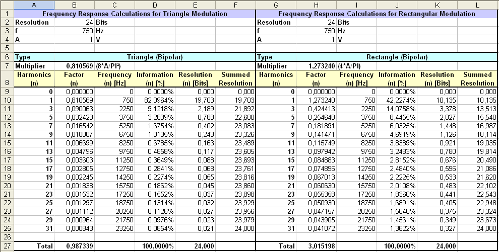

                      • Hi all,
                        a small bug in the frequency response of the triangular wave form is there:
                        It should be:
                        f(t) = (8A/PI²)*(cos(wt) + (1/3²)*cos(3wt) + (1/5²)*cos(5wt) + ..)
                        Sorry for this.
                        Now see the benefit of the triangular modulation shown in the picture below. Whereas the bipolar rectangular modulation contains in the first harmonics only 10.1 bits of 24 bit resolution of the information, the bipolar triangular modulation achieves with the same amount of harmonics 19.7 bits.
                        Taking four harmonics would achieve a resolution of 23 bits of 24 (triangular). The other modulation would achieve only 17 bits. The calculation is made upto 31 harmonics. Of course, the response is an infinite response. The table below gives just a good comparison.
                        Lower frequency modulations allow a better decoding (more resolution) due to more harmonics up to nyquist frequency (96 kHz/2 = 48 kHz). So the first (early) sample will be coded with lowest modulation frequency fsynch/16. The last sample will be coded with frequency fsynch/2 (containing anyway not much signal information besides lots of noise).
                        Effectively, there is a potential for 22-23 bits for decoding. Some bits for noise are reserved. So there is at least 18-20 bits of information for detection left. With some good sound-cards, we can achieve 22 bits perhaps.
                        Aziz
